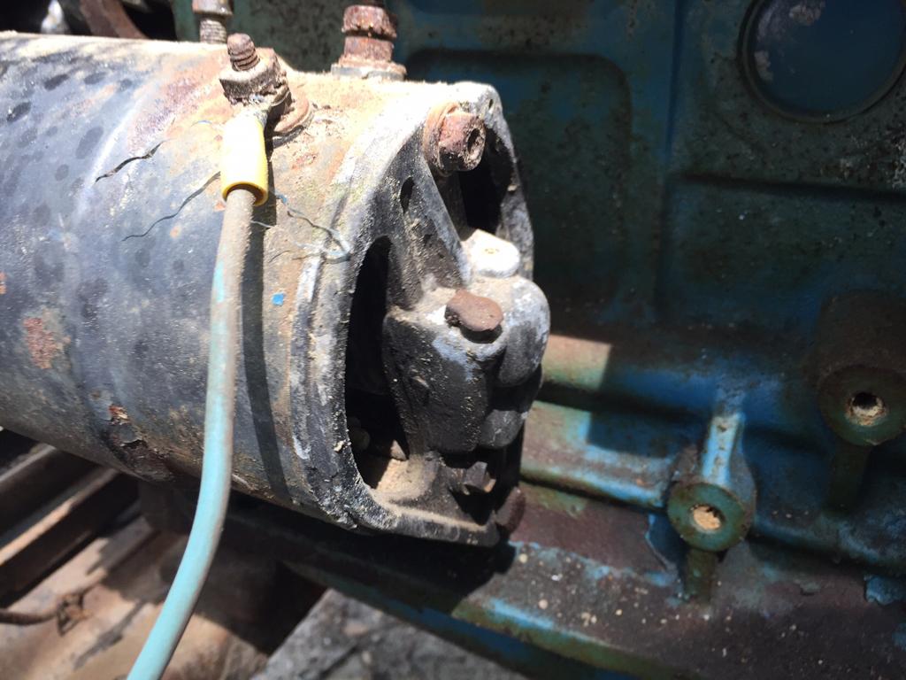

    I took a break messing with bicycles today to dig a little deeper into the truck engine.
    Plugs came out without a fight.
    Disty is pretty clean, I removed the cap to get the mud dobber nests out of each port.
    Can’t read the writing on the starter and can’t find any writing on the generator to confirm 12volts
    [​IMG][​IMG][​IMG]
    Carburetor looks pretty clean, choke moves but throttle seems to be stuck, pretty sure it’s a linkage/pedal issue.
    Anyone know what this orange tag on the carb is for?
    Valve /rocker cover off.
    Yummy. Started turning the fan and made maybe a single rotation, it gets a little tight, but I guess that can be expected. I sprayed PB Blaster on everything and in the spark plug holes to encourage some movement later.
    Then it started raining.
    Okie Pete and brEad like this.

    I pulled the starter today and now I know why it is foot operated. Since this truck has a newer 235 but the original transmission I’m wondering if this is an original starter?
    If this is the original starter and it’s 6v and possibly reverse polarity, can I run it on 12v negative ground?

  11. From what I understand you can run the 6v starter with 12 volts. That is what I am doing with mine, and I am going on 3 years with no problems. It may actually give you more cranking power.
    My truck also has a 235 (numbers show it as a 56-62 year engine) that had already replaced the original 216 when I acquired it.
    SS327 and yoothgeye like this.
  12. Cosmo49
    Joined: Jan 15, 2007
    Posts: 1,555
    Cosmo49
    Yes you can run twelve volts to that six volt starter, 15 years a daily driver only vehicle with that combination.

    With the DELCO starters and generators, a BLACK label is 6 volts, a RED label is 12 volts.
