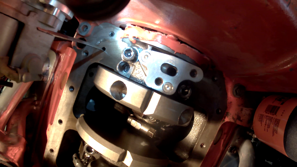

    I'm coming to the end of building a 1965 Dodge D100 with a 331 hemi in it. I fired it up for the first time
    - I have a temporary mechanical oil pressure gauge installed under the hood so I can monitor during tuning etc.
    - All of a sudden the oil pressure dropped to 0 psi ... (not a slow decline)
    - Obviously I turned it off immediately and went into research mode
    The engine has the 340 pump but I dont know about the shaft. (I took this build over from my father when he got sick to finish it for him .... and he passed away recently)
    I have the distributor a LITTLE bit loose to set the timing. Is it possible it has raised up just enough to disconnect from the drive gear?
    Do you have more information?
    Thanks so much!!!

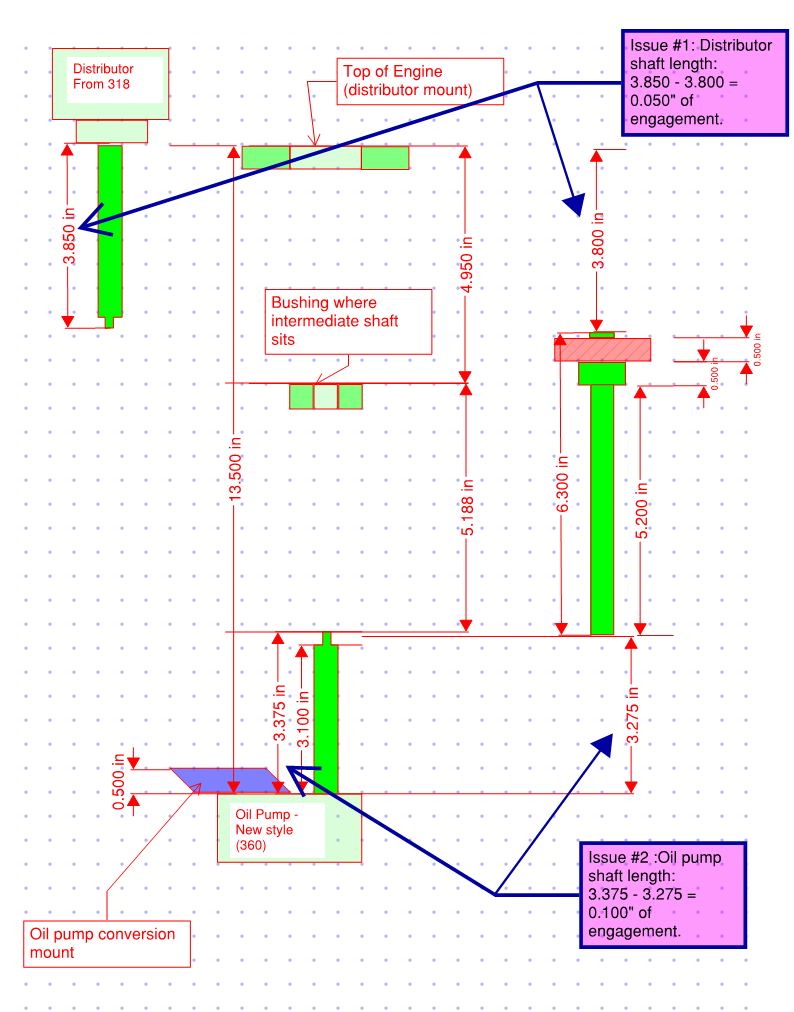

    So heres a sketch of my set up .... I have contacted HotHeads and this is the reply:
    Luke,
    I don't have a 331 or 354 block here to I can measure but I measured the lengths of the int. shaft and the oil pump shaft and distributor shafts and they all show to be correct. I have a longer shaft that we use for our chevy distributor adaptor that I can send you that is longer than stock( 7.060 length) and you can use it to make a custom length shaft and cut it down to match your engine and re pin it. Like we discussed before factory engagement was around .120-.130 on either side but you can go deeper if you want. We have seen some industrial versions that needed this done before but not car engines.
    Thanks,
    Eric
    Can anyone confirm the dimensions?
    Also does this plan make sense:
    1) Press the intermediate shaft up slightly to fully engage the distributor (redrill the set pin) (I think this is going to be easier than cutting and extending the distributor shaft
    2) Press the oil pump shaft to fully engage the intermediate shaft (This means the end of the shaft will NOT be flush with the bottom of the oil pump drive gear .... but I dont see that being a problem.
    I'm scratching my head why I have to do this though!!!! I measured up the old oil pump and it would have the same problem ....
    And I dont agree with what Eric said about the 0.100 engagement being enough .... that seems like a recipe for disaster
  18. Luke; Did you find the actual cause for your Oil Pressure to drop to zero before deciding to dive into pump drive and sub pieces?
    LukesMotorShop likes this.

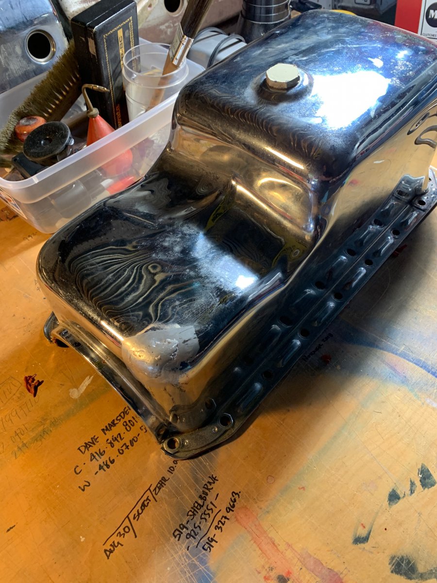

    I run HH hi volume pumps in my dodge and Chrysler... pan mods are needed.. will not fit as stock pan.
    As for the pumps.. they really deliver...solid.

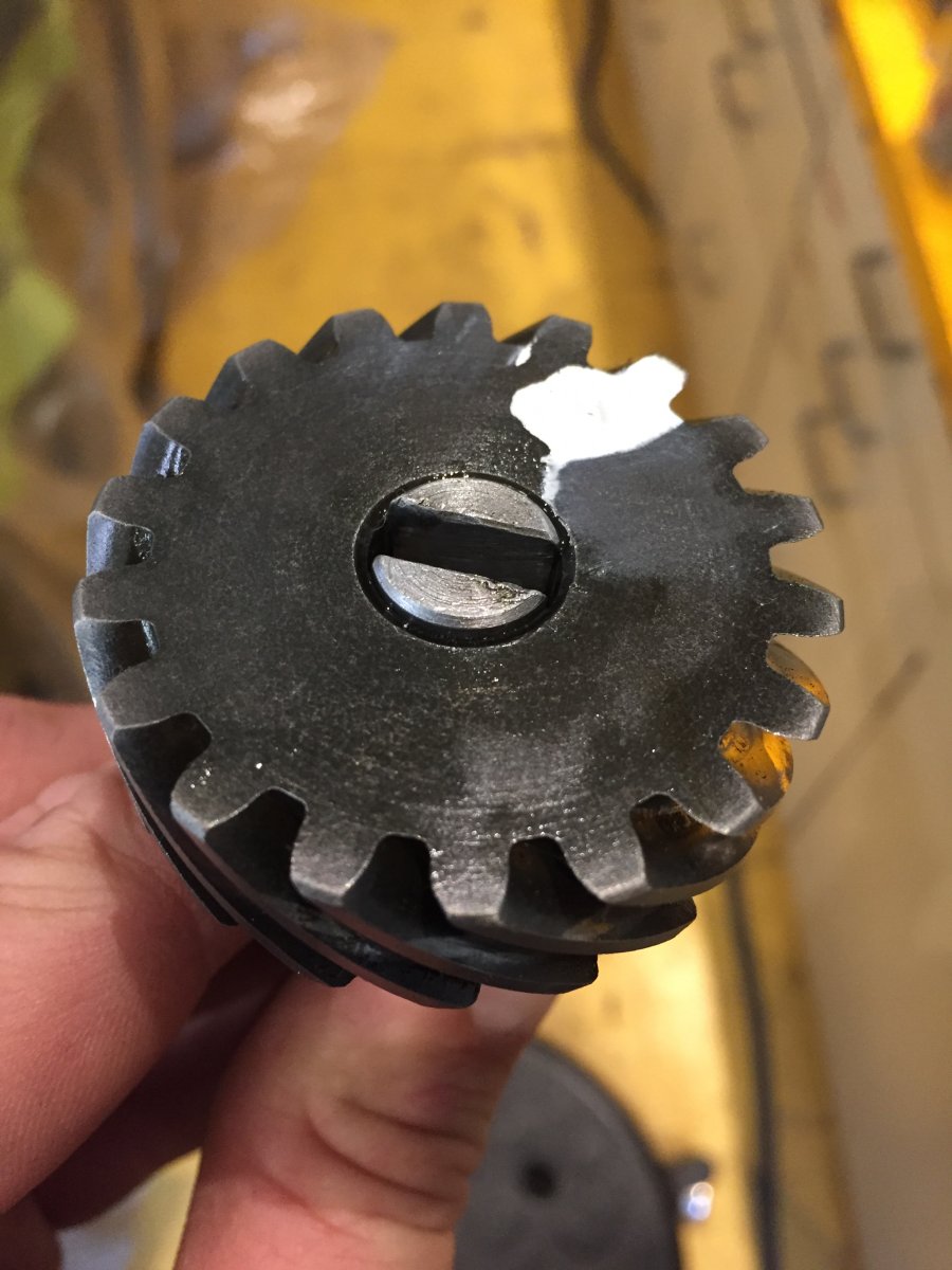

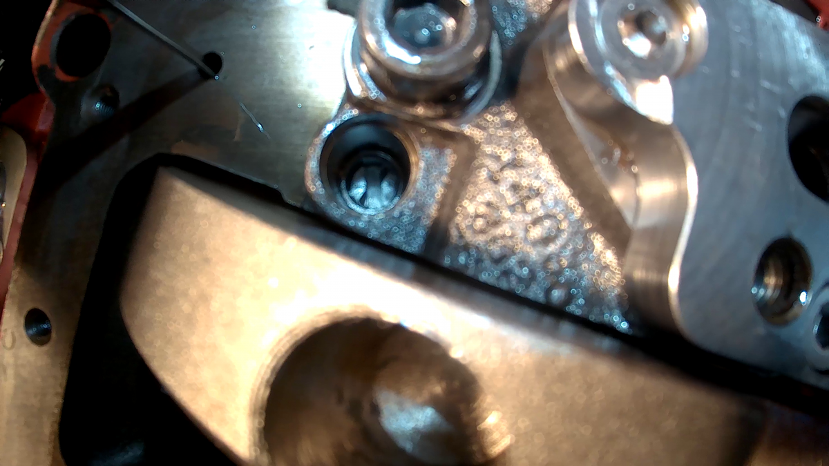

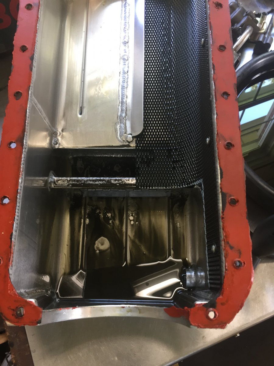

    Yes, Check out the pics attached here ... you can see up into the hole where the oil pump and intermediate shaft "tore up" (sorry about how grainy they are ... snap shot of a video)
    Also had a lot of metal in the oil pan (I think from the bottom of the intermediate shaft) .... could also be the engine breaking in.
    Even the pics of the top of the int shaft (gear side) I can see some wear .... looks like its going to skip or let go ...
    When it was running (before i lost oil pressure) I was having a VERY hard time keeping it running and doing the initial tune ... so its possible the distributor was skipping already?
    It just seems like 0.050" to 0.100" is not enough to drive an oil pump. it takes a lot of force to develop 60-80psi vlcsnap-2019-09-19-12h53m40s101.png vlcsnap-2019-09-19-12h54m15s605.png vlcsnap-2019-09-19-12h55m22s789.png vlcsnap-2019-09-19-12h55m35s429.png IMG_0886.JPG IMG_1033.JPG IMG_1041.JPG IMG_1042.JPG
    Yes - I have the Steph's rear sump oil pan and the right pump arm (see pics)

  21. I have to agree with .050-.100 is questionable engagement. Seeing your photos is pretty convincing. With metal frag in the pan did you open up your Pump to make sure a frag didn't get in and jamb the gears?

    I did open the oil pump. everything seems ok (no scoring etc)
    and I will be replacing the bolts (grade 8) and using red locktite when i re-install ... (I know some had issues with bolts on this form)
  23. Shouldn’t the male tang on the pump engage the female end on the intermediate shaft.
    Looks like the oil pump spacer may be too thick and not letting the tang engage deep enough?
    I can’t tell very well from the pics,,,sorry.
    Just an idea.
    Tommy

    The pump I used wrecked a fresh done pan... Hemi pans in good shape are worth gold....Dodge ones are worth even more.... after all the hard work of metal finishing a decent one and the expense of plating.... the 340 pump pressed right through the pan upon assembly....... this was 2 nights before Detroit(mad thrash as per usual).... Luckily .... I had a somewhat decent pan and used a stock pan.
    When i bought the 340 oiler...I was told it was a direct fit.... nothing needed ....
    I was pissed.

    Yes sir.. EXACTLY ... based on my measuring the male oil pump only engages the female intermediate shaft by 0.100" ....... I might investigate grinding down the 340 oil pump spacer ... but i dont have a surface grinder and i think it would be easier to push the intermediate shaft down .... instead of "moving the oil pump up by grinding the HotHeads provided spacer.
    Its killing me .... i REALLY hope the bit of time it was runnin with out oil pressure didnt screw this engine. things ain't cheap to rebuild!!!!
    Heard that bruh .... I have measured where the pick up sits in the pan ... and made sure it wasnt dead locked in the bottom.....
    I will be "drill spinnin' the pump" with oil in the pan to see if it makes pressure once i finish all the mods I'm planning on....
    BUT again ... I dont know why i need to do it.
    1) push the intermediate shaft UP to engage the distributor fully
    2) push the oil pump drive shaft UP to fully engage the intermediate shaft
    Jeff Norwell likes this.
  27. Do you still have the original pump to measure how far down the pump extends into the main cap?
    Or at least to compare it to the 340 pump?
    There must be more tang engagement than what you currently have,,,it will never stay together with what it is now.
    As far as any damage might be,,,,for my peace of mind,,,,I would remove each rod cap one at a time,,,and give the bearing an inspection look.
    Then ,,,do the same to the mains.
    If it only ran a few seconds,,you should be fine.
    I am assuming you used good assembly lube?
    Hope it works out for you!
    Tommy

    I did measure the original Oil Pump:
    from pump base (mounting point) to tip of pump = 2.910"
    soooo since the spacer = 0.500"
    2.910" + 0.500" = 3.410"
    The measurement on the 340 conversion = 3.375" (see the drawing i did above)
    3.410" - 3.375" = 0.035"
    which is basically Sweet F*ck All ... and might as well be an error in measurement on my part being under the truck trying to measure with a caliper and a straight edge etc.
    the way i see it is the original pump and the 340 pump have the same dimensions.
