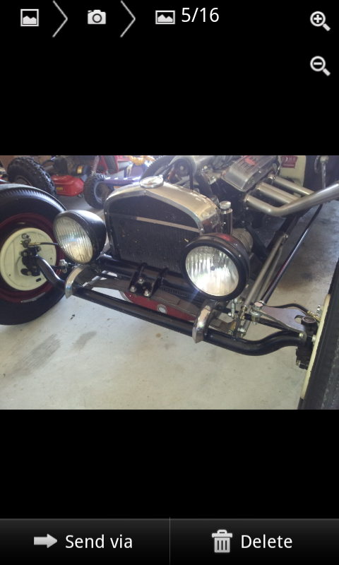

    Yeah mine are spindles & brakes. Not the best pics I know.

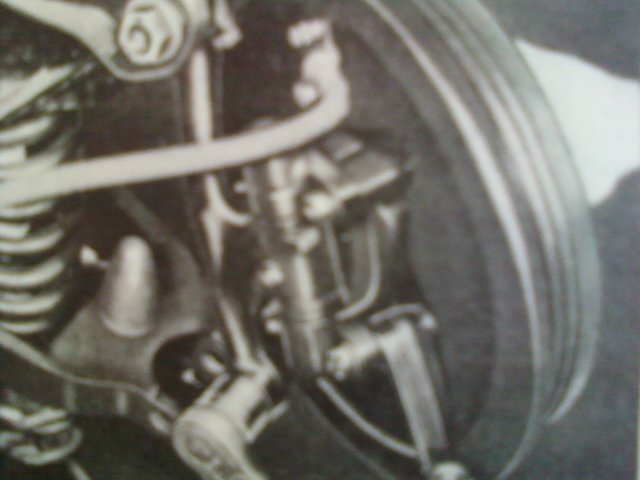

  23. Here is a crappy picture showing the top spacer which is a formed piece of metal.
    The steering arm is between the spindle the backing plate and acts as the lower spacer.

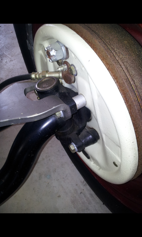

    Here are a couple pics of mine with the spacers, they measure 3/4"
