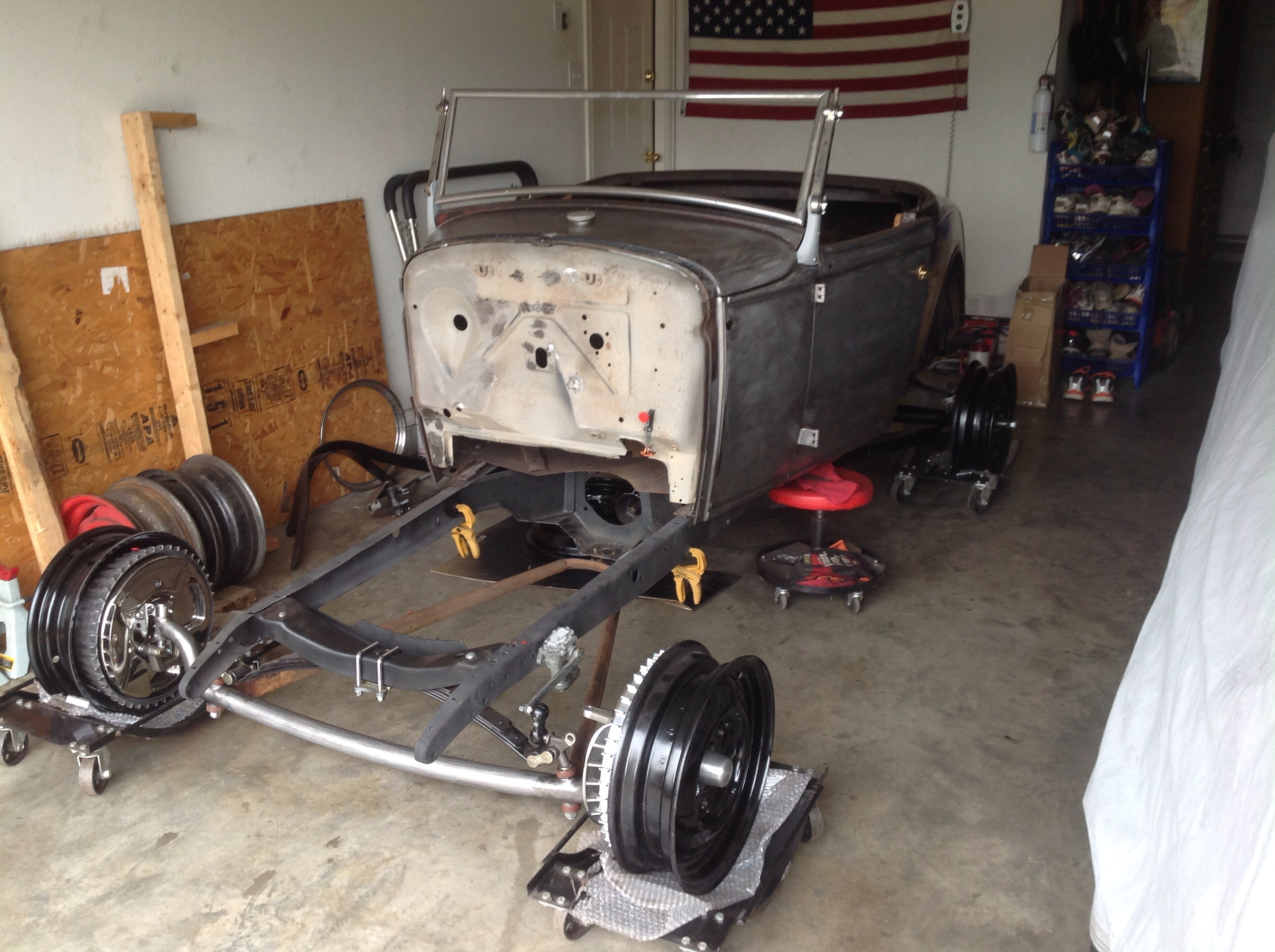

  3. image.jpg image.jpg So it it alright to ask an opinion about a dropped axle?
    For my 31 Roadster I have a very clean 33-36 axle that is undropped. I like it but was considering a drop. For less than the cost to drop my axle I got this Super Bell tube with a 5" drop. I thought it would let me see how I liked the look with a dropped axle. If I liked it I would then drop my nice 33-36 axle. I kinda like the tube axle, is it too bulky looking for my little roadster?

    Not at all. Bell axles and Super Bell axles go way back in time. The deep drop SB looks good when painted also. I-beams are more popular today but there is nothing wrong with the round tube axle.

  6. I don't think its bulky but it gets to looking pretty wide after everything rotating gets bolted on. What's the track width (c to c of rims) on that thing? The guys who worry about the king pin center line intersecting the contact patch will, well ,,,, they will worry.
  7. It's 64" rim edge to edge the rear is 63.5" the king pin centers are 48.5". Running 16x4 front and 16x4.5 rear. I know what you mean about the brakes love the look but they have been a pain due to the width. I won't bog down this thread on that topic though.

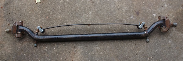

  9. My opinion will differ from the rest on the subject but I like the look of a tube axle. Other then if you are using a V-8 60 axle it is a kind of a '60s look though.
    I don't think that a roadster needs to look spindly, short and stout is a look that is pleasing to my eye.
    You got a lot more drop in your axle than what I am using on my sedan. I am making up for it with dropped spindles. my axle is probably a little older then yours too. front axle tube.jpg
    I'll have to post another shot when I hang it.
    Titus if I ever saw it done I would have been really young and don't remember but I believe that you are correct from what I have seen of the *original axles and heard from the old guys ( like my dad's age guys) when I was a young man. I believe like you that Dago Drop axles were hammered out then bent and aligned after the fact. They had a rough look about 'em for sure. I haven't seen a real Dago Drop axle in about 30 or so years. I would consider it a score to just see one even if I never owned it.
    *original dago drop axles.

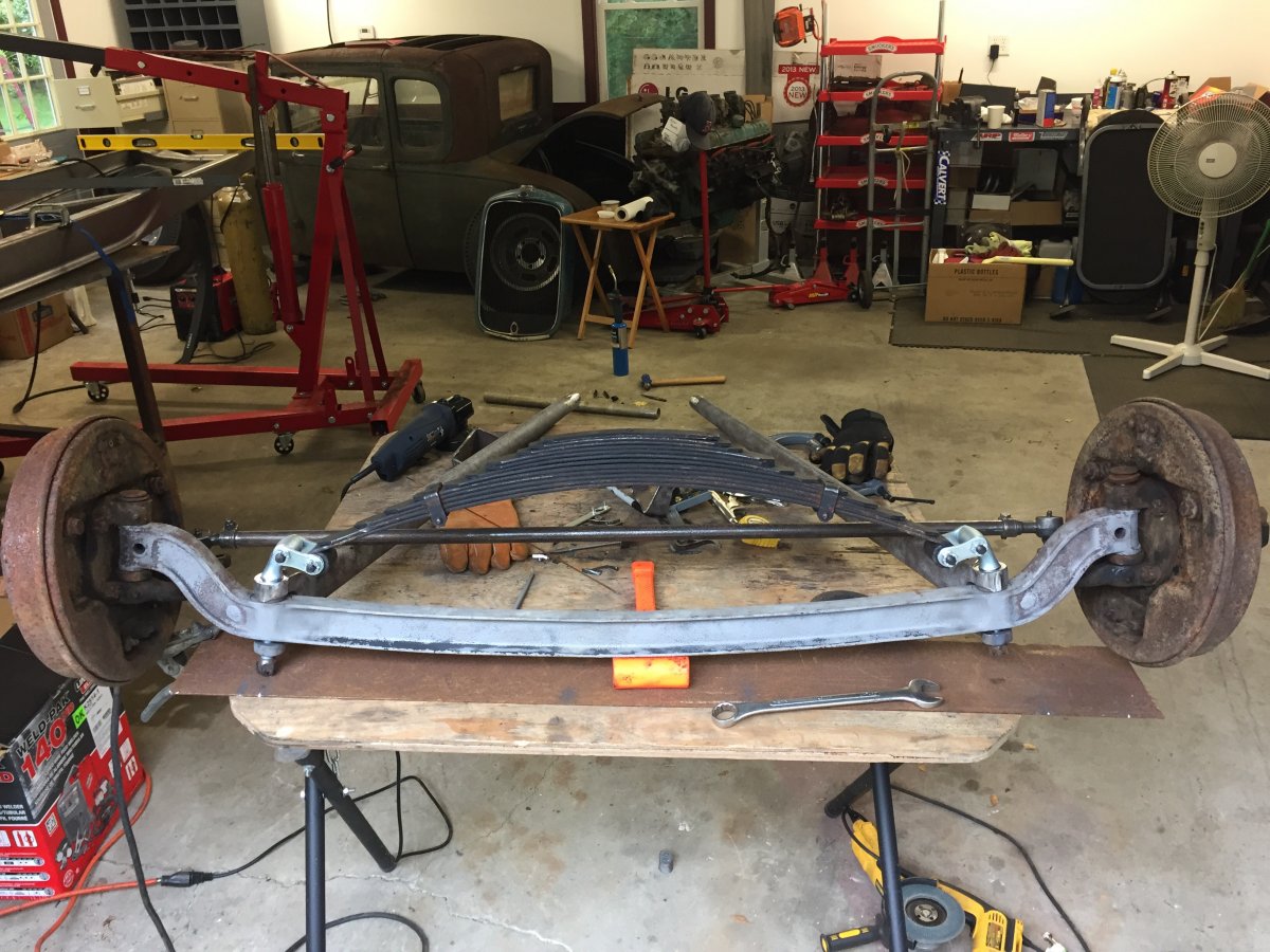

    Here's my 32 I picked up at a swap meet last summer, not sure how much drop it is though. image.jpg

    51box Your 32 axle has a mild drop not much over an inch. Go to Anson Dropped Axles.com and click on 32 axles to see a 2.5 inch drop.

    That's what I was thinking an inch or 2, looked very minimal when I first spotted it. Someone smoothed the top already and welded up the old shock holes.

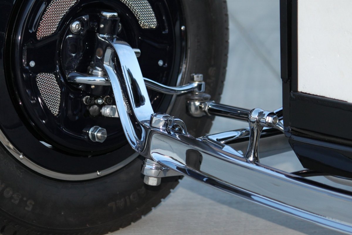

    Dropped axles are just plain sexy, here is one end of an axle I just had dropped by Kohler Kustom.

    Mark, That appears to be very well done. Where is Kohler Kustoms and what do they charge?
    Thanks, Dave

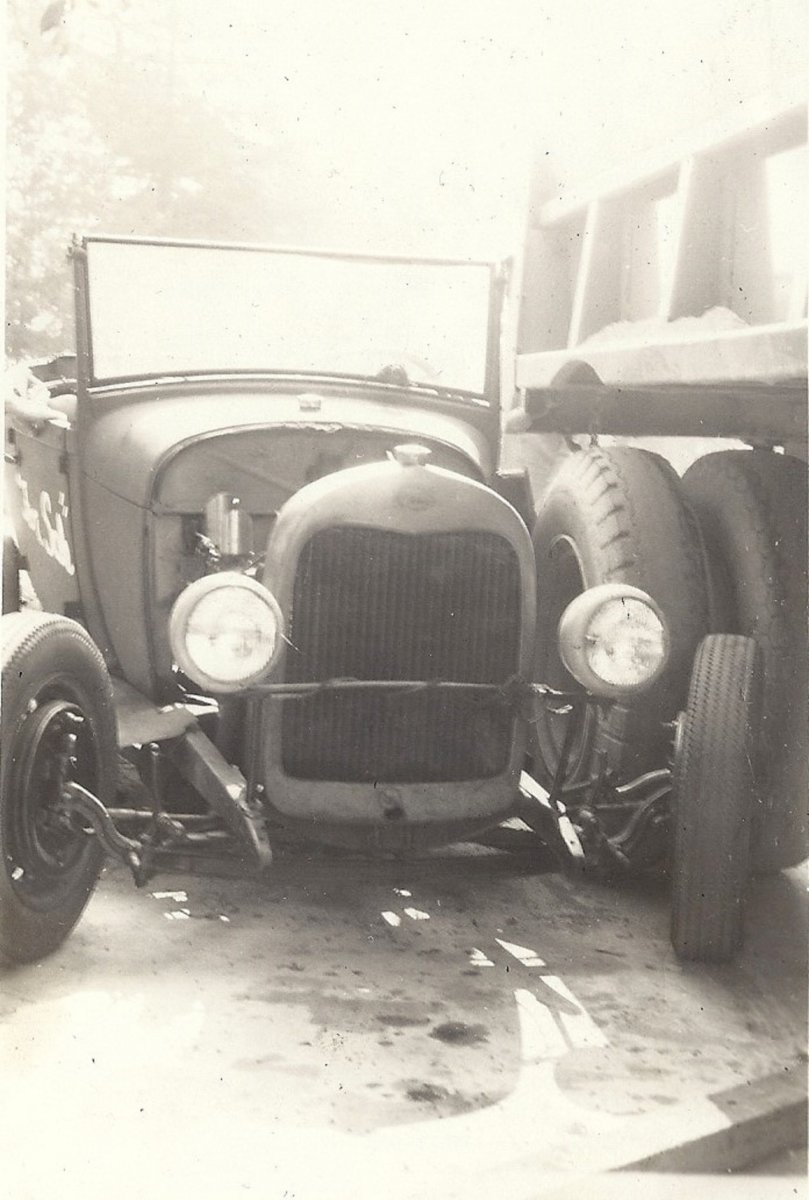

  24. I think that with your '07 join date you should know that the '70s are pretty much out for traditional rods. In recent years we have pretty much tolerated a lot of later crap but we established the end of the traditional era at least for the scope of this forum to be @ 1964.
    Interestingly enough the drop axle never really changed much from its beginnings to now. There really isn't much you can do with one that is different than the originals. I don't have an example and no one has posted one but there were some that were welded up and not stretched way back when. Perhaps there are not good examples because it takes a pretty good welder to pull it off or maybe just because it was never really as popular as stretching or hammering.
    As for your like of tube axles you obviously were not around then, the one I posted I only posted because I know when it was made and by whom and it falls within the guidelines that we established for this forum way back when. I would say that no one ran a tube axle before the early '60s but then I would have to count out Norm and all the others that ran v8 60 axles wouldn't I and I have seen them dropped as well.
    Here is one I stole off the web but if you look around and have a little more patience then me there is a thread with a couple of old dropped V8 60 axles that are a little more visible.

    Andy Kohler is located in Williamsport PA.
    He charged me $200 to do my axle.
    Andy is a great guy to deal with, here is a link to his profile page;
