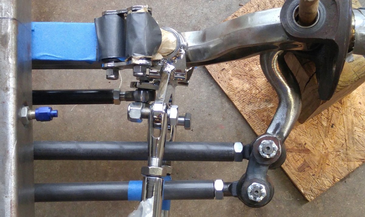

    I have a couple questions about modifying the steering arms on original spindles for a drop axle. The steering arms a need little bend to get back turning radius and then raise the ends to clear the wishbones. My question is this, does this get done on the car? does this damage the bushings and will they need to be replaced?

    I think it's easier to do in a vise rather than on the axle. Bolt an old Ford backing plate to the spindle, and take measurements from the backing plate to keep your Ackerman consistent. You can also mark how much drop you will need on the plate.
    Reason I think it's easier off the axle is because you need to get in there tight on the base of the arm to heat and bend it down towards the center of the car. This gives clearance under the axle on a full turn. Then you can worry about the amount of drop to put the tie rod around the wishbone.
