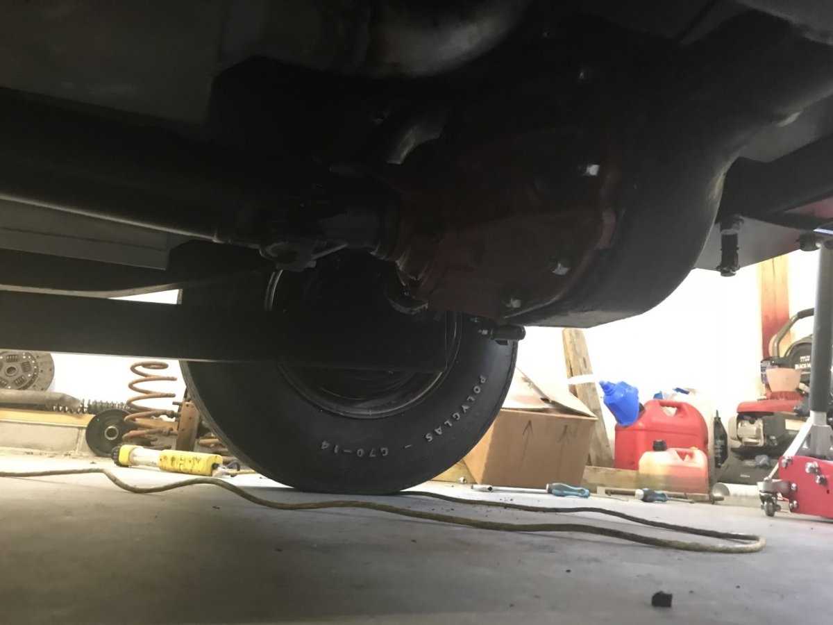

    Hello I am a new member and although cars are not new to me..The 32 5 window I currently have is.I know all the world needs is another Milner clone but that is what the car is. This car was a crappy build and an ebay purchase and I was totally ripped off. My fault for taking someone's word. But living on the east coast and the car was on the west made a problem for inspection. I have read the posts over and over about pinion angles. Here's my problem. When I first purchased the car back in Feb. There was a loud knocking sound from the driveshaft whenever the car was coasting at lower speeds. It has an 8" Ford rear end in it and I thought there was an issue with the gears..I replaced the whole 3rd member with a rebuilt unit from a reputable source while I was there I also replaced the axle bearings and seals. That did nothing for the issue...It has a rebuilt non WC T5...After further investigation I found the rear axle to be pointing downward a full -12 degrees..I don't weld so I had a local shop to cut the housing loose from the traction bars and set the proper angle...When I got the car back it still is sitting at -5. I am unable to move the transmission from it's current position. I have no one local who can do the job over so I am wondering if this variance it's going to be a large issue or is there a custom drive shaft option either double cardan or velocity...The current measurements are as follows Transmission is Negative -2.3 Drive Shaft Negative -2.0 Rear Axle is Negative -5.4
    I have worked on this car every day since Febuary and I am still unable to make a trouble free drive. Thank You in advance for any help

    Thank You All for the advice...The problem is I live in a very small rural area in West Virginia..This housing rotation has been already attempted 3 times..Twice by myself and a friend with welding experience and secondly by the mentioned shop. The housing in the car and traction bars will not take another cut and weld. Every time it's been attempted the car was sitting at ride height but after the procedure it always seems to come out more negative than the initial setting. I have spent over 2K in the rear end and transmission etc trying to fix this problem...A few more dollars really won't make an difference now as I am over invested in this car...I sold a very nice body off big block 55 210 to purchase this thing and have as mentioned yet to have a pleasant drive. I contacted 3 places online about having custom drive shaft made. Two of them told me to turn the axle up further and one never responded... I have read over and over about parallel angles etc and I understand the purpose and whats needed...I just can't seem to make it happen..Thank You all Again

  9. I don't see where you mention how the rear Axle is mounted. How about some photos. You may have other options once we can see what your working with. It don't add up to how things can change once it's cut loose and re done then to change once set on the ground.

    Really need a drawing or picture. What's the traction bar set up like?

    I am about 35 miles south of Morgantown....The traction bars are made out of square tube with plate welded on the sides and then cut out and welded to the axle housing..They have a heim joint on the end that is attached to a bracket welded on the inside of the frame rail between the door opening and fender cut out.

    Your pictures a little hard to make out. Is this like a truck arm suspension? Two lower bars welded to the rear axle with joints at the front?

    I will take better photos and post this evening before I do anything else..Thanks Again
