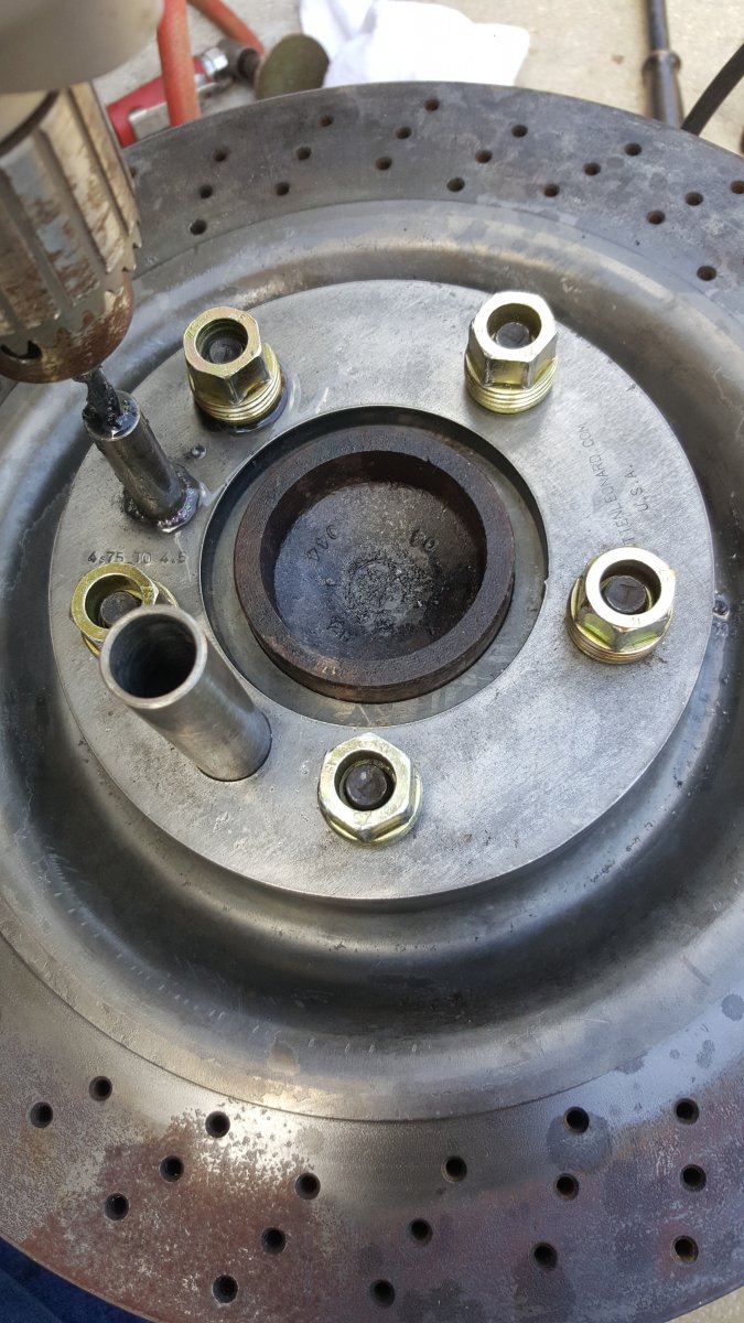

    Made a bolt pattern check wheel and used these when I machined for the holes.
