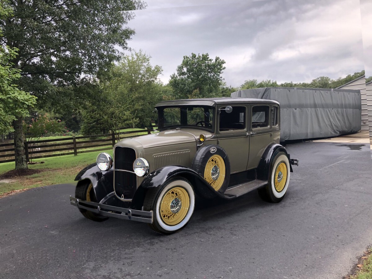

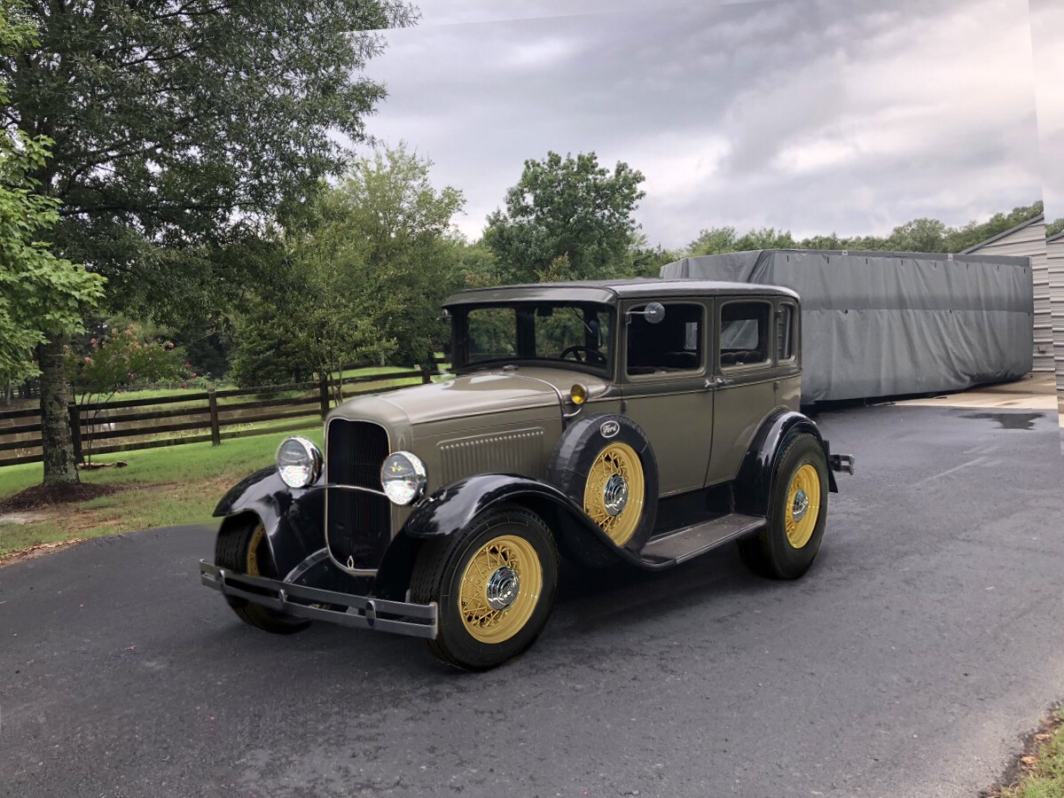

  1. I definitely like the black walls better, plus they are easier to keep clean. There are several posts on using the deuce grill shell on a 1930/31 Model A. Main thing is you have to relocate the filler neck on the radiator if you want to use the stock cap. On my AVATAR the cap was removed and replaced by a pressure cap under the hood. I attached an original cap to the shell for looks using a metal strap, and bolt. I would keep the tire in the fender and use the trunk to carry stuff. I just noticed the eyebrow fenders in your first post, nice touch. Car is looking good.

  2. Thanks for the tips Charlie. I had done some quick reading on the 32 grille swap and it seemed like it might be a pretty easy deal all things considered. I dunno about the spare tire and trunk tho. LOL I've kinda kept my eye out for a decent 30 fender without a spare hole for half reasonable to swap it out and plan on removing the trunk. For just putting around town or a few shows, I don't figure the trunk will get any use. LOL

  3. Eyebrow fenders have the fender bead running across the front of the fender. They were used only in VERY early 1930 vehicles. They are neat but may be a problem for you. You would be lucky to find any eyebrow fender but to find one without a fender well could be a problem. You might have to replace both fenders or patch up the hole for the well in yours (bad idea on a fender that rare). Running one with and one without an eyebrow would look funny. Keep your fender with the well and use the trunk. Drive it a while and you will find the trunk to be useful, otherwise there is no place to put stuff.

  5. Thanks Charlie, now I have learned something. Guess I can stop my hunt for a plain fender...good thing I didn't spend money on one only to find out it didn't match. LOL I don't see me buying two fenders, so guess the spare stays right where it is. LOL

    How about dialing back a tad on the yellow?
    catdad49, dwollam and Bowtie Coupe like this.
  7. Oh yeah, the “straw” that’s on the car now is much more subdued than the yellow in the photoshop. I will certainly be sticking with the lighter straw color rather than an out right yellow.

  10. Better???
  11. Wow! Thanks Moose! Right on the money! I wasn't worried about the shade when you did the first set, I could see where I was going with that, my problem was choosing the white walls vs the black walls, which your pics helps solve perfectly. Cool to have one with the lighter wheels tho, thanks!!! :)
