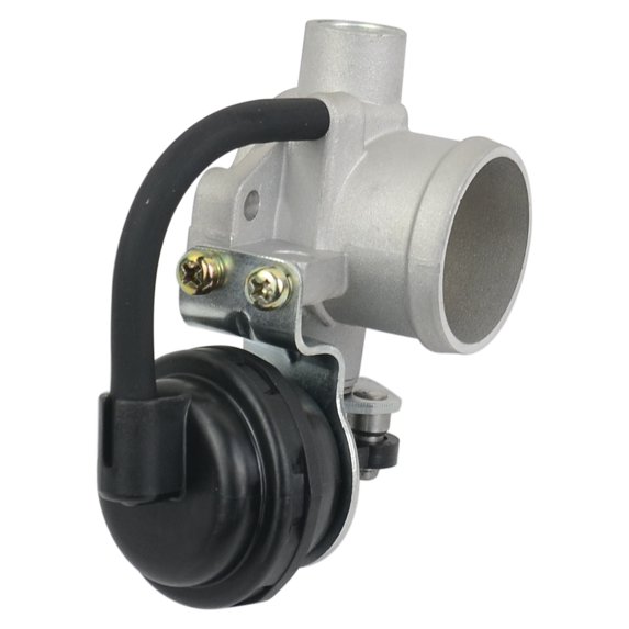

    I have a 1980 Turbo TA 301 with the draw through set-up. I think that RacerRick is correct in saying that a bypass valve would be of some benefit.....since every time my car makes a WOT shift the engine pings due to build up of pressure in the intake (caused by engine RPM drop). The waste gate control does not quick enough to handle the spike.
    I would like to see some photos of the bypass valve setup that he has to see if this could be done on our cars.

    Knocking the dust off this threads once AGAIN! I'm inspired to put a ebay t35 turbo on a inline6 250 chev. I've built a draw thru carburetor set up. (Holley 500 2barrel) at this time it cold starts fantasticly easy. My main issue that i'm having is after I give it a quick rev, Giving it a chance to spool the turbo up, When I quickly release The throttle and let it go back to idle, it will die out quickly.
    It's very easy to restart. If I slowly nurture it to go back to an idling state (after a rev), it will run on its own easily. So I know it's not a initial carburetor problem. I'm assuming what's happening is The spooling turbo Is making a intense draft on a Carburetor with closed throttle blades.... Thereby causing a excessively rich mixture at that moment. So my idea/theory is to Install a bov/pressure relief immediately after the turbo, And dump it into the intake tube under the carburetor (before the compressor). Admittedly My goal isn't to relieve pressure as in a blow through application... Actually my goal is mostly to release some of the heavy suction/ Vacuum draw under the carburetor .... diminishing the carb signal enough to keep it from that brief intensity of rich A/F. Has anyone ever tried this before? Will my theory prove accurate? What y'all think?
