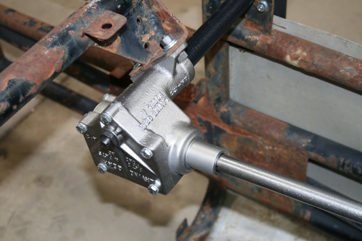

    1947knuck
    Here are pictures of the restored steering wheel showing the left hand brake handle. I cleaned the steering wheel and the cover (Horn Button) over the mounting hardware it really shows it's age but I'm going to keep it as is. The steering wheel appears to be home made, but done nice. My son John IMG_1820.JPG IMG_1825.JPG cleaned repacked and installed a new seal in the Lavine steering box. It appears that it is mounted upside down for the right hand steer.

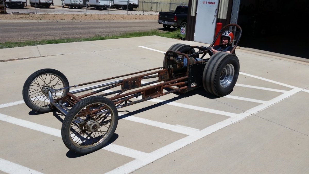

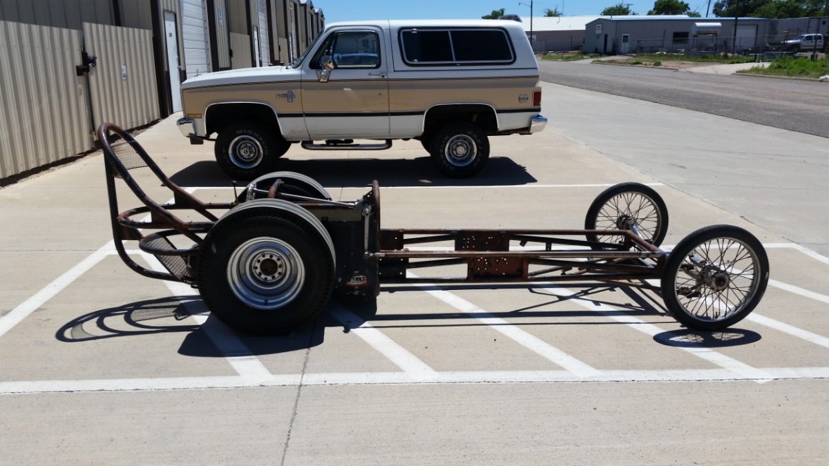

  9. 1947knuck
    Joined: Sep 4, 2011
    Posts: 5,458
    1947knuck
    We pulled the dragster out to be able to stand back and look it over and discuss the plans for it. My son John with his old helmet got in an we imagined how it was back in the day. We stripped it down after this to have the frame soda blasted to be able to get a real clear look at everything and any other possible repairs. thumbnail_20150510_144625.jpg thumbnail_20150510_144417.jpg

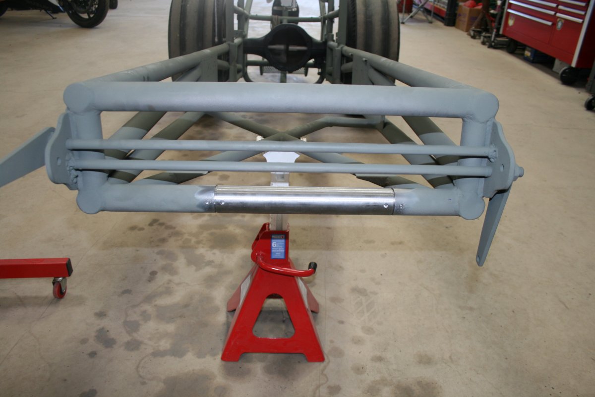

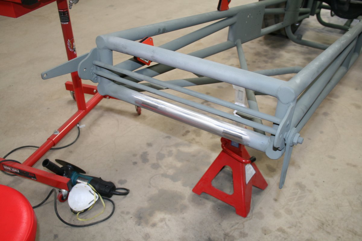

  11. 1947knuck
    Joined: Sep 4, 2011
    Posts: 5,458
    1947knuck
    We had the frame soda blasted and primed, we checked over the entire frame found one small area in the rear that needed attention. The damaged tubes that were replaced had no signs of rust inside the frame. It appears all the damage was after it's racing day's. I included 2 pictures to show how my son repaired all the damaged tubes. He had hollow 2 inch tubes that would slide in the existing tubing. He drilled holes to line the inside tubing equally between the original and new tubing, lined everything up, welded the holes first to make sure everything was straight, then finished the welding and smoothing. IMG_1845.JPG IMG_1846.JPG

    The repair looks great, dont know how tight the fit was for the sleeves, when we have to splice frames, we would take the sleeve and split it length wise to let it expand (like a roll pin) and the alignment of the old and new tubing is perfect and subsiquent clean up is a breeze
  22. rottenleonard
    Joined: Nov 7, 2008
    Posts: 1,995
    rottenleonard
    Thats a good tip. When you make a splice like that is it ok to blend out the weld completely so the splice can't be found or is that considered a no-no?

    dreracecar; The fit was snug we left it just loose enough to be able to move the sleeves where they could be centered. Never thought to split the sleeve, good idea.
    rottenleonard; We left just enough space between the new tubing so that when we welded it all up both the old and new tubing welded to the sleeve so when we smoothed it out there should be enough weld left for the strength. I think it worked out just fine.
