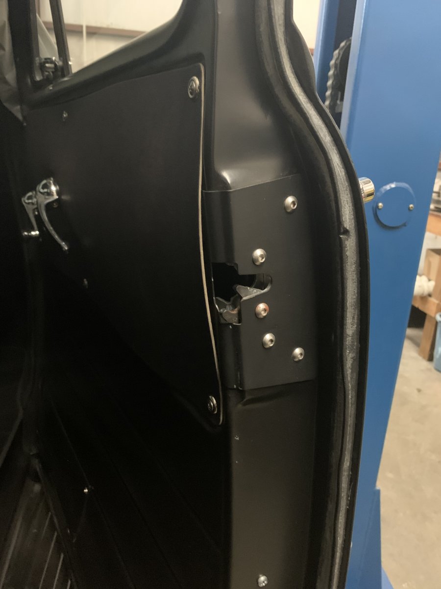

  7. lilmann
    Joined: Apr 13, 2017
    Posts: 145
    lilmann
    Here is the passenger side latch...
    I’m guessing that I also need to adjust the bolt on my jamb as the door hangs out a little bit and is rubbing paint from the jamb to the door.
    I’ll look into the doors and see what is missing, I can’t even push my handles forward.....
  8. DIYGUY
    Joined: Sep 8, 2015
    Posts: 883
    DIYGUY
    from West, TX
    Those are Altman “easy latches” by Trique mfg. Sorry, but you lost the locking feature when those were installed. I have them on mine and love them.
    I made some modifications to mine and got the locking function back but it’s no bolt in job.
    lilmann likes this.

  11. squirrel
    Joined: Sep 23, 2004
    Posts: 56,088
    squirrel
    Probably because there is no lock mechanism in there? The original latches are rather complicated inside, since they do have a locking mechanism.
    lilmann likes this.
  12. Right, you can't push the handle forward because with the style of latch you have it doesn't have or need that feature. It's a spring loaded double click safety latch, pull your handle and it trips the spring to open the latch, when you close the door it resets.
    lilmann likes this.

  14. That’s a bear claw style.
    Some have a lock feature some don’t. But it will be an auxiliary knob, not incorporated into the handle like factory.
    If you’re doors come open while driving with those latches there’s a bigger problem in there somewhere.
    Most likely the door pin and latch need to meshed further together but the latch may be toast.
    Those trucks had some bad fittings weather stripping that mess the door closing up. Forget who but one supplier/manufacturer is way better than the other

    Strictly, the term is "bear jaw", as "Bear Claw" is a trade name of the dreaded Hoffman Group.
    The latch in the above pic looks like one of the better ones. Double-jaw latches like that often have higher strength ratings.
