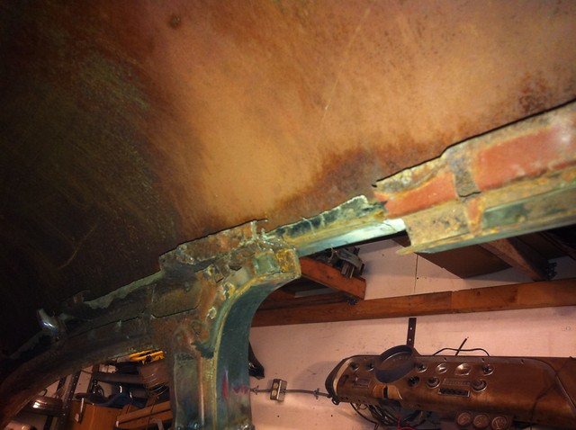

    Bob Bleed might be a helluva good welder now, but when he did this car a long time ago he was definitely not too interested in the details. I spent this weekend cutting out a lot of his old work and redoing it. Nice to have the luxury of a donor roof hanging on my wall to cut some bits and pieces off of.
    I couldn't put the car back together with stuff like this...
    I tried to clean it up a bit, it just made it worse...

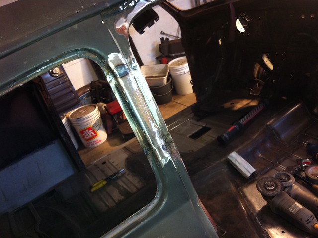

    Used the tried-and-true masking tape measuring method...

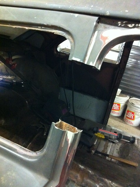

    Cutting this scared the shit outta me...
    But it seemed to work...

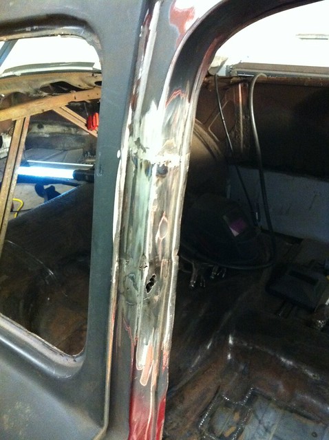

    I figure it's like outrunning a bear. I don't have to outrun the bear, I just have to outrun the guy beside me. So, I don't have to make it perfect, I just have to do a better job than this...
    Cut it out...
    I might change my screen name to King Boogerweld...
    Got both B pillars and one doorframe redone, cut out and reworked the hacked-up package tray, made and installed the last two floor braces under the rear seat area, and did most of the finish welding on the big exterior patch panels that I'd been procrastinating about. Didn't get photos of most of it, but progress is good.

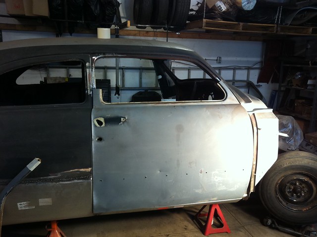

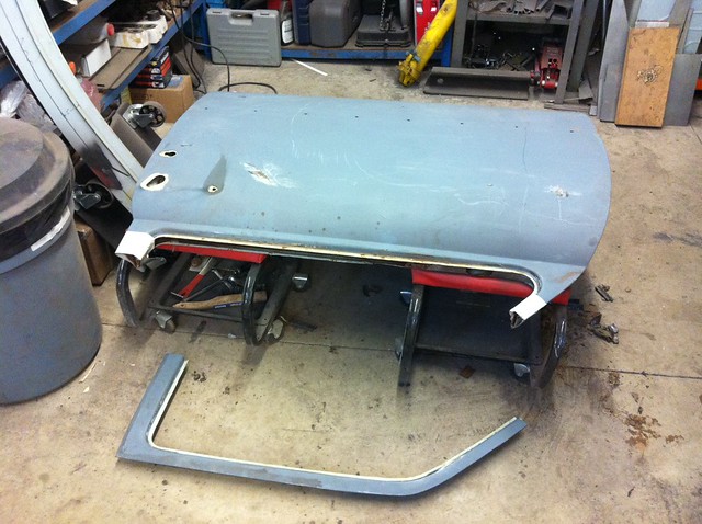

  22. I kinda had it in my head that the rust repair portion of the evening's entertainment was behind me. Wishful thinking, of course. I've been waffling between salvaging the original (already chopped, shaved etc) doors or using a new set I got from Jaker with my parts car.
    Had a gander at the old doors... lovely... I know, I know, what did I expect, right? hard to tell from the photo, but that Bondo is about a mile and a half thick...
    Alrighty then, guess I'm chopping the new doors...
    My palms were getting a bit sweaty as I grabbed the sawzall. Nothing like taking a nice solid set of doors... and fucking them up...
    Going to take a bit of massaging. Got a few holes to fill and dents to undent...
    That's the easy part. I got the various pieces cut, and should be welding 'em up next weekend. As usual, I ran out of time yesterday.

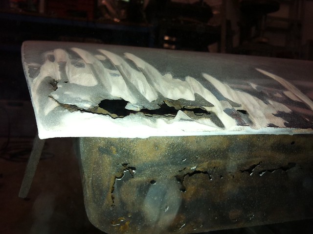

    Stay tuned. Next weekend I'm also going to screw up a perfectly good trunk lid.

  26. There's probably 20lbs of bondo in each door. Bob is definitely a good sculptor.
    I seem to recall the Can O' Worms had a little filler in it to start, didn't it? :D
