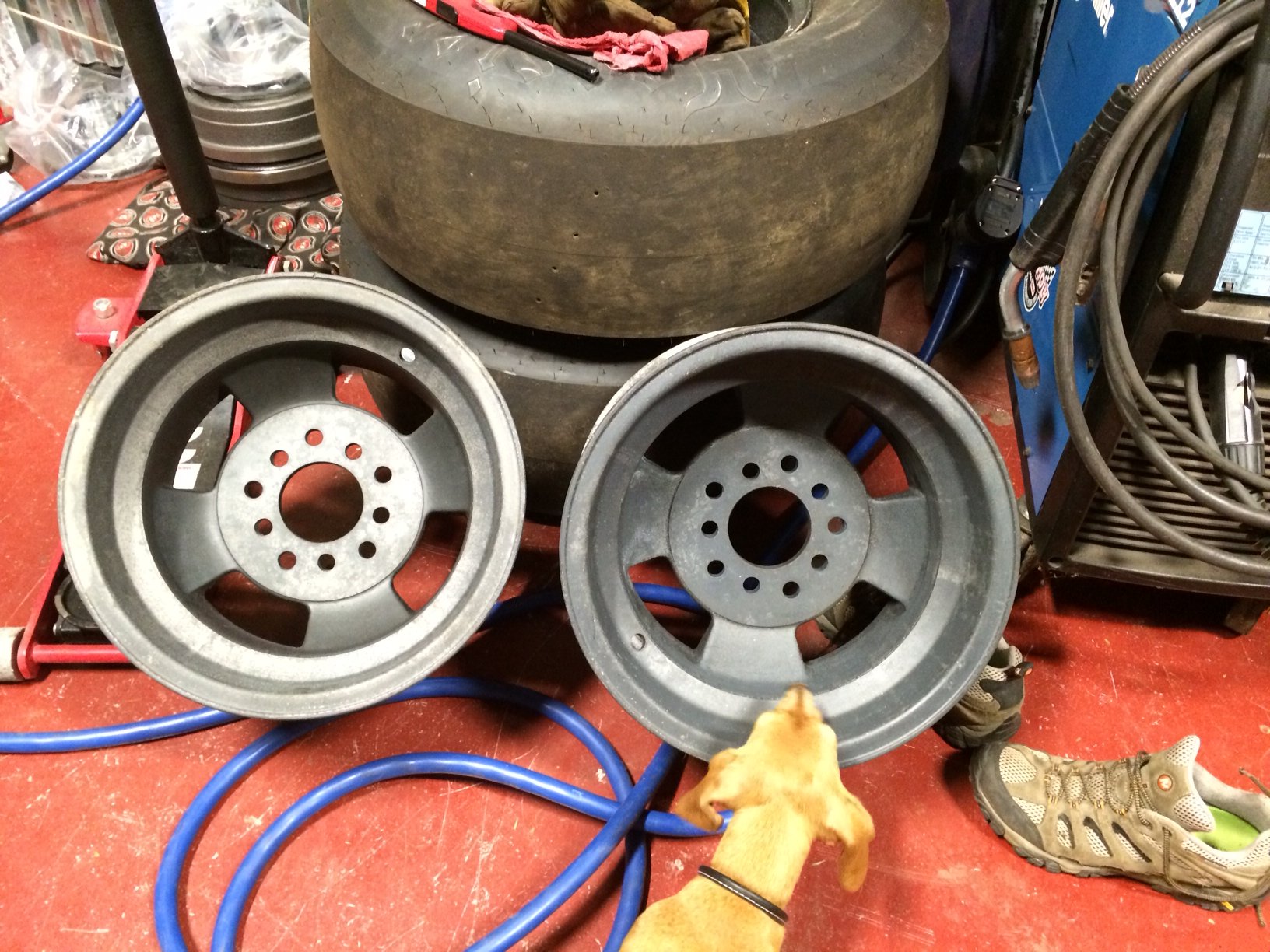

    Hey Steve - did you drill your Palamides for rim screws? Trying to man up and drill mine :oops:

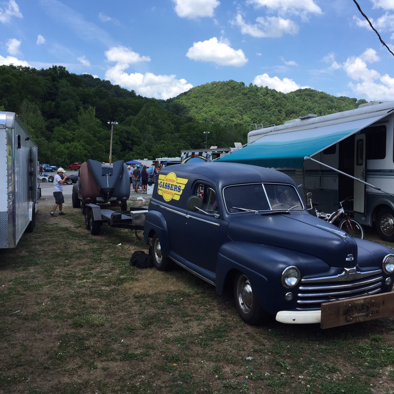

    Saturday morning at 6am the Sedan Delivery left for Knoxville with Quick N Dirty in tow. The first gas stop in Fairmount Ga I needed to use the jump box to get it to crank :( what the hell man? 20 miles farther I pulled up next to 3dnsouth in Calhoun and said "Should we try it? She wouldn't start at the last stop." He says "Ah she'll be fine, how else are we gonna find out what's wrong?" Off we go.
    The damn temperature gauge is still wacky - I put in an oil temp gauge that I had to see what it would say. (The Dakota Digital readout was matching the IR probe so I knew we were ok - but its UN-nerving to watch this going up hill -
    The ground must be weak or the 12v is. So we decided to have some fun with the SFCC crew on a TXT thread we have going. :rolleyes: "Hey guys is this ok ?"
    Then sent this pic of 3dnsouth :eek:
    So we rolled past the good gas station because of talking too much - we had to swing off and get gas at a little nowhere place that was pretty low traffic. Can't remember if it was me or Tim who said " Hey man beats walking!"
    Ha o_O bad gas will get you walking .....
    It was kicking an sputtering every once in a while on the interstate - pulled off the first stop light and puuuu .....
    The gas was boiling out of the carb. IR probe says 210F so its warm but not smoking. We started messing with the Edelbrock carb. Had it on and off 2x. Just would not run - dumping gas. Lots of cars go by and I'm thinking - if I can get a ride to the parts store, a new 1406 will get us going - no doubt - had too many Edelbrock issues but you can get one anywhere and the linkage is all setup - 10 minute swap.
    Finally a white daily driver car pulls over - thought it was the cops - it was Tommy Lee Byrd :D Nice! He had a funny grin - sort of like what the hell are you guys doing now ? Short story - he ran me to Oriely's bam new carb - started right up and we were at the track in 30 minutes. Thanks a ton man!

  23. So just for an experiment - on the way home - I got home at 2am - Tim pulled the push board off the front and what do you know went from 210F to 187F on the interstate no other changes. The board has got to go!
