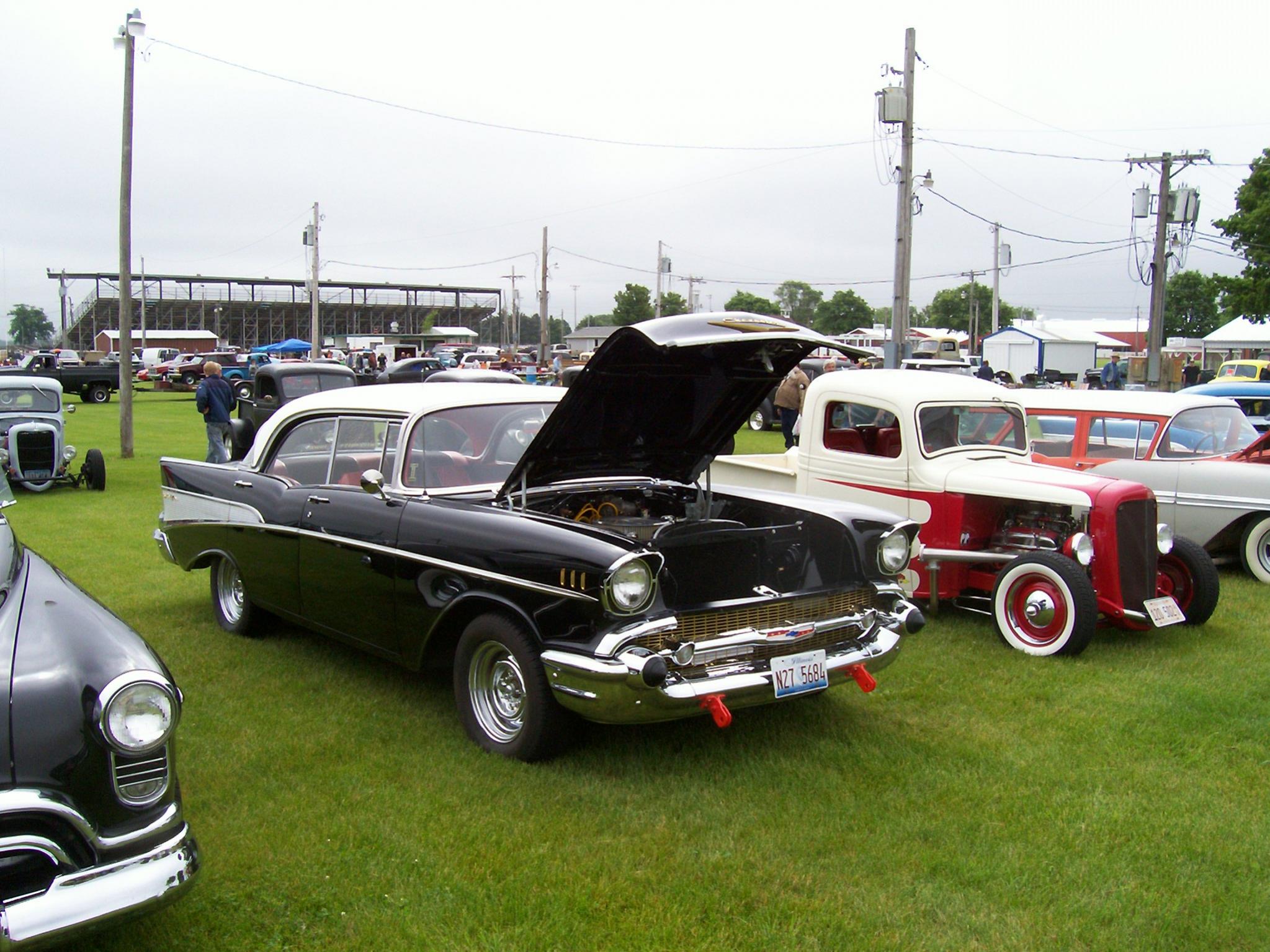

    I was giving a thought of using a tow bar for my Nostalgia Car . Do you still use one or have you used one in the past? I drive it on the street but I really don't want to race and drive it to the track . Yea it would suck if I blew the diff, but at least I would have another vehicle with me to fetch a trailer . Just a thought ??

    I installed tow-bar tabs on my Fairlane last year. I did it just for the proper look of a 64 drag car. One weekend at the dragstrip a guy says" whats that under your front bumper? You got some kind of snow plow that hooks on there?" Cracked me up,and gave us all a good laugh.:D

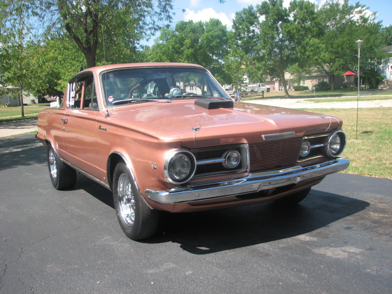

    I flat towed to the track, about 65 miles one way. I put these tabs back on when I restored the car. Partly for the look, and partly to give folks something to scratch their heads and wonder about. These, as installed were not really adequate. I managed to tear my bumper at one of the seams. I then fabricated brackets that bolted to the frame. Seems like I was always a step behind the crowd. I drove to the track when everyone else was flat towing. When I could afford a tow bar, the others had open trailers. Today I have a nice open trailer and ....... I also had free-wheeling towing hubs which worked really well. This was much better than crawling under to drop the drive shaft. I planned my suspension mods to retain good highway handling. Since the race car always cornered better than my tow vehicle, it would follow me through any corner. It was easy to forget it was back there. Also, I made up a wiring harness to actuate brake and tail lights on the 57.

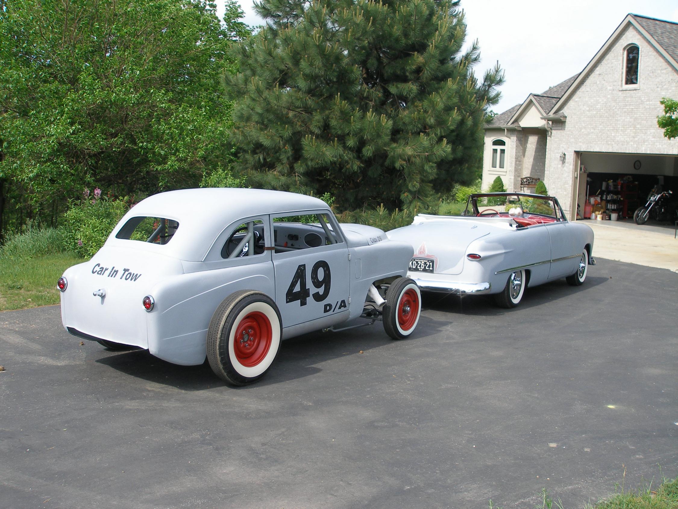

    My dad towed hundreds of cars with a clamp on tow bar in the 60's & 70's doing repo's for his bank. That old tow bar is still up in his garage attic and I am probably going to use it to tow my '49 to out of town meets. Either that or put some tabs on the '49 frame and use a detachable tow bar. I love the thought of driving my old truck, but anything over an hour and I will probably be taking my new truck and dragging the old one.

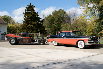

    1. The Gas House Gang
    This tow bar was a production bar modified to use. Bolted tabs to holes in front axle of the truck. Works perfect, towed about 3000 miles.
