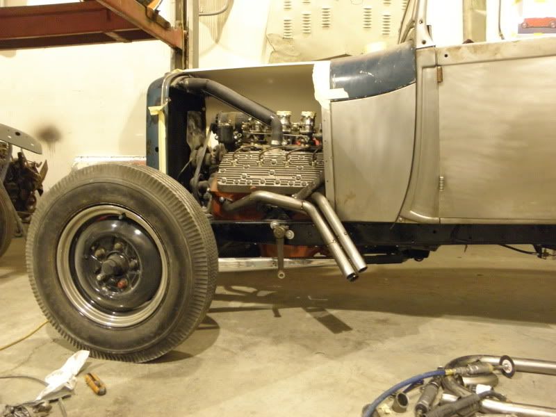

  1. I built a set of headers for my roadster today, but I dunno, I think they look funny. Is it just me or do they actually look weird? Their only tacked right now, so I can easily change them, and I havent started on the other side yet.
  2. Honestly looks like an altered of gasser type header. Great if your doing a 60's street/strip car...but then again I dought they would run a flathead :D

    The inner pipe was run to clear steering.......it would almost be way gnarly if you could get it and the first to curl around each other a little more and then into the 3rd.
    Unless you want to go with something real linear?
  4. fuction over form...old way of rodding....but ya gotta like lookin at em...when ya own it....don't look bad from my puter........
  5. Sorrym they look too 60s for me.
  6. Yea i think their a little too 60's style also.
    Originally I was going to run flex pipe, real 40's style, but the pipe wouldn't flex enough to clear the steering box.

    Reminds me of fenderwell headers.
    You have a lot of cool old parts on that car, so it kinda steals your attention...?

    The center pipe gets lost and not seen at a few angles .. nothing wrong with it but personally I do not like it.
  9. Hack em off a little higher and flow them into one solid pipe that bends right under the cowl and heads strait back next to the frame.

    I don't think they look funny...
    The length is good and they dump down nice... like fenderwell headers do. Will look better fully welded and coated when finished of course. I could see them coated white... just my opinion.:)

    Maybe a lakes style?
  12. Never really liked the look of lakes headers, and their way overdone and sound funny too me. I do like chris's idea though.
  13. Yes! Look at Bishops Old Bluey. I think they would work with full sidepipes

    Cut 2 or 3 inches off the end and I think they'd look fine.
  16. That's a great looking roadster. I don't think those pipes fit the look for that particular car though. I do like them on their own however.
  17. They look great just slash cut the ends parallel with the floor , level both ways and your done. Rob
  18. Exactly what I was thinking, they don't suit the car. Well that settles it, tomorrow their getting hacked up haha.
    I do like the headers on ol' bluey, but I just hate the echo sound they make.

    It`s yours,do what you like, never let anyone judge your tastes. Different is goooooooood.

    I don't like uncollected headers unless it on a blown fuel application. Bring them together a little higher, put a collector on and run them along the frame rails with a turnout. Done!!!

    they are going to blow dirt and dead leaves and junk everywhere including places you dont want dirt

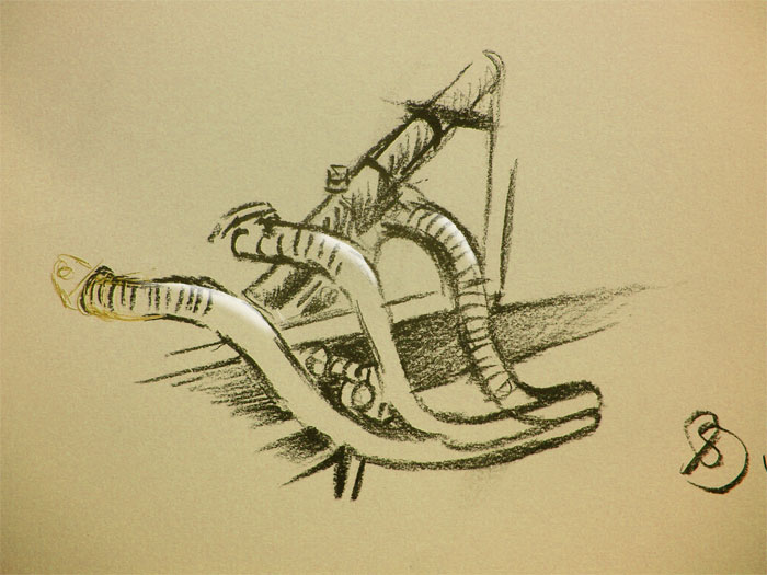

    My 2c?- You gotta nice '40's thing going with that car.
    I drew this in response-

    ^ nice design and artwork
  24. You drew that just for me? Awwe shucks, you to nice...:D
    I really like it though! I think that will be my plan for tomorrow!

    Layout of the headers aside, larger radius bends would be more pleasing to the eye, and couldn't hurt function either.

    Not my cup of tea ,But they are ok /They dont look funny .

    I like the look - Old skool and not off the shelf

    Yea I like em. I think they look right. Gonna make my own also.

    Don"t look funny but if you really liked them you wouldn"t be asking,they just don"t look right on the car.
