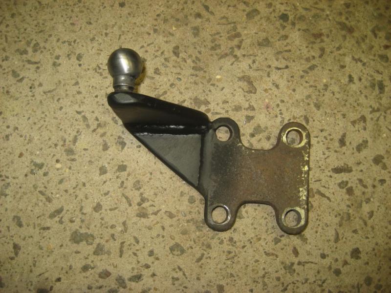

    You need some 3/8" steel plate, some 3/4" square bar, 2 ford tie-rods complete with ends, and 4 weld-in tie rod balls. The pics should be self-explanatory. Remove front spring plate and weld on 2 pieces plate as here, plus ball. IMG_0347.jpg
    This off set to one side of the spring plate lengthens the Panhard rod as much as possible, taking into account that we are making the chassis mount (as opposed to axle mount) here in the middle, not in the ideal place, which is as far away from the axle mount as possible.

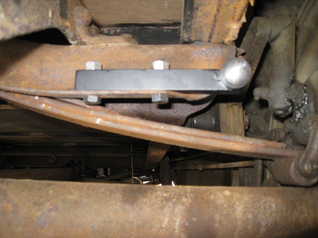

    Here is the axle mount. A piece of 3/4" square bar, drilled and tapped for 2 3/8" bolts, and a tie rod ball welded in the centre. IMG_0357.jpg
    The axle needs to be drilled to mount this block. As close to the radius arm as possible. Offer up the tie rod end first to check clearance.

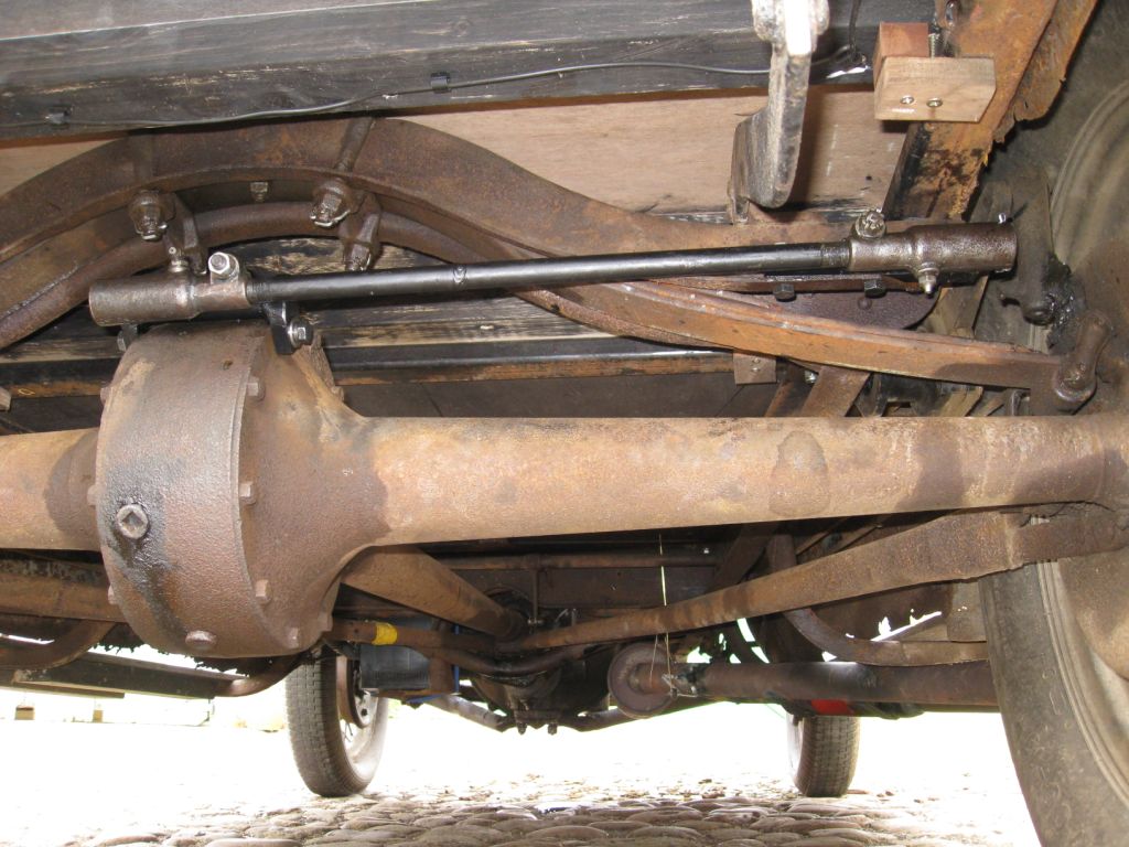

    There will be some that say a Panhard bar must run from the chassis one side to the axle on the other side. For a racing car this may be true, and is without doubt ideal. However, if you crawl under your A, you will see you have to mess quite a bit with the chassis in the area in question. This is a compromise, that is now fully tested, and works a treat.

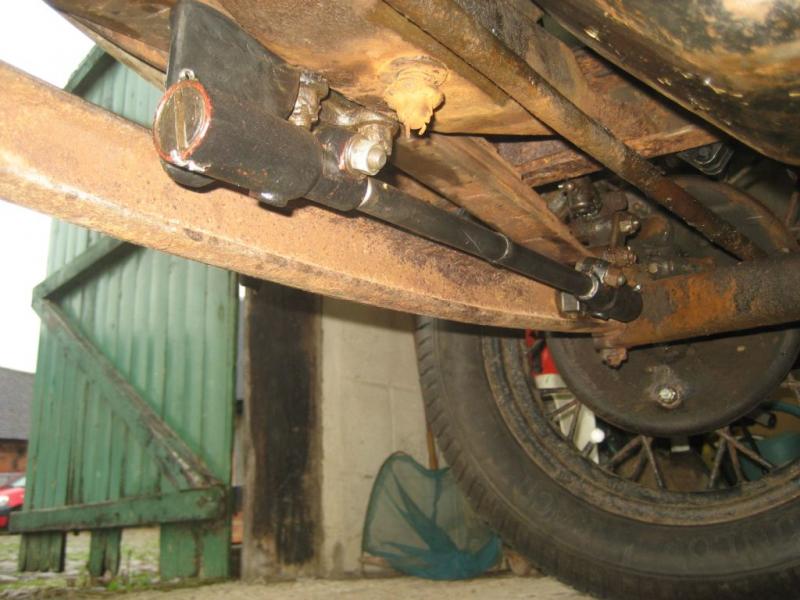

    Bar in place
    Cant tell you how much difference these make. The car now drives as straight as an arrow, and steers easier too.
