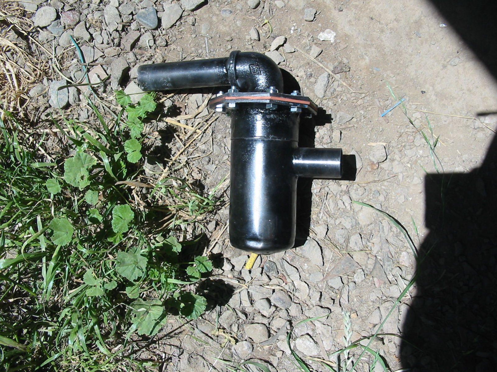

  1. Sometimes engines end up with sand in the coolant passages. As sand will slowly plug radiators, and no matter how vigorously you flush the engine radiator plugging sand remains.
    The only workable solution is to put a sand filter in the coolant hose.
    I have done this on two engines. After a few thousand miles, all of the sand is filtered out and you remove the filter. I'd check it periodically to be sure it does not fill up with sand and restrict coolant flow.
    It can be a full flow filter in the upper hose (faster) or a bypass filter in the heater hose (safer as it can't block the coolant flow).
    The stainless steel screen filter element is made for sediment filtering in wells. It will cost about $15. I have used two different housings plastic when I did not know better (It still worked as it did not know better either) and steel. A disposable propane bottle is large enough to work but not so large that it is hard to fit in. I brazed a pipe coupling to the side of the 2/3 propane bottle and a flange to its open end. A second flange completes it and a 90 degree coupling brazed to it is the outlet.

  3. filter for sand in coolant sand filter.jpg All you can see is the housing, but it is the only part you make. Coolant goes in through the side hole and out the top hole. It was necessary to vent the upper tube to fill the system. The upper tube is a brazed in tube as using water pipe seemed needlessly heavy.
