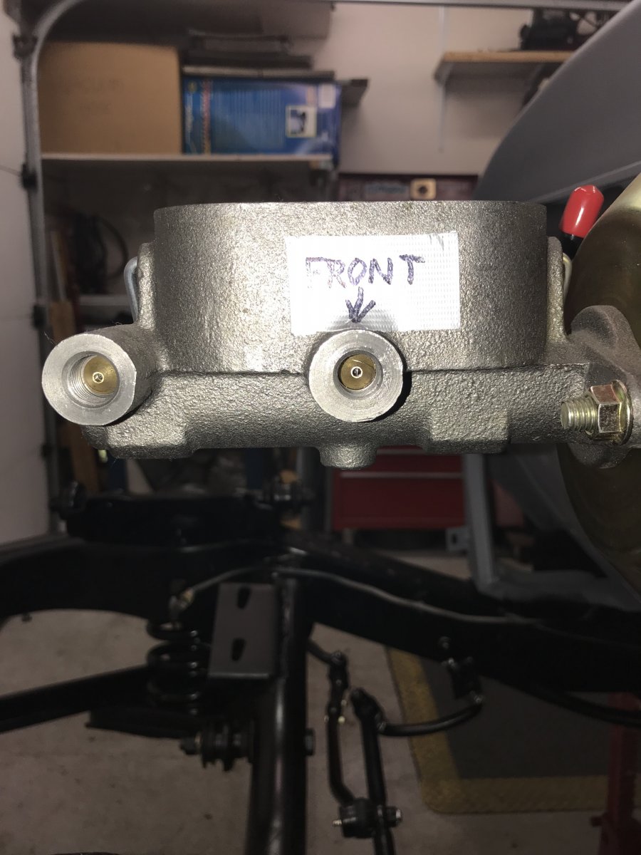

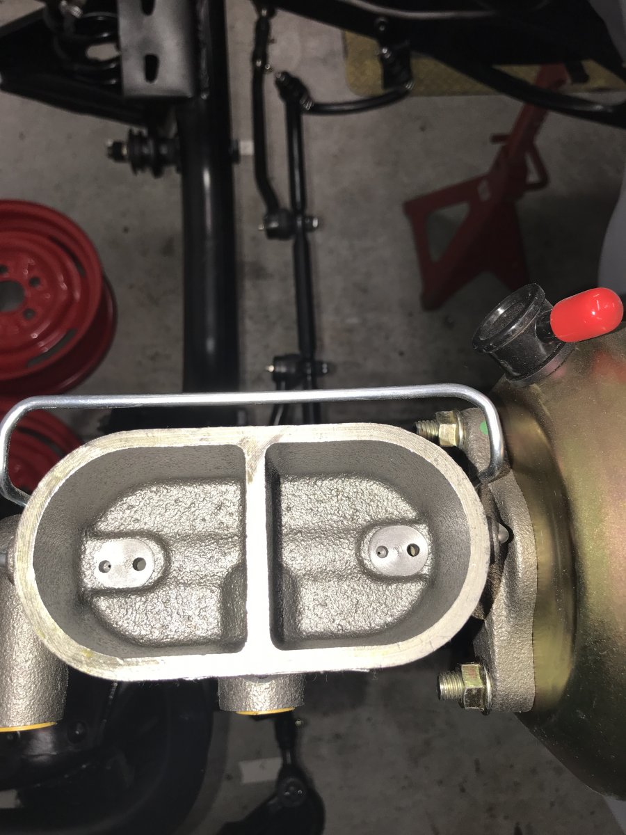

    I thought maybe the master had built in residuals but I can't see any, stuck a small punch into the outlet holes and couldn't feel anything plus it's an AZ rebuilt unit so I'm not expecting much.
    So...with the power brakes, do I need aftermarket residual valves? If I need them, I was gonna use these.....

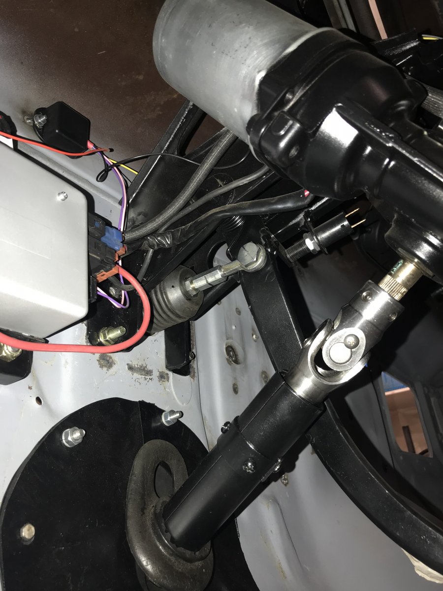

    How would I go about changing the pedal ratio from 6:1 to 3:1?

    Using the tech tip on the MP brakes website, it looks like my pedal ratio is 5.1:1.
    Also, vacuum at idle is about 16" so I'm hoping the higher pedal ratio will compensate for the lower vac and put me pretty much where I need to be!

  14. Sounds like you have a good starting point for pedal leverage.
    It looks to me like there are no residual valves in MC outlet ports.
    Phil
  15. gimpyshotrods
    Joined: May 20, 2009
    Posts: 24,414
    gimpyshotrods
    That has residual valves in it.
    The inverted flare seats are brass. The valves are under the brass caps.
    Master cylinders without them have flare seats that are made of the same material as the master cylinder body.
    blowby and TrailerTrashToo like this.
