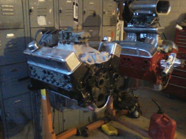

    Here's my old 305. ( Red one ) I purchased what I thought was a late 80s 1 piece rear main 350 finned pan at a swap meet turned out it was a 305 pan. Never did anything with the 305 other than mock up or a parts holder for my other motors. I could never justify dumping money into it when I had several 283,327,350s that needed the same. But it's as traditional looking as it gets lol 327 Power Pack heads (no holes), offy tunnel ram, offy finned covers and that stupid pan! That I never got to use.
