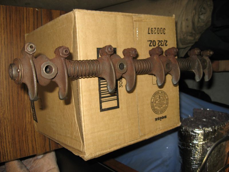

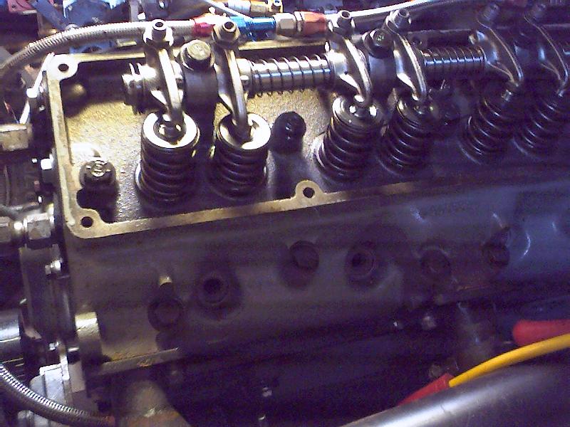

    I have started pulling apart the motor for our 50 Olds, a 54 cad motor which is backed by a lesalle stick.
    I have found a few surprises already. First is an aluminum flywheel, and now this.
    as you can see, chromed stock cad valve covers.
    these are underneath.
    are they studebaker? or aftermarket?
    they ALMOST clear the stock covers.
    I am trying to understand the paint scheme, most of the motor was white, then caked with grease, and painted black over the top. most of the bolt on parts were painted orange.
    so I am eager to know where the rockers are from, and to dig deeper into the motor.

    Proubably Stude. Here is my clearance method. I made the spacers 5/16 because that's what I had.

    1. 60s Show Rods
    Those are not Stude at least not like the Stude ones I have... The Studebaker ones adjust from the bottom of the lifter...so I'm assuming there aftermarket...
    There was a guy on Ebay selling dimpled Caddy valve covers but he wanted a pretty penny

    look stock to me. Caddy, Buick and Olds all had some form of adjustable valvetrain through the early years. What Year block and heads are You working with?

    I put some mcgurks on mine in the early 60's. They were cast similar to those. The
    favorites back then were the Thomas mag ones. I didn't like the spacers back then
    so I went with aluminum taller ones. I'd check the valve lash before you take it apart
    to get some idea of what it was set at.Looks like fun.
    were those dimpled valve cover orig equip? I never saw any back then.
    I guess the above post answers my question.

    I am under the impression that Cadillac did not have factory adjustable rockers, and that all of the dimpled steel valve covers are home made.
    these seem that they would clear stock covers if all of the jam nuts are set with a flat toward the top.
    did the Mcgurks have any markings on them?
    the block is a 53 or 54, and I believe that the heads match. Before tearing into it, I thought it was stock internally.

    I thought I read some where that the Y-Block Ford valve train was modeled after the Caddy / Olds stuff . All Y-Block stuff was adjustable.

    its possible the ajustable rockers are stock,cad with the tri power set up in 57 had ajustable i think .....richie............

    Caddy never had factory adjustibles, unless it was some wierd import deal...
    Piero's right... I have a set of iskys that look like that I think. Thomas ones were magnesium... What else is left? Gotha? Well you know it's probably got a solid cam.
    Thats a cool motor. Whats the history on it? Awesome score.

    OK, I'm thinking built history. Don't have any knowledge on any OEM caddy adjustables. Thats why they invented they hydros, no? If they were stock, would caddy shit hit the rocker covers?? I think not. Old hot rod motor. Nice score. Don't look like Studi's to me, all I have seen have adj on the bottom...

    Caddy didnt make adjustable rockers or dimpled valve covers. Original caddy covers that are dimpled were homemade. That dude on Ebay selling them for $500 a set is out of his mind. Get yourself a hammer and an original set and do it yourself and save $400. Hildebrandt and Offenhauser made dimpled ones.
    Not sure what kind of rockers those are but they are nice.

    I think that Dave is probably right. I have a set too. I always just thought that they were Stude, never bothered to look that close. Here are a few ads for the Thomas and Gotha rocker arms. They are visually different for sure. Mine have a "C 3" on the bottom. I forgot to check the ratio on mine, but if memory serves the are 1.5:1 which is the same as stock. Anybody have an old McGurk ad or catalog we can check?

    Those absolutely are McGurks. Isky bought out McGurk years ago when T. Willy still worked there.

  17. Can't be stock - there is no such thing as an OHV Cadillac with factory adjustable rocker arms. I am not positive, but I beleive the same goes for Buick. My first guess would be Y-block or Mopar. They don't look like Studes, definitely not FE, and most of the vintage aftermarket stuff is not that clean of a casting. Also, most aftermarket stuff has the name of the manufacturer on it. The non-specific letter-number thing sounds like an OEM production code. The Isky stuff says Isky, etc.
    Most of the factory GM and Ford shaft rockers were the same diameter shaft, as is the Stude. Not sure about the Mopar stuff. All sorts of swappage can be done, but you have to look out for the geometry and the contact pattern between the rocker arm and the valve stem tip. On a well used engine, you should be able to see a wear pattern on the valve and the rocker, and see that it is reasonable. If not, you have some re-engineering to do before re-assembly to make sure it runs good and is reliable.

    ok, it looks like they are the MGurks (sp?) confirmed from a local source also.
    if they are adjusted so that the flats of the nut are with the valve cover they will clear stamped stock covers.
    this setup has several thousand miles on it, and has been together for a LONG time.

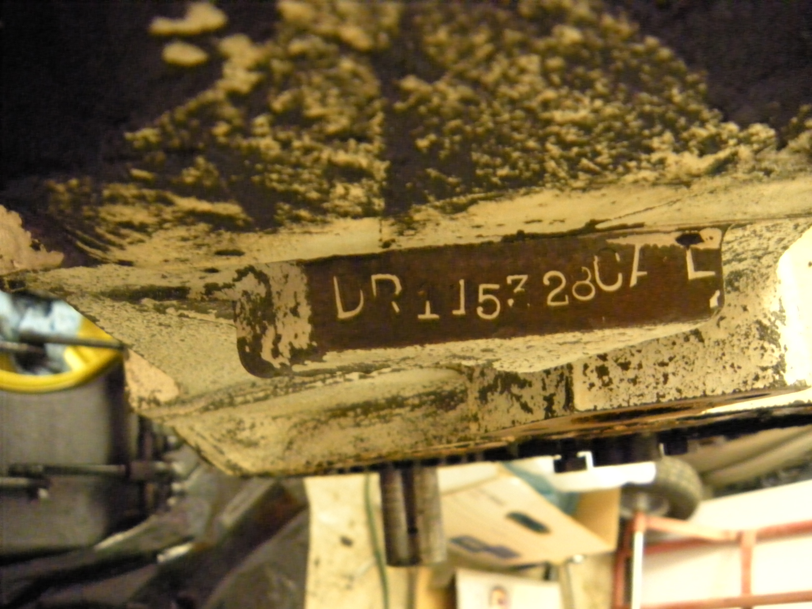

    there are the casting numbers on the block and the heads, and the numbers on the end of the cam.
    shots down the intake ports, there appears to be grinding marks in the ports. do they look different than stock?

    here is the head casting #
    the block casting number
