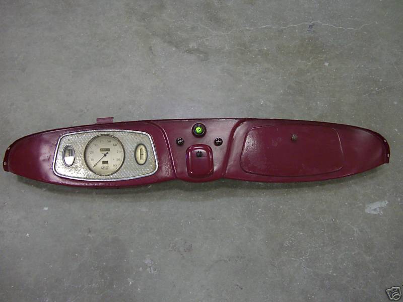

    Here is a picture of a 33 Roadster dash.
    The differance is that the gauges can be moved right to left.
    Otherwise its the sam as a 34.
