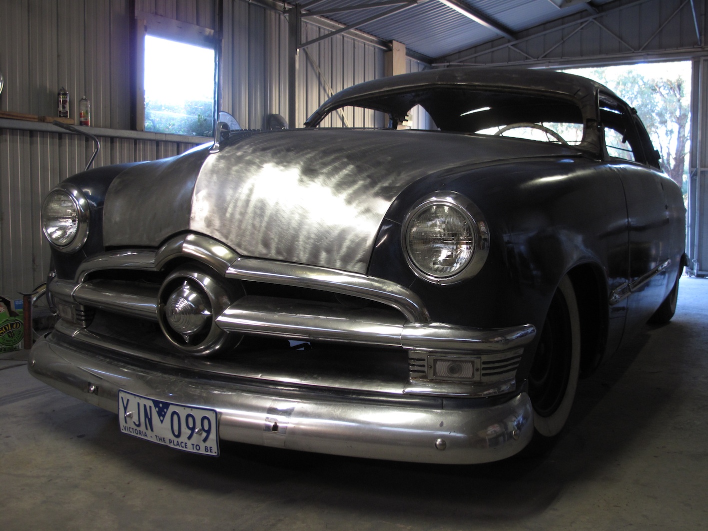

  10. plently of people veiwing the thread but not many comments, wouldnt mind some feed back, good or bad ha ha ha just not too bad ha ha
  11. Hey bud, U know i was a fan of the coupe unchopped. However the chop here is just bitchin. The proportions r great. keep the pic coming. Whats next?
    The raw finish on the bonnet is a winner !!

    Nothing Bad about it! You guys are doing a great job and so far looks like you're handling every stage very well! Have been reading your progress.
    I met Tex's dad at the FUEL mag shindig last weekend and we were talking, hope to meet you guys and see it in person at Chopped (and Tex's dad's cummins powered monster)

  14. ha ha thanks mate, yeah i look back at it now unchopped and it looks so different i like them unchopped to but i am turned now, maybe i am bias a bit though.
    yeah bonnet looks real cool. next week keep working on the roof and ill keep doin other engine bits and keep the car rollin along for the next three weeks then there will be a 4 week break while i holiday it up accross the united states then it will be full steam ahead towards chopped, and ill be able to through some money at it after the trip too which will certainly get me a few thing like firestone rags, gloss black rims, paint the flatty and get all that running again, drop spindles, frenched headlights and tail lights, and other fun stuff.
