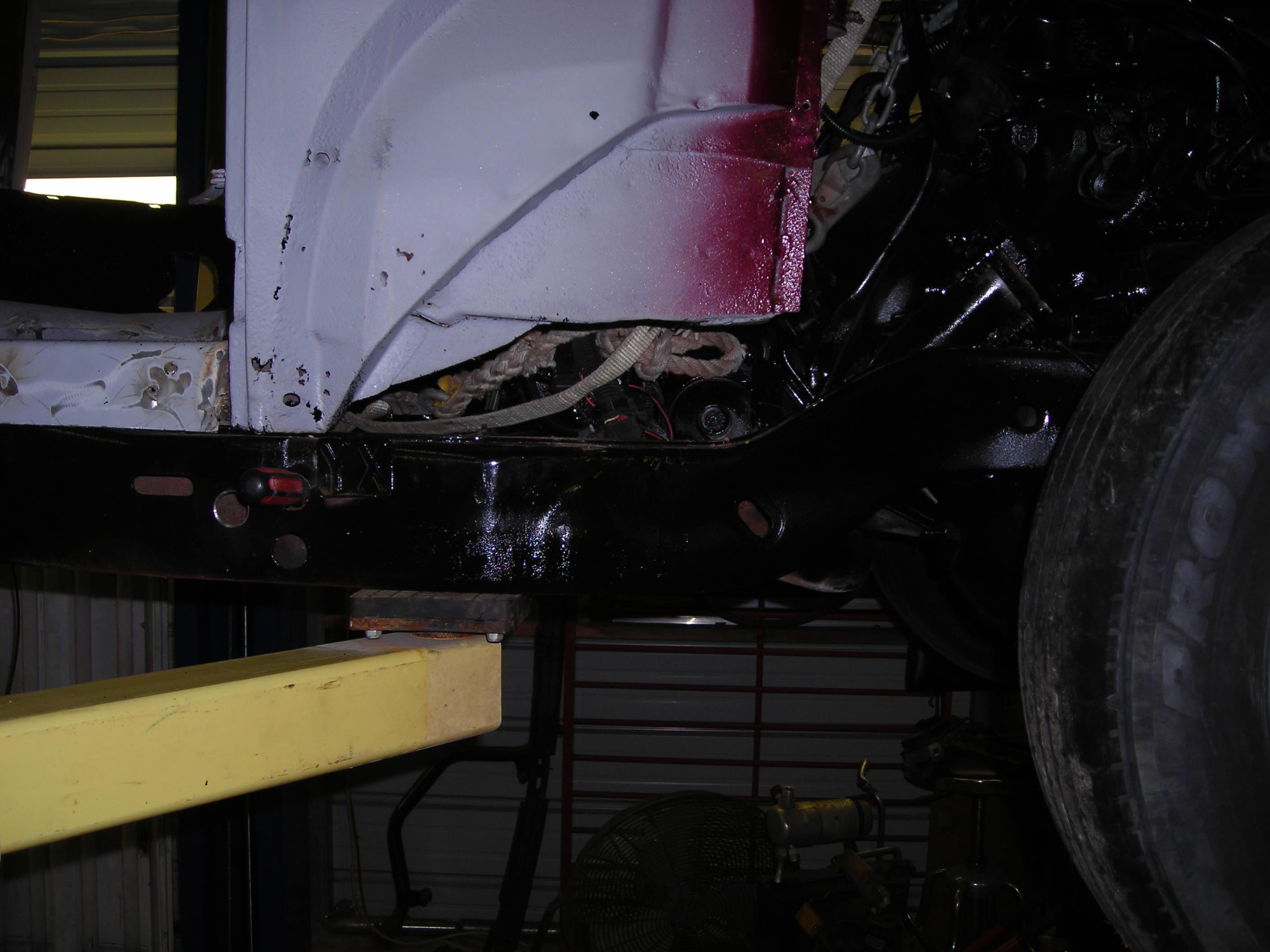

    One problem that is major on the older cars and trucks (pre 1941) is that the frame is too wide up toward the front door post. Causing you problems for the body to sit down properly. I did the frame change on my 1940 Sedan and wasnt too bad except for the afore mentioned problem. Now i will have to cut the frame in a way that i can narrow it to allow for the body to sit down lower. You have a problem also with the trans cover plate. It will have to be altered cause it sits right on the transmission of an automatic. Had i known all this when i was shortening my frame i would have just straightened it then. http://gemsprojects.shutterfly.com/
  24. gmelton
    Joined: Mar 23, 2009
    Posts: 12
    gmelton
    from Monroe, LA
    Thats a radical front end but nice.
  25. gmelton
    Posts: 12
    gmelton
    from Monroe, LA
    As you can see on the Jute, he had to support the front with a built up piece to hold the body. you can see how the door post also came out to the frame edge, so there is the problem. It wont go down any lower until you cut the curve out of the frame up front. Maybe an other mini truck frame would be better but i cant find any photos of the other trucks. I am told Isuzu has a straighter frame. I dont know that for sure though.

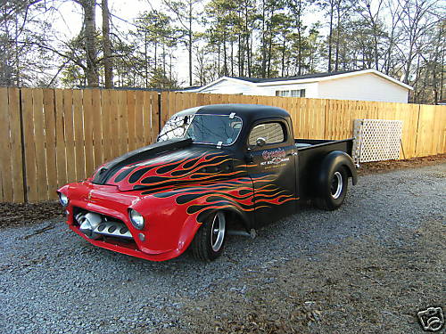

    Just finished (well, sort of) my 52 dodge on a 94 S10 chassis. It was fairly easy, had some help from a few buddies. Got this thing completely switched over in less than 2 months, drove it from Indy to Decatur, Ill (and back) for the pileup, with no real problems.
    BTW, I'm running a 4.3 with an NV3500 trans. Its fun running through the gears!!
    I have pics on another camera, I'll try to post those up later. Just thought you guys would like to see a finished pic.
    Thanks again!

    Looks cool, I like how it sits nice and low,
    great job Eagletucky!!
    thanks for the pic..
    exactly the stance I'm lookin to achieve with my 41 Chevy truck,,
