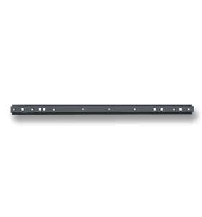

    today i have bought in the netherlands new Bed side pannels with zincor from this person:
    http://pick-up-parts.com/
    these panel sides where with a small failure in it so i have paid a good low price..:D
    here is some info what Zincor®) is:
    Electro-galvanized Steel: Many of the sheet metal parts pick-up-parts manufactures including tailgates, front bed panels, bed sides and cross sills are made of electro-galvanized steel (Zincor®)
    The thickness of our sheet metal is 1.5 mm. (Compare that with others!)
    Zincor® is coated by electrodeposition on both sides with a pure zinc layer.
    This coating is characterised by the uniformity and the regularity of its thickness.
    There are several reason for selecting this steel for our products:
    1. Zincor® is clean and dry.
    2. Zincor® has a good resistance to corrosion during our processing and while on the shelf.
    3. It has also an excellent weldability, due to the uniformity and regularity of the zinc coating.
    4. Electrogalvanised products are an excellent substrate for painting, both in terms of adhesion and appearance.
    5. After the parts are painted, the zinc under the paint helps prevent loss of paint adhesion or rusting if the paint surface is scratched or damaged.

    Hey Jason,
    i wish it was so easy.. this man has made everything him self and want to keep it that way ..he does not want to share the dimensions i have told him i want to make it from stainless steel....
  22. Abomination
    Joined: Oct 5, 2006
    Posts: 6,772
    Abomination
    LOL!
    Probably should've left out that last part about making it yourself. :D
    Email LMC Truck. They actually sell reproduction cross sills. There are three types, a front, a rear and a couple center ones.
    Here's the page from their catalog, so you know what part number to refer to:
    http://www.lmctruck.com/ICATALOG/CA/full.aspx?Page=26
    You should be able to find a link to an email address on their site. Also, they are local to me - if you do decide you want to order a bunch of stuff from the USA, I have the ability to actually drive out there on my lunch break and pick things up for you. I could package all the things you bought from all the different companies, and ship them as one big lot.
    ~Jason
