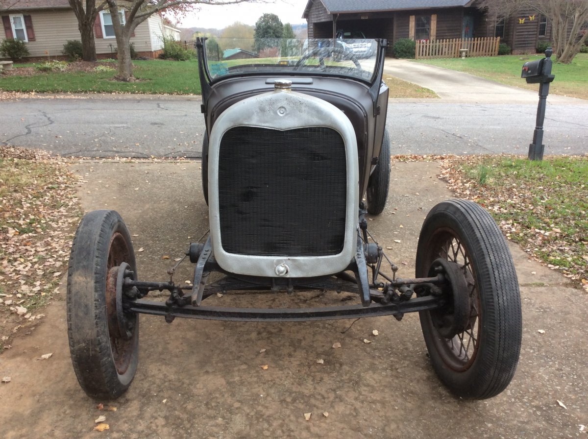

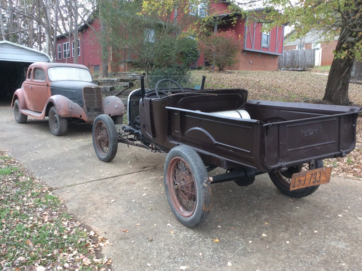

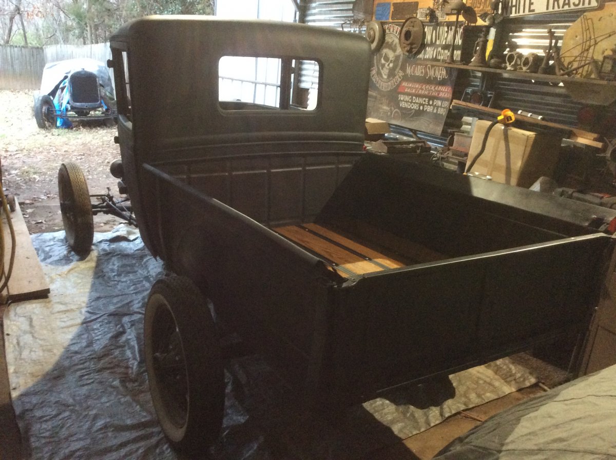

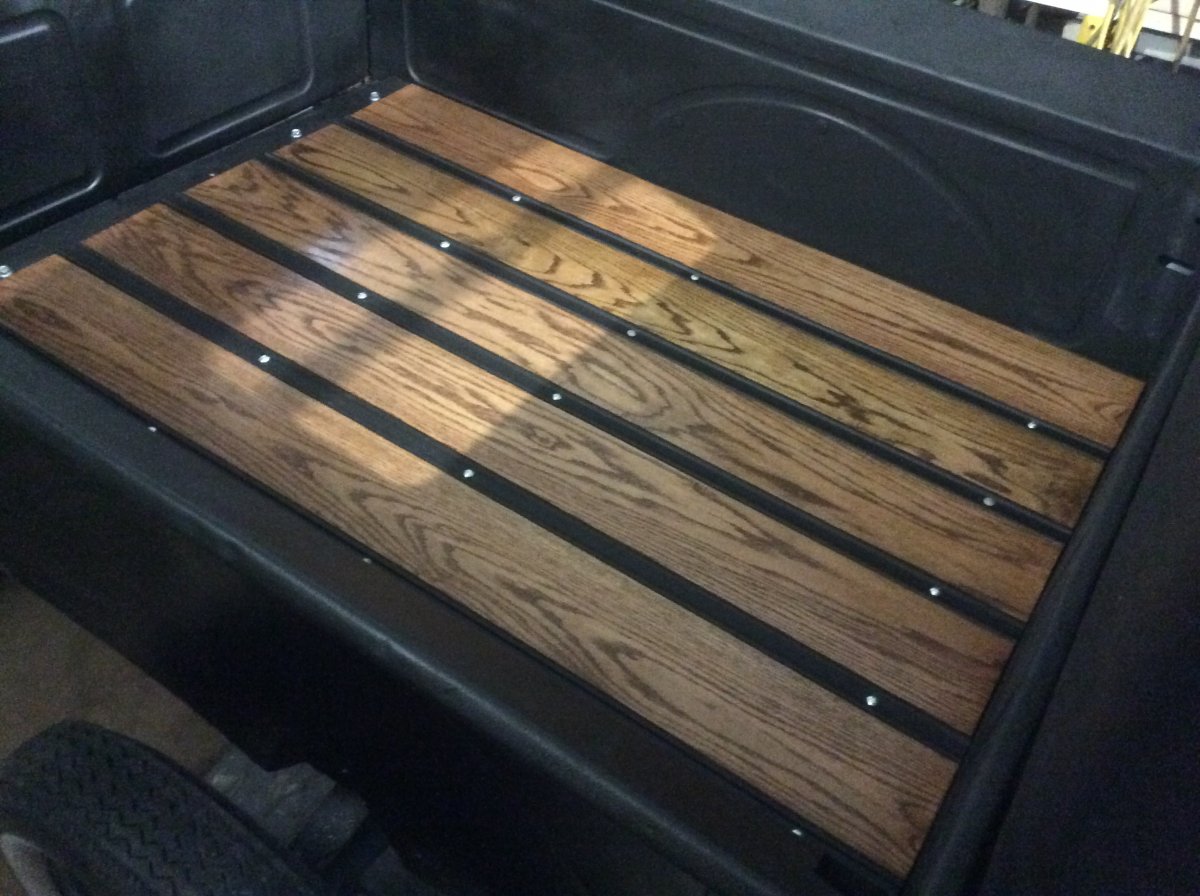

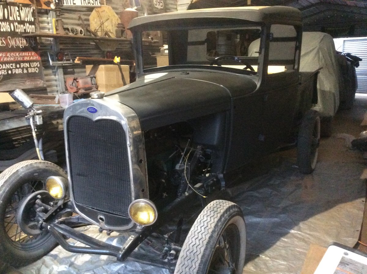

    8B54316C-DEE0-42AE-AF7E-3CC1F8C7BA22.jpeg E51847AB-308D-4DC6-AF7E-2C72B3E3BFBE.jpeg 4C29EF53-DC05-4524-B48B-36A5ECC3FC58.jpeg AF4304CC-8283-4877-AF71-7ADEF40D7FFA.jpeg 88CDE6C1-D309-4E6C-AFDC-E4FF46E62FC9.jpeg Checking in for the month...I got my 2nd banger powered ride about finished...fenderless 31 widebed pickup ....I swapped my 26 rpu onto a 28/29 chassis and put the truck body on the 30/31 chassis I’ve been driving around for the last 2 years...

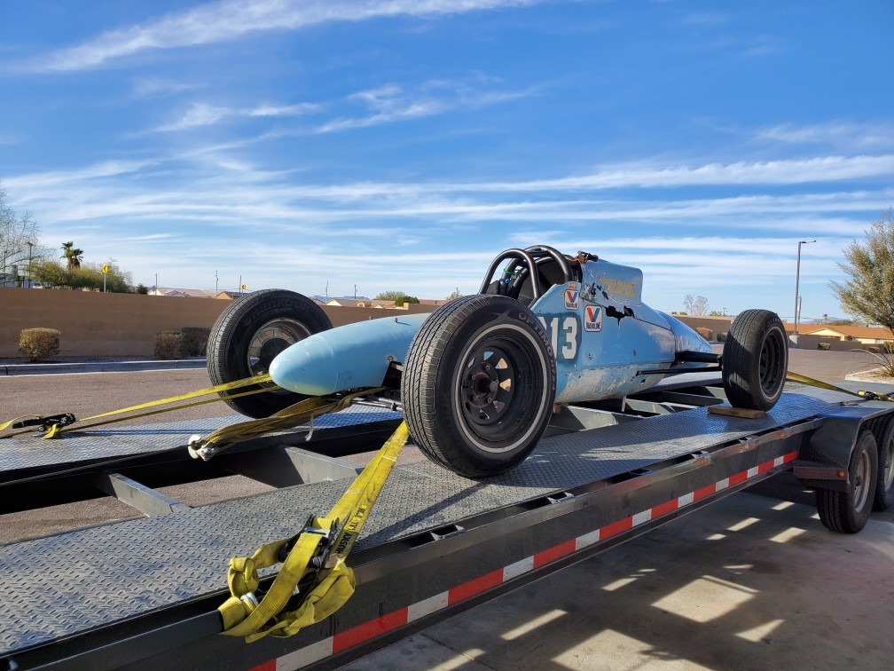

    I have the Dan Iandola/ Jim Brierley lakester on it's way to me in Maryland. I am looking for more old photos and information on the car. I will be building another banger for it. I am not sure what all it's future will hold. I have never even been to Bonneville but I hope to take the car back there this year. Lakester.jpg

    Run the lakester at Loring ME this summer. Summer meet in July. Timed at 1 mile and
    1 1/2 mile. See LTA site on HAMB.

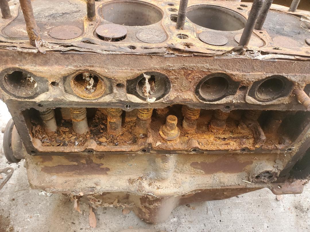

  18. railcarmover
    Joined: Apr 30, 2017
    Posts: 777
    railcarmover
    Little acetone and ATF,good to go. Aint worried about the chunks,once its running they'll find a home.
    Actually I see travel to the Orient in that engines future..it will come back home as a kia
    Jet96 and Old Dawg like this.
  19. V4F
    Joined: Aug 8, 2008
    Posts: 4,382
    V4F
    from middle ca.
    is this one of those "It'll buff out" , trust me

    I get pictures of Dan's lakester at Pat Gary's. He worked on the engine, and also got Dan's Yellow A roadster pickup

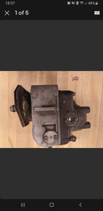

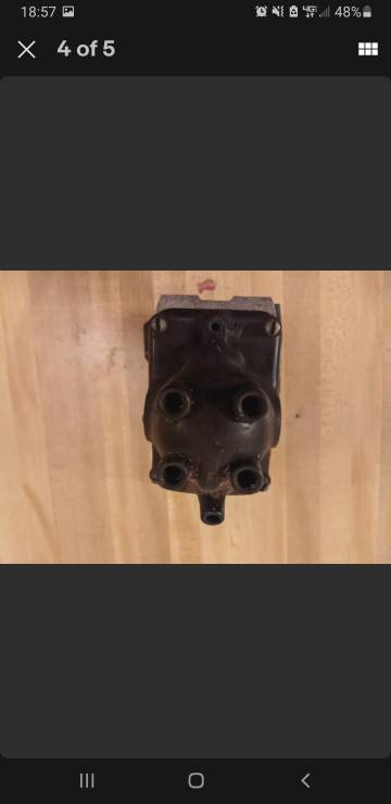

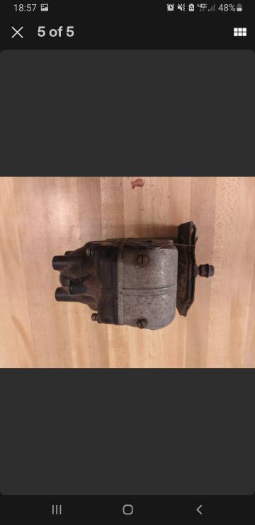

  24. Need advice over accessory magnetos. My 1917 speedster build is getting an accessory magneto, need tips if anyone has done it. Screenshot_20201228-185728_eBay.jpeg Screenshot_20201228-185724_eBay.jpeg Screenshot_20201228-185712_eBay.jpeg

    I have used the model MJ series American Bosch mags on model A and B engines. I prefer the MJC model for it's smaller size. Here is a link to some literature on them : https://oldcroak.com/catalog-american-bosch-magneto-1945/
    Make sure you get one with the impulse drive. There are base mount and flange mount versions. try to get one with the timing adjust lever.
    Leon Sandcastle likes this.
  26. Kevin Pharis
    Joined: Aug 22, 2020
    Posts: 515
    Kevin Pharis
    I’m no expert... but I believe your mag is a later 30’s tractor mag. You may have better luck finding a rebuilder than you would with the earlier style T era mags. What mag drive do you have...? Colombo? Matco? Eismann? Side drive? Cross drive? Chain drive? Etc...? Most (if not all) T era mags used a standard mounting configuration... your mag could vary if it’s too modern.
    I had a Matco cross drive on my ‘ol roadster, and have participated in Bosch side drive, Bosch generator mount, and Columbo mag drives as well. Some mag drives can be a challenge to get the drive gears to mesh properly. Don’t assume that the mag drive “fits”... take the time to ensure that the gears are set up properly
    Old Dawg and Leon Sandcastle like this.
  27. Its the American Bosch MRD 4A 10... they said it came off a running Massey from the later 30's. Kept trying to get a nos wico but the guy didn't want to sell because I showed interest in it... hate those types.

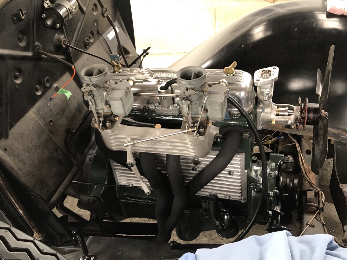

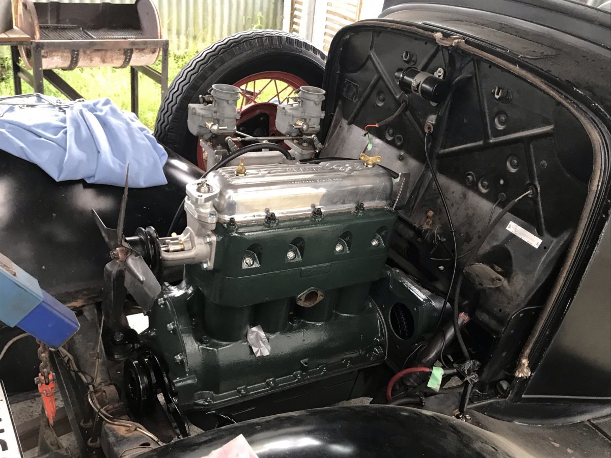

    Its finally back where it belongs , should be running this year , but this year is fast running out. We did notice the new V8 9” clutch is not engaging as it has way too much free play , so by the looks of it we need a longer push rod to take up the free play , is this normal ? We have made our own thermostat housing to locate a thermostat securely and make adjustment to temp levels easier. It runs a semi hidden pcv valve in the back of the rocker cover.
