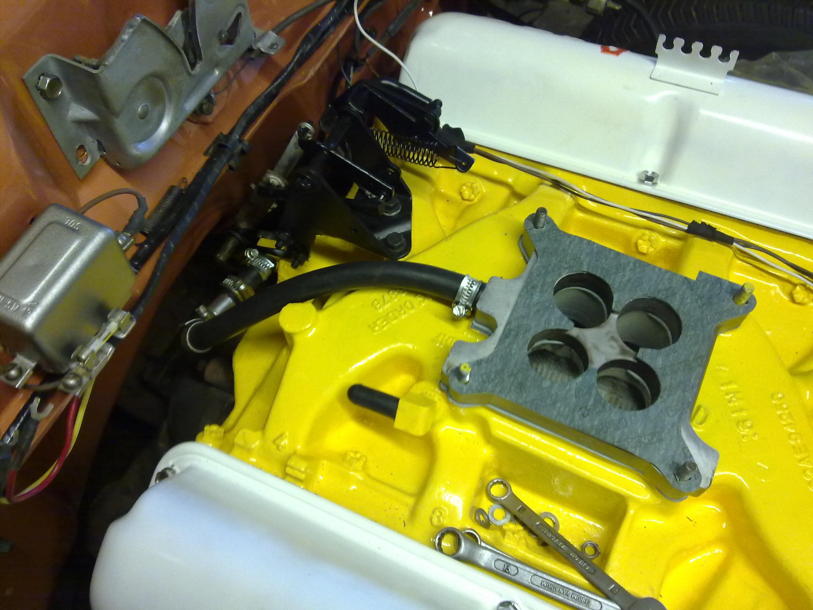

    You know I love the hamb but the pcv threads seem to be the worst. I read through 100 or so pcv threads that all end with everyone begging for part #s from the guys that post positive results but can’t seem to ever tell the rest of us what part number PCV valve was used.
    I just got a 63 C-10 with an SBC which is my initiation to the world of SBC’s where you can buy dress-up parts next to the air fresheners and floor mats in the chain store. Mine came with the crappy chrome air cleaner, valve covers and breathers with the big ERSON letters stamped on them. I hate to picture the day the PO bought this stuff and probably threw away the stock parts.
    I want to run basic painted chevy script valve covers. So here is my solution-
    Edelbrock makes an eps manifold with a breather tube on the front- part number 7003.I ground off all of the logos and a needle scaler to try and somewhat match the sand-cast texture.
    I hole sawed a ¾” hole into the valley area of the intake. You’ll see where I ground off some of the casting to get a flat spot.
    Then I went to the hardware store and picked up a ½” fip fitting and a 3/8” fip to ½” mip bushing- this clamps together at the intake hole. The bushing is just a plumbing fitting but I ground the hex into a circle so that it doesn’t look like a plumbing fitting.
    Then I needed to make a baffle. I have seen a lot of welded plates etc but also lots of reports that they still suck oil out of the valley. I was thinking about duplicating the baffle in my olds motor which works well and is like a metal soup can stuffed with copper screen. Then I realized that the crappy chrome ERSON breather could be modified to work the same way. I cut the neck off of it and stuffed it with copper pot scrubber and welded the ½” fip fitting into it an drilled holes in the top (which will now be the bottom) so it will drain any oil it sucks in. Who says chrome won’t get you home?
    It is installed with jbweld in the threads so the bushing seals it tight and will not come loose.
    On the top side I screwed in a 90 degree barb and I used a Fram PV 112. . . . it has a ¼” barb on one end and a 3/8” on the other end. It runs to the base of the Holley on the front barb below the plates.
    I hope this helps to end the madness and saves someone some time.

    Though, isn't it a short circuit air flow, only going from one end of the valley to the other? Whereas in 1 valve cover and out the other passes down thru the crankcase.

    My only problem is there doesn't seem to be a path through the engine for the air to take. Unless I'm missing something, the air will just go down the oil fill tube into the valley and then just go out through the PCV valve right next to it. Most PVC systems are in different valve covers to pull the fresh air though the engine removing fumes and moisture. In the HVAC industry this is known as short cycling. The warm or cool air never reaches the spots where it is needed.

    That's the whole idea though- to NOT vent the valve covers so you can run closed early-style covers.
    It just vents the valley like a road draft system does. In through the filler tube at the front and out through the pcv at the back. Road draft systems are messy but effective, hopefully this is cleaner and also effective.

    I would think the moroso lifter valley baffle does nothing to separate oil out of the air. There are a few threads with plate type baffles - even right up under the intake lid - but they always seem to end up reporting that they are sucking oil in with the air.
    thats what I gathered anyway. . .
    I have a few hundred miles on mine running a clear hose and it all looks clean so far. . . but still watching it.

    Here is how i did it & oil fill cap is vented.
