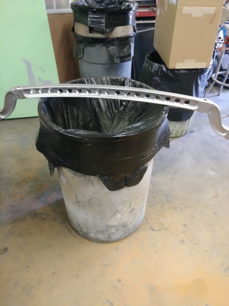

  18. Started to clean up the frount axle knocking down the seams the will drill 12 1"holes
    brEad, kidcampbell71, dwollam and 3 others like this.
  19. Got the axle cleaned up no more casting lines or pitting.
    Tomarrow it will be time to drill about13 1" holes then I can paint it

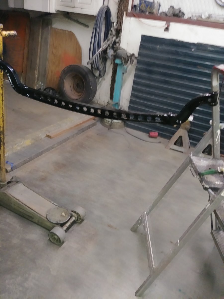

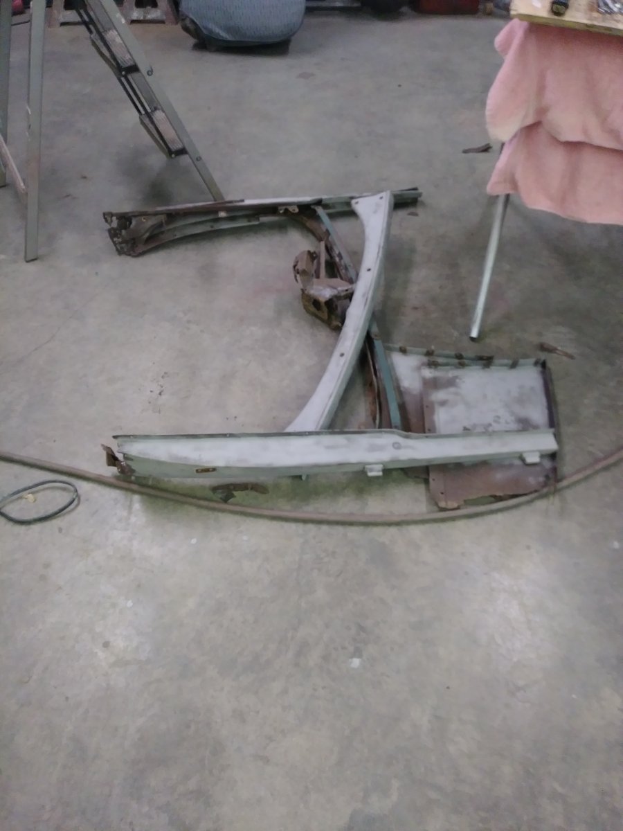

  24. Finley got the holes done17 one inch.
    Started the first collars black then in a few days some dark red

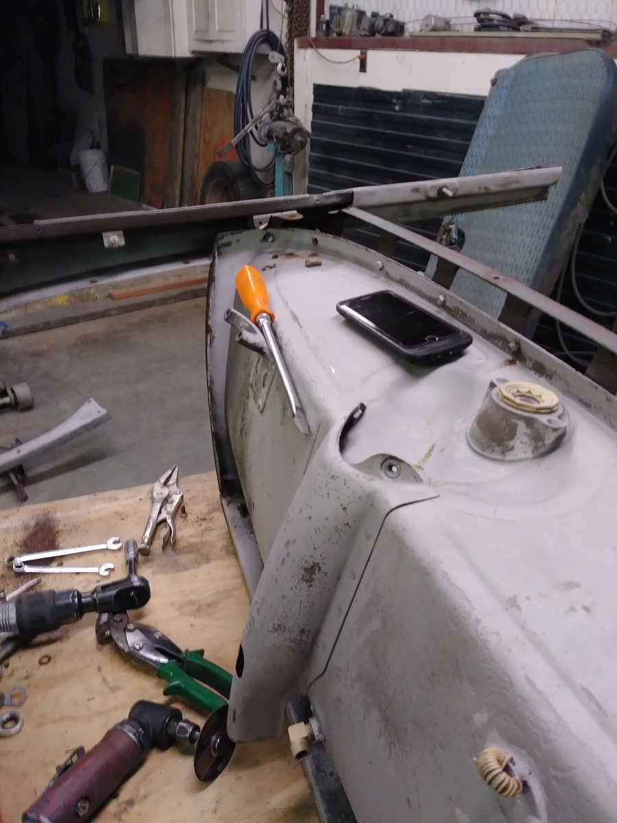

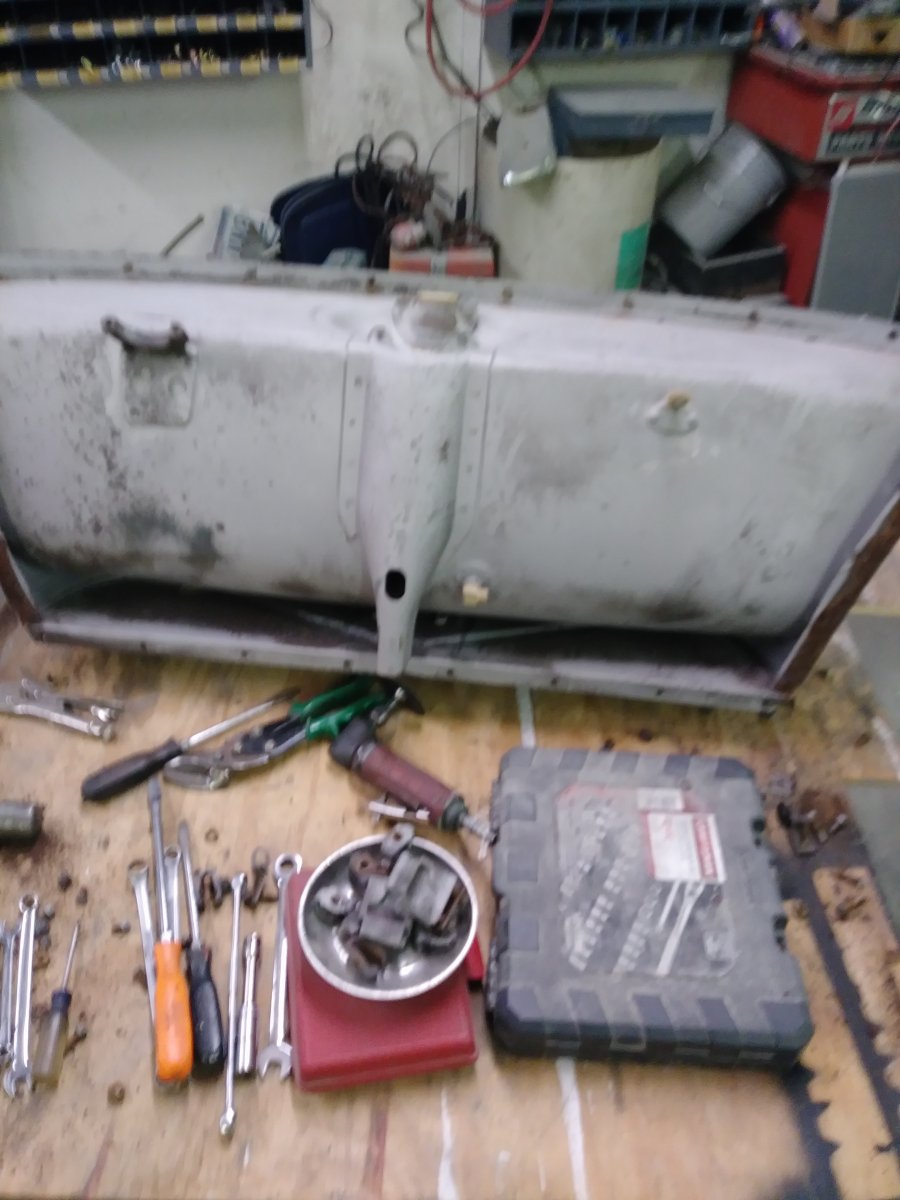

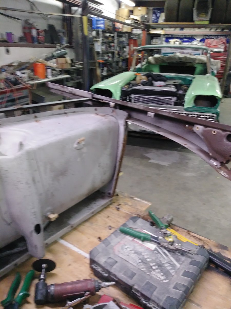

    Glen came by free labor put him to work pulling the cowl apart
    Will need to build some lower patch panels
    Gas tank look solid and clean in sidemy use it.
    Now just a pile of parts that will fit in the bead blasting cabinet
    brEad and Okie Pete like this.

  26. Yep he Wil be back Tue to bead blast the parts.than its time to build patch panels.
    Cowl was from a sedan. May leave5-6" of windshield posts. But have not decided yet.
