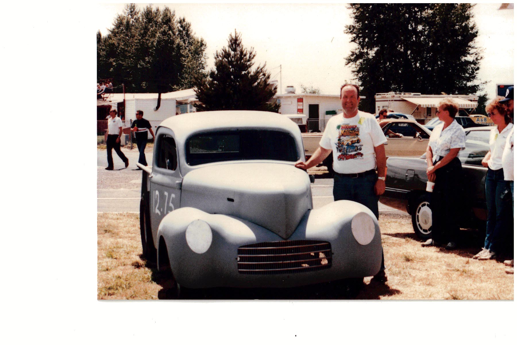

  1. Here's a couple pic's of my modern day nostalgia gasser. 57' Olds engine, Isky roller, six Holley 94's, Ross aluminum heads.

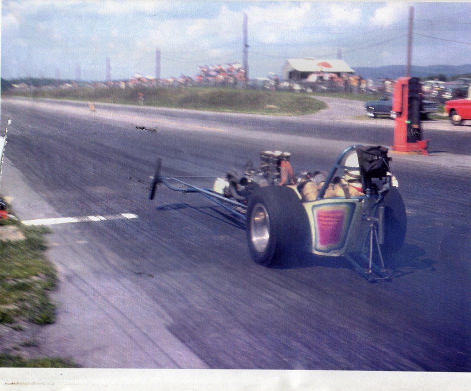

    Here's the car I'm building...

    Beautiful ride voxnut. Tell us the build details.

    Thanks for asking! It's King Chassis with 4 extra inches behind the rear axle in order to get the 5-point roll cage angle what it was back in the early 60's with the 3-point. 135" wheelbase, 327 chevy with 1.94 heads with some bowl work, pink rods, Keith Black 11:1 pistons, will have a Schneider 299 cam, shorty headers, 1966 Hilborn 2 1/16" alky injector setup, vertex magneto. Estimated 425 HP, car weight 1200 lbs. Engine 31" out. Budget (lack of one) dictates a shorty powerglide for now at least. After I get seat time, if I hit the lottery perhaps a 2-disk clutch will take it's place. I'm in NHRA land with no outlaw tracks anywhere nearby, so it has to cert, which means $$$$. The plan is to launch in high gear from idle. No trans brake. That, combined with 3:55 gears in the Mopar 8 3/4 rear, and the weight box up front between the frame rails, should negate the need for a wheelie bar. I know the 60 foot times will be soft, but this is more hot rod than serious race car. It's important that it looks like a cackle car that can make passes. Shooting for the mid to low 9's. If I ever want to do some actual racing rather than fun runs, I figure it will be an NE 3 car on a 9.60 index.
    I know the car would have more in it, but I don't know if my budget ever will. ET III 10 x15 wheels out back with M&H 10.5 x 30 tires. In the future I'll switch to a 9 x 30 slick. 17" Hayden front hoops with Chen Shin Avon copies up front. Currently broke and looking for the cheapest shorty powerglide I can find along with a 9 or 10" converter with a 4500 stall speed.
    I've been blogging the build at http://rocinanteridesagain.wordpress.com
    Here's another view:

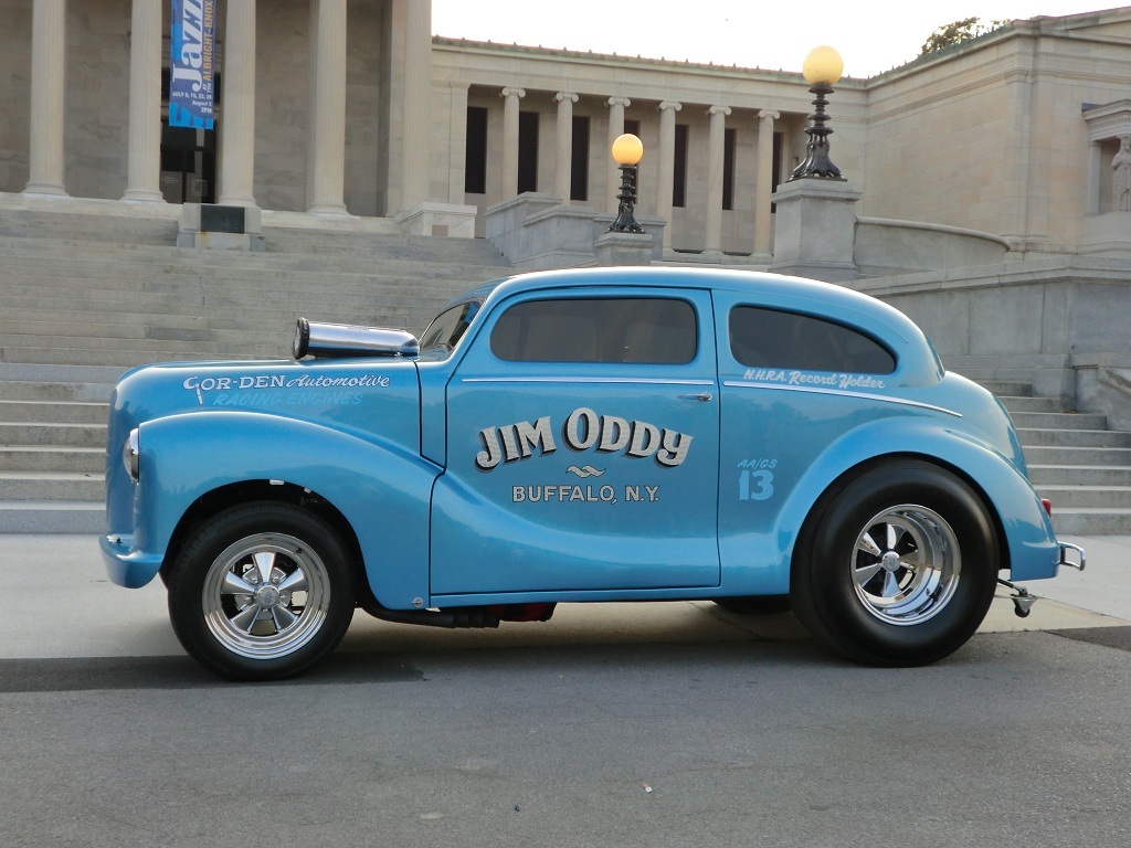

    2012 Oddy Austin
