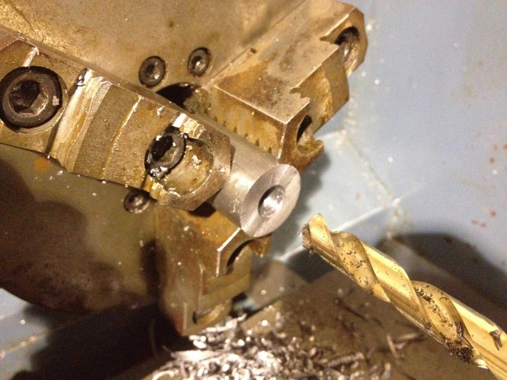

    I definitely wouldn't count on tapping a frame to survive when supporting a shock mount. Nor would I use a nutsert as it simply won't last. While a method I use may be considered overkill, I doubt I will ever have to repair it later on. I take solid bar stock 1" or 1.25" for a 3/8" or 1/2" bolt...cut it one frame side thickness shy of the frame width, then bore & tap the bar stock deep enough to accept the bolt.
    Next, I drill a 1/2" pilot hole through the frame. Next, the front face hole is enlarged 1/8" larger than the bar stock. Then I attach the stock to the shock mount (or whatever I'm attaching to the frame...running board bracket, crossmember, radiator support, brake pedal mount, etc...these pictures are from a bumper bracket install) and then slide into the enlarged holes.
    Align the part with the bar stock with the outside edge even with the frame side...and then secure with a C-clamp.
    Next, weld up the backside hole which will be flush with the stock because the bar is one frame side width short.
    Finally, remove the attached component and weld up the front side being careful to not damage the threads (I simply spray a sacrificial bolt with anti-spatter and thread into the bar stock to protect the threads). Finally I grind down the welds and call it done.
    I like using this method for several reasons. First it's very strong (since welded on the front and backside) and like I mentioned earlier...it won't require repair in the future. Second, no unnecessary holes or access is required from the backside. And finally, disassembly or re-assembly can be done by one person since you don't need a socket or wrench on the backside. This is worth the effort later on when your working alone without somebody else to hold a wrench on the backside.
    Hope this helps.
