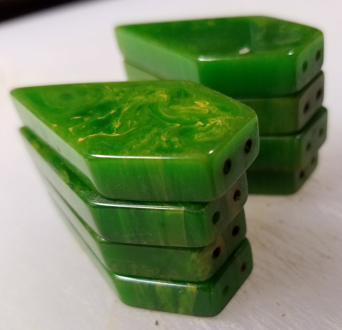

    I've got a few friends that are serious scroungers and one found these bakelite handles on some old art deco small kitchen appliances. They're mine now. They measure about 1 7/8 inches long. They need to be drilled and tapped but I think they'll look really cool in a custom or rod. Anyone else got any 20161211_155158 (2).jpg 20161211_155303 (2).jpg 20161211_155350 (2).jpg neat dash knobs?

    Not exactly sure. I'll find out tomorrow.

    Those green knobs are cool. I can almost design a complete car around them.
  9. Oh man, those are awesome.

    Those are made out of Catalin Plastic. In the 30's and 40's, a decorative plastic was created by casting different color phenolic plastics and adding colors of swirls in them. This created these unique patterns. They were use in silverware handles, drawer pulls, jewelry, and old radios.

    raprap is correct. Bakelight is often used to describe any plastics from the first half of the 1900's. Bakelight is dark brown, those SW radio knobs and old house switches are no dought bakelight. I use to correct antique radios, they had a lot of experimenting with plastics back then, some like the OP's knobs were really cool looking but a lot of it was very fragile.
  12. Agree with last two posts. Still cool as hell though. Bakelite did come in other colors but brown was the most common.

    OK, got the scoop. These were actually corn cob holders. Makes sense with the 2 small holes. BUT...they are bakelite (and that's how it is spelled). I have been an antiques dealer for more than 30 years. The guy that found these was a furniture design teacher who specialized in 30's to mid century design. He knows bakelite. If there is any doubt, google green bakelite and you'll see plenty of swirled examples, mostly jewelry. Bakelite does get brittle so it has to be drilled slowly. I too almost feel like they are cool enough to design an interior around.....

    Man, would I like a set of those green/yellow holders for sw knobs (which is a great idea!) I got a couple of Stude speedsters, awaiting attention, that are lemon/lime. The colors in those are better than stock. & since the cars won't be... :D .
    Thanks for the ID. Guess a lot of searching is in my near future.
    & since bakelite is brittle, I think I'd use a Dremel Moto-tool with very small dental-type bits to start & just increase the shaft hole size enough to epoxy in either threaded fasteners or a thick-wall brass tube that could hold a mini-set-screw.
    As an alternative, I could see casting these up in plastic (like, say, from Smooth-On), but getting the neat swirl-effect could be a challenge - not to mention maintaining separation of the colors. Hmmm ???

  20. Never would have guessed "corn holders".
    Cool

  22. Those are way cool, dig that shade of green too

  26. Hey I believe you. They just look like Lucite in the pics. A good test is to put 409 on a swab and rub the back end where the holes are. If the swab turns a yellowish color its Bakelite. Simichrome polish is also used to test it. You can also run one under hot water and it will give off a kind of sweet resin like smell. Regular plastic will not do this.
    I know a lady that deals in Bakelite jewelry. I had to go through my Mom's stuff and she schooled me on it. Certain colors bring big bucks. They have what they call end of day colors which are a mixture of what was left over and are sought after.
