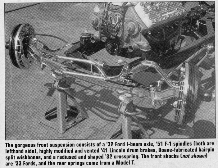

  3. I didn’t mean to derail the thread here, just thought it was interesting what happened.
    Anyway, I find it difficult to get a box in the optimal location so that the pitman arm isn’t too long and in the right spot all the while not totally obliterating the already crowded foot space. That’s the main issue.
    Moving the box up solves the space issue and then creates the parallelogram problem and long pitman arms.
    I’ve certainly never got to drive Doane Spencer’s roadster, nor have I ever heard anyone say it’s horrible to drive with unruly bump steer .
    Maybe they have and I missed it.
    It’s a fun thing to copy though and nice to look at.

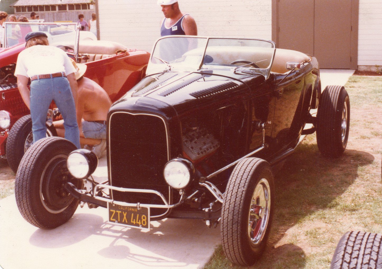

    upload_2023-9-16_6-51-37.png I always read these cowl steering threads with interest. I have a 8 to 1 midget box. Norm Rapp in South SF used to sell these boxes for $275 used 25 years ago. Back then I did it for many reasons. Doane Spencer’s car had it, Race cars had it, it was actually somewhat affordable and I thought it looked really cool. I slowed the steering ratio a bit with a shorter pitman arm and made a longer steering arm on the spindle like the Spencer 32. I added extra caster for the quick ratio, around 7.5 degrees.I wanted the drag link to sit parallel with the wishbone for aesthetics and I thought it would decrease bumpsteer. It doesn’t. Eastwood is 100% correct. When driving on the highway I really don’t notice it. Steering effort is much higher than a traditional steering box. A buggy spring may only have about 3” of travel but when you come out of a driveway at an angle and the spring pivots side to side the steering wheel really moves around. If I understood bumpsteer geometry in my 20’s better maybe I would’ve built something different. Recently I’ve thought of an imposter set up. Dummy aluminum drag link and a bearing supported pitman arm. Then run a early Ford cross steering box on the frame.

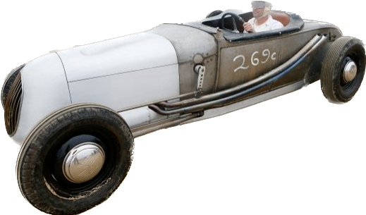

  20. Have seen it. This sedan is set up like that.
    Pat likes this.
