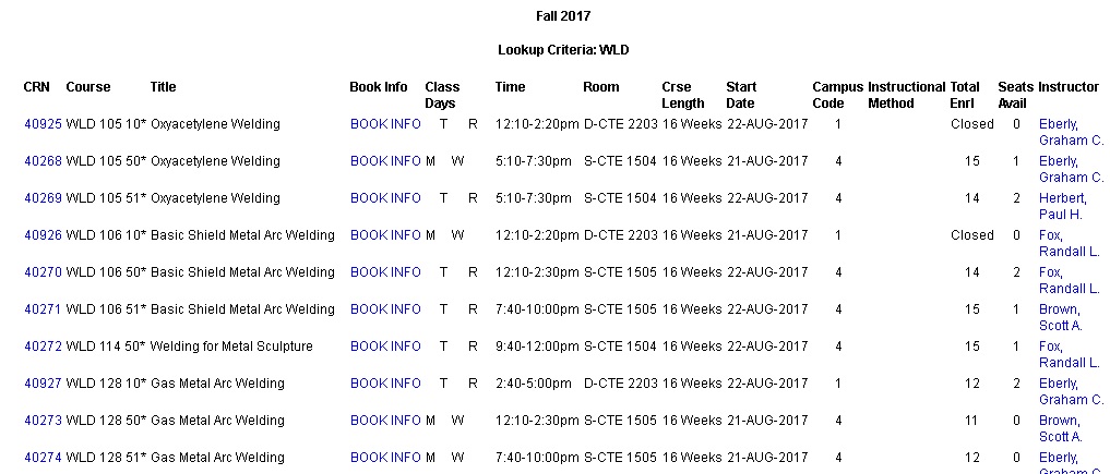

    huh...I took a few welding classes at the community college, years ago, it was dirt cheap. You don't need to become a certified pipeline welder to fix your floor pans. But you do need to know the basics. keep looking!

  27. @squirrel The local JC here has classes, but they are accelerated I guess, 4 nights a week. With a full time job and kids, that's just not possible. I could do two nights though like the schedule you showed.
