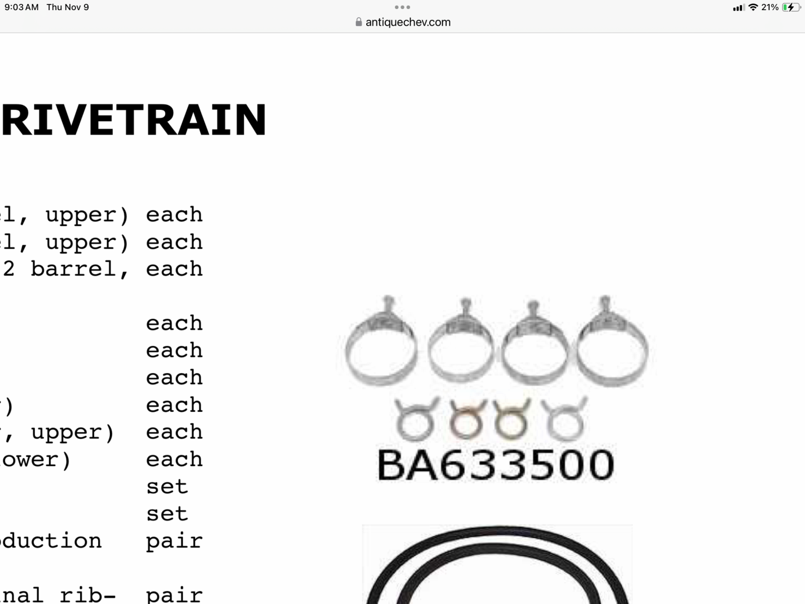

  3. nochop
    Joined: Nov 13, 2005
    Posts: 3,925
    nochop
    from norcal
