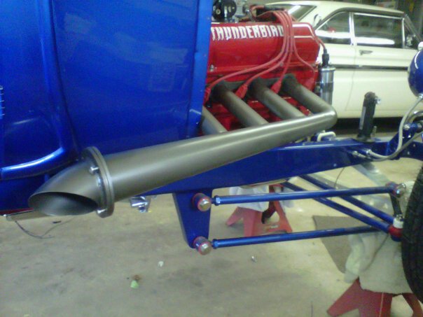

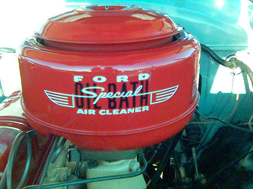

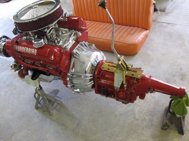

    heres mine ! made adapters to run fe valve covers ! converting a oil bath air cleaner to paper at the moment and gonna paint to match and do away w the open element to give it a better look !

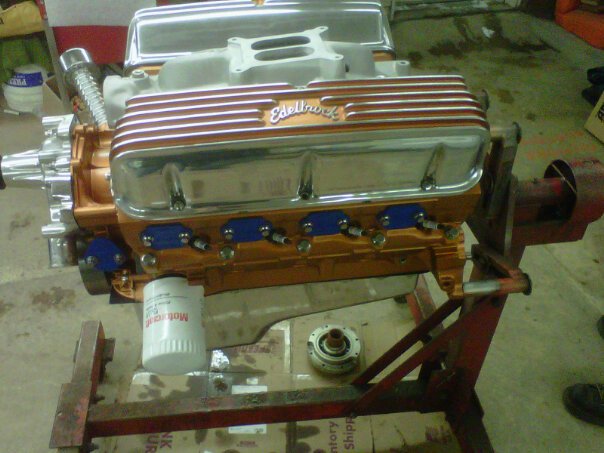

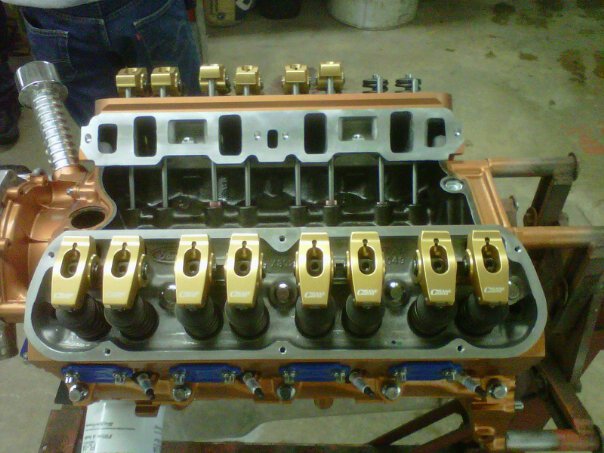

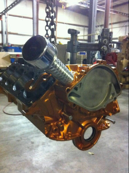

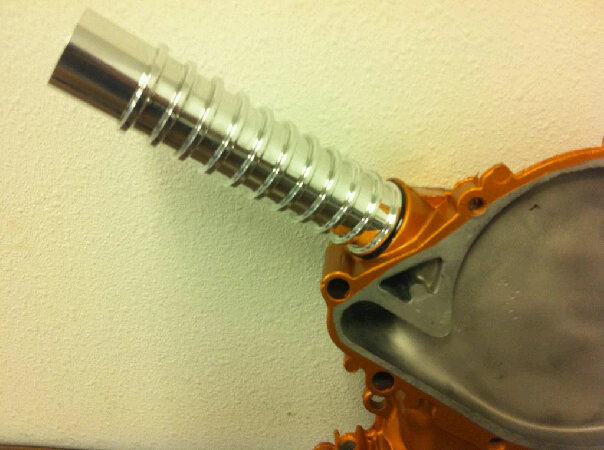

    heres another i did for a friend ! we used finned edelbrock valve covers and painted them ! used an early 260 timing cover and machined our own oil fill tube to match , finned oil pan ! still working on multi carburation

    The guy wants a "Ford in his Ford" but no one comments on a Ford engine painted Chevy orange?!!

    Those look taller than all the others and Im assuming they clear those roller rockers? What are you doing for a breather/PCV? Know what vendor has that set?

    i think they are the newer ones, yes they clear the roller rockers, i believe he bought em through summit ! we ran an early timing cover and drilled the block for the oil fill ! we will put the pcv in the back of the intake into the valley

    huh ? if your refering to either of my pics the first engine is victory red and the second is burnt copper !

    Looks like orange on my computer! Whew, I feel better now (But hey, I'm a Chevy guy anyway....thought all older Fords were blue!)

    Thanks for the info. That a nice looking engine!
