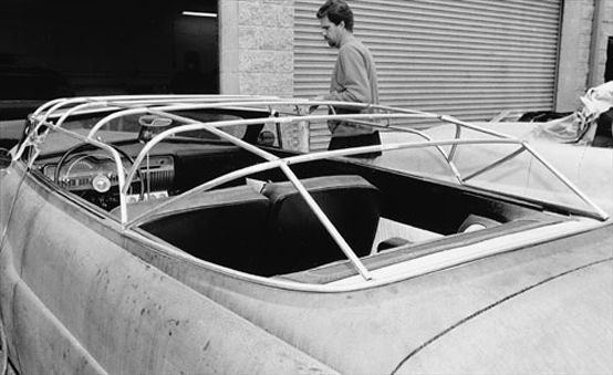

  16. Google "Carson top" and find more info like photos and such.... Carson top frame.jpg

    I have, there was a nice thread here on the H.A.M.B. that's where the Carson top idea started from... the thread didn't give any info on if or how the frame should be stiffened though.
