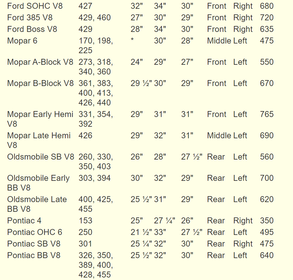

    I came across this chart while looking up how to shove 10lbs of Mopar engine in a 5lb bag of 1960 Ford Falcon. Hopefully it's not a duplicate post. I'd love to have had this info before I started the project, because I didn't realize that an LA was not much bigger than a 144inch Ford 6. Less would have been cut out, lol.
    It would be great if people could add their actual measured results for common mods to these engines, such as:
    1. Flathead/SBC/SBM/Hemi/Yblock/etc. with specific aluminum intakes subtract X lbs, but alloy intake AND alloy heads subtract X/Y lbs...
    2. Mopar long rams add X inches to width...Eddy Myer's intake adds X inches to height...Rat Roaster intake adds X inches,
    3. 4-71, 6-71 adds X inchs High, Y inches long, Zlbs when using Q intake....
    -rick

    The problem with any chart showing engine sizes, is that it doesn't really provide a complete 3d model of the engine, and all it's extremities.

    There’s some interesting figures there. You wouldn’t have thought the big Caddy would only be 25lbs heavier than a SBC or that a 429/460 is that much heavier than an FE.

    Or that a 351W is the same width as a 302. Reader beware.

    I'm pretty sure a ford 300 is more than 1 inch longer than a falcon 6

    probably depends where you measure it, eh? which is the problem with these charts

    As with any such charts, the information they contain needs to be mixed in with previous personal knowledge and observations of other known experts. I've yet to see a casting number chart for small block Chevrolet V8s that didn't contain obvious (to me, anyway) errors; cylinder heads being listed as used from 1957-62, when the valve cover bolt configuration changed in late '59.
