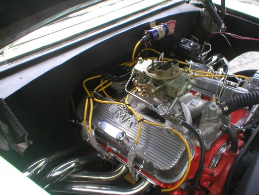

    Thanks bubba...
    I was gonna send you an email on that exact subject...
    I mounted your 4.0 coil sideways...
