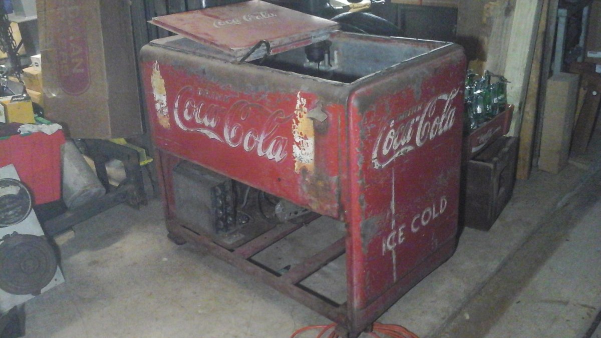

    I've had this one in storage for years, but finally made shop floor space to put it on. We got it when we moved our family business into an old building and it was left behind. It's a 1930's Westinghouse "Master" wet cooler. I want to fully restore it so I can weld up some thru-rust in places, but I'm likely going to settle for patching it up and getting it running for now, then restoring it later.
    1588834870848464613595.jpg 1588834926188586807509.jpg 1588834950855-1617924192.jpg 158883497115352725936.jpg
    After I made the above video, I went ahead and plugged it in and it fired right up! It only ran for a minute before the power cord shorted and tripped the breaker (rotten wire), so new wire, but I was pleasantly supprised! The agitator motor didn't kick on, only the compressor and condesser fan, but that could also be due to the bad wiring. Once it's rewired, I'll let it run longer and see if it still gets cold. I was kicking myself for (re)starting another project, but feel much more optomistic now.
    Any other old cola chests owners on here? Any tips and tricks to get them restored and running? I did find a couple of sites that sell parts for them, but I'll also have to fabricate a couple of missing sheet metal bits.

    I've made a little progress on mine. I cleaned out the basin with CLR, replaced the drain, and sealed all the seams with clear caulking. I filled it up with water and it held pretty well, but there was a couple drips seeping through, so after it dries out, I'll give the seams another pass.
    I've replaced all the wire and now am trying to sort out some shorts in the motors. The wire leads were also cracked and shorting, so I took apart the agitator and fan motors to try to splice in new wire. It's tricky because there's so little room to work and some parts are pressed and formed together. I think I'm going to replace the fan motor with a new one (they're pretty cheap). The agitator I was able to fix and reassemble, but I want to run it for awhile before I fill the thing with water and electricute myself..
    The compressor is another story. It was running fine for awhile while I worked on other issues, but is now shorting and its the kind that dosn't come apart so I can't find where its shorting inside. I might end up cutting it out and soldering in a generic freezer compressor.
    Once the electric is 100% safe (I also plan to add a breaker to it as there's nothing right now so when it shorts, I have to flip a breaker outside), I'm going to get the freon-12 evacuated and recharge the system. I had it running for about 20 minutes, but the coils didn't cool at all and I heard a lot of bubbling in the tubes. The compressor has a little rattle to it too, so it might not even be circulating fluid as it should.
    Still a few unknowns to sort out, but I'm getting closer to giving myself diabeatus via mexican coke.

    I have a 1940 Master box that I have restored but do not have any of the cooling components working. Compressor is missing too many parts to recover its use however I do want to use the water agitator but need to rewire it before I try to run it (frayed insulation). I do not see an obvious way to disassemble the motor. Were you successful in rewiring yous? Suggestions for disassembly?
    Okie Pete and Deuces like this.
  25. 1953naegle
    Joined: Nov 18, 2013
    Posts: 281
    1953naegle
    The tin cap on the top pushes off to reveal the end of the armature, retained with a nut. With that removed, you can carefully press the armature section out and get to the field and wiring connections (very little room to work with in there though).

    Another update on mine. I was able to remove the compressor board assembly and the cooling lines/coils without cutting or major bending, so I'm going to take the assembly to a professional and see if they have any tricks to fix the original compressor. If not I'll let them do the hard part of soldering a new one to the assembly, purging, and recharging the system.
    There's a local appliance store that has lots of antique appliances in the showroom, so I assume they'ed be my best bet to fixing the system. I'm just hoping it's a low $100's job at worst and not a high $1000's job.

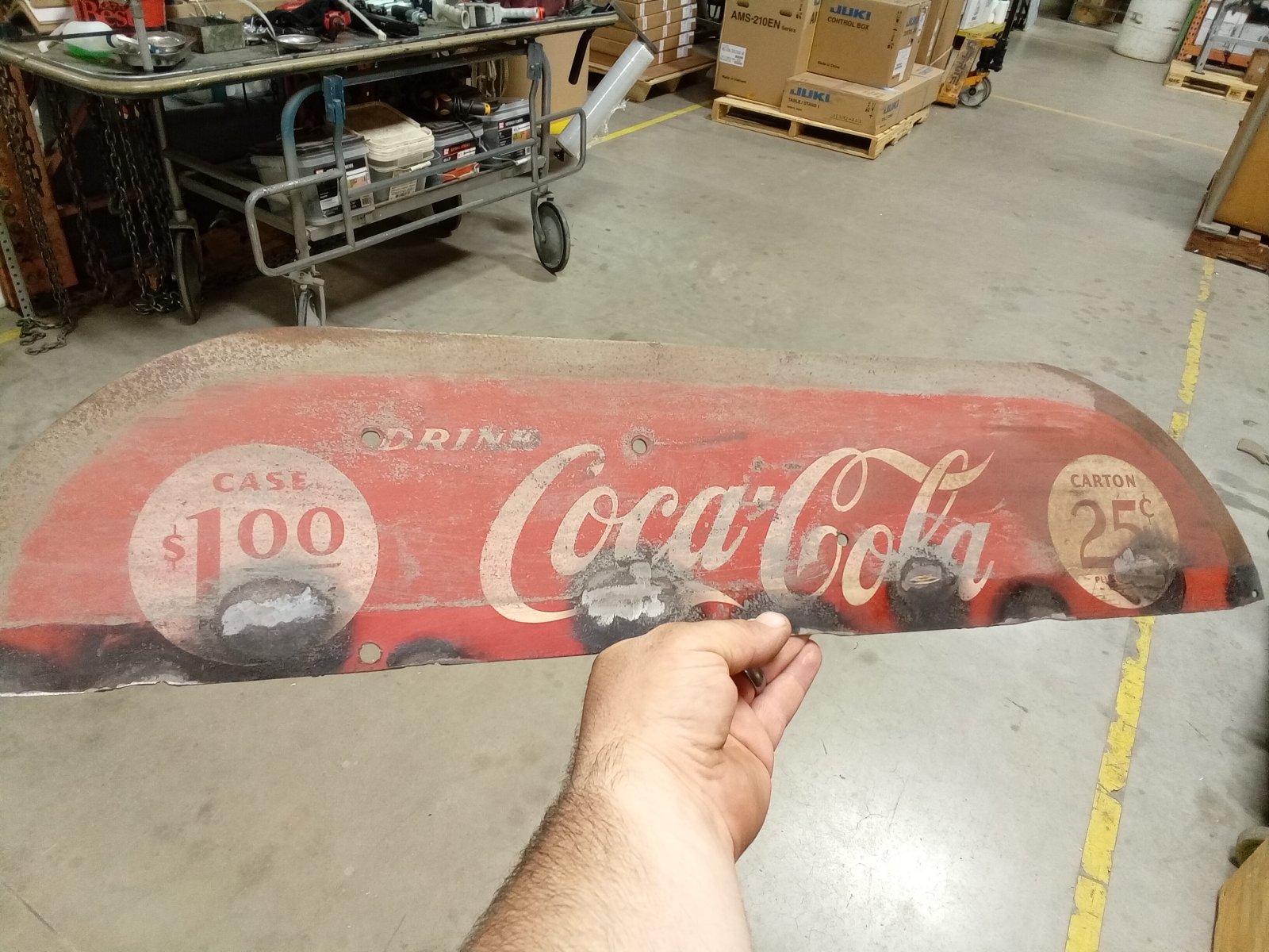

    So I bought another metal lathe recently, and this old coke sign had been welded on and painted over as a belt guard. I did my best to surgically cut it away and cleaned most of the grey paint off, but I can't find anything like it online. It has a maker's stamp on one corner of "C&H Fan Co. Atlanta GA" and it has the same graphic printed on both sides so it would be some kind of 2 sided cooler, just not sure which. Any ideas? I'm thinking it'll fit well with my cooler in the start of this thread, just curious about it.
