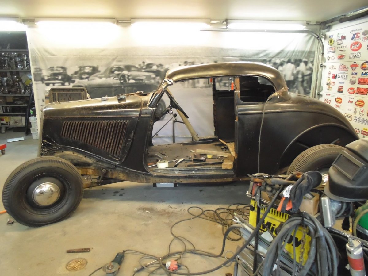

    Yesterday started to chop customers 1934 Ford.

    No bracing on the inside to hold everything square and solid while it gets cut up?

    Thank You Sirs.
    Banner they made here in Seinajoki city Finland. Its light weight and weatherproof too. They said that banner will not be good quality, because start was only small black and white picture in old hot rod book. I do not care if its "unclear",....looks like more old, not too hitech.
    I have bring 2pc banners to CA too. I do not know how much those are there, but for example this one, 2.2m x 5.5m, something like $450.00 for me.
    I had tubes inside before welded back, and cross measurements on paper. You know those old Fords, Originally are diameters are very very big tolerances. And +80years on the road, accidents, rost, damages,....
    Doors not fit, Deck lid not fit,.... Junk junk and junk.
    But all are possible to fix. , just weld, heat, hammer, englishwheel and time.
    This car I only chop top, chop door carnish and push out. Owner can continue what ever he want to do.
    I have bought that car from CA and sold him 2y ago. Good Project to make it hot rod.

    A-pilars 80% ready.
    Rear "letter box" installed.
    -6" top, -4" rear window.
    Aulis

    Cabin is big (huge), if compare my 1932 5w cabin.
    Today I made quarterwindow to driverside. I used pass.side quarter window frame and turned it 90decrees. Of course need to cut it 5pieces, but fits better when cross frames.

    finally both quarter windows welded and rear window too.
    I made pass. side quarter window from drive side window. It was very rost. 6hours to make new rim over it etc.etc.
    next top of the cowl and then doors. last door garnish.
    I need to make new panels front side of door (cowl) and between door and rear inner fender. Owner can change those same time than he looks over all another rost places after sandplasting.

    Yesterday - Today get ready cowl top and pass. side door.
    Dr.side door looks bad. Original door is junk and I have one extra door, but it is very much twisted.
    Lets see tomorrow, how it fits,....
    Very much putty down there. I need to make new panels behind doors. Owner can weld those in his own garage. I want to get car out from my garage next week.
    Aulis
