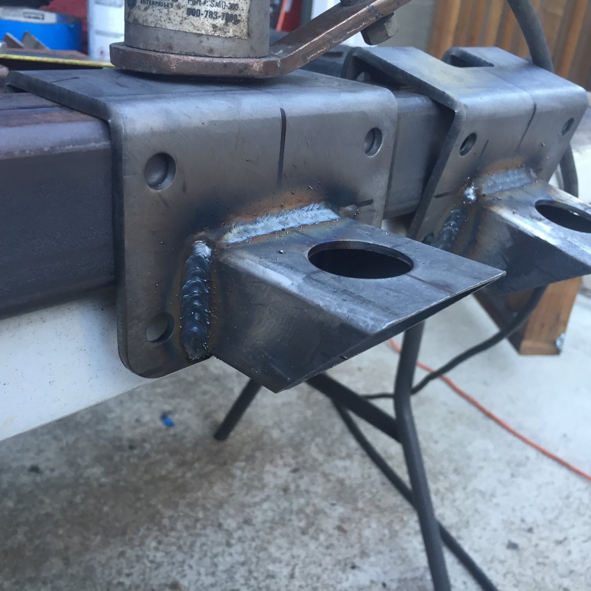

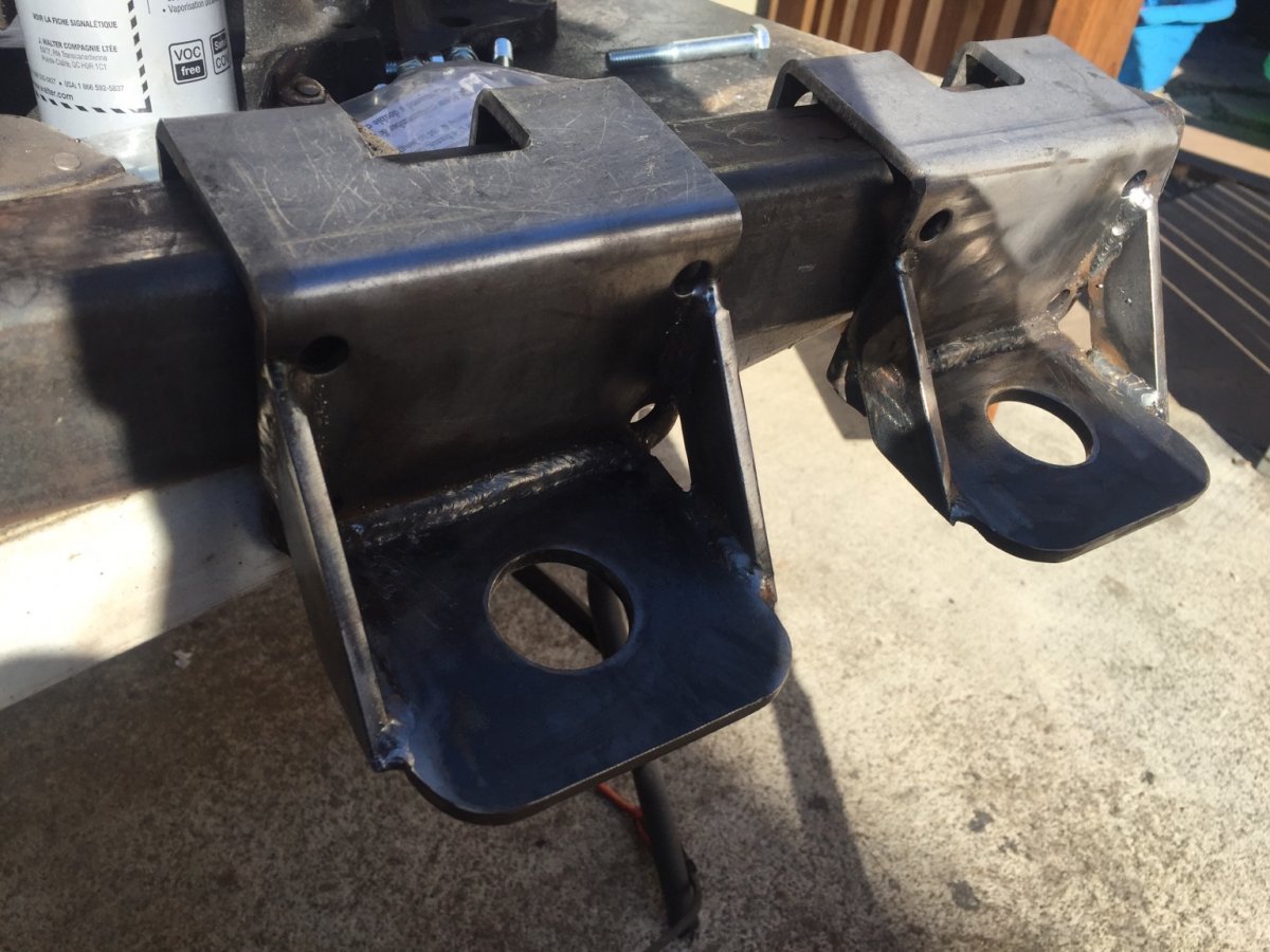

  5. Devin
    Joined: Dec 28, 2004
    Posts: 2,369
    Devin
    from Napa, CA
    These are the mounts currently on the frame. ImageUploadedByH.A.M.B.1470087827.277757.jpg
    These are the ones I just finished. I hope to get them in tonight to see how much they help
  6. A step in the right direction, you do nice work.
    Hnstray likes this.

  9. Devin
    Posts: 2,369
    Devin
    from Napa, CA
    Ok, mostly successful! The new mounts drop the engine anothe 1.5" and you can definitely see the positive benefit of clearance, transmission output shaft angle and a lower center of gravity. I still have about an inch clearance between the oil pan and the crossmember. The oil pan barely makes contact with the steering rack, this can be easily resolved with a little gentle persuasion from a hammer. It's still probably a little higher than it should be and I will see if I can continue to tweak things before anything gets permanently attached. The center of the output shaft is 5.5" above the bottom of the frame rails vs. the 4.75" measured from Flux capacitor. I'd like to get it down a bit more but my angle at the trans is at 4 degrees which is probably pushing it. Since my floor is basically nonexistent, I'll most likely build the driveshaft tunnel to fit. If anyone has suggestions or not iced anything out of whack, please speak up. Thanks for all the support. ImageUploadedByH.A.M.B.1470196088.413563.jpg ImageUploadedByH.A.M.B.1470196105.568517.jpg ImageUploadedByH.A.M.B.1470196127.494074.jpg ImageUploadedByH.A.M.B.1470196144.185625.jpg ImageUploadedByH.A.M.B.1470196159.493247.jpg
