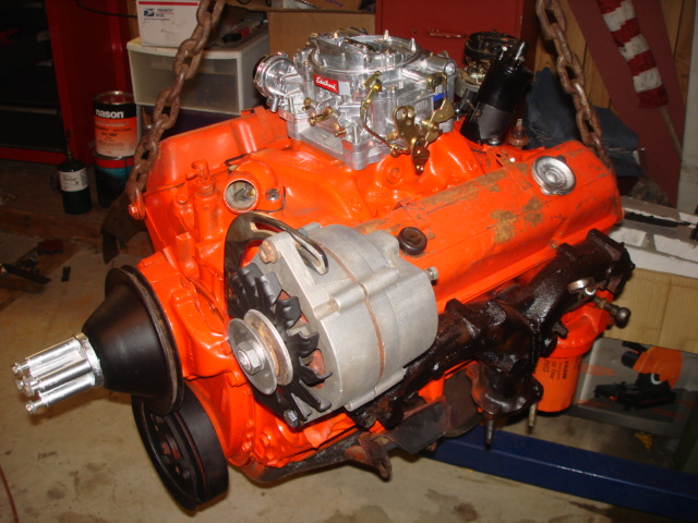

    I just started a Nova project. Here are a couple pics of the beginning. I got the motor running the other day after a little tinkering and it seems to run fine. After re-wiring it and adding a new starter it has started every time and seems to shift well. I wanted to detail the engine compartment and thought the best results will come by just taking the engine out and detailing it in the hoist with a new Eddlebrock carb and some chrome. The trans seems fine, but I plan to convert it to a floor shifter and lose the column shifter. I took out the clutch, pressure plate and through-out bearing and will replace them while it is out. I picked up all the new u-joints, seals, gaskets and paint for the engine today. I de-greased the motor twice and it is inside drying for the paint and face lift.
