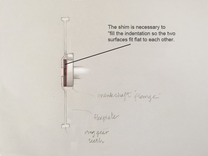

    If you run and automatic, the flexplate attachment is a little different on the 348/409. The flange on the end of the crank is larger on these engines so a shim is needed to make the correct fitment. Company called Sho-Cars sells the shims or they also sell a direct fit flexplate. The pic below is from the 348/409 forum.
    Pic is property of owner
