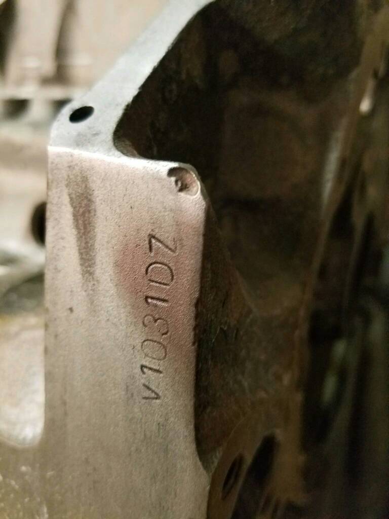

    post a picture of the stamp, we'll get an idea of what it might be.
    But taking it all apart will also help you figure it out
    els and Deuces like this.

    2-bolt main and DZ code sounds like a scam. Need to post pics of the pad stamping so we can see the lettering type/style and size. Should also be a longer string than just "1031DZ", there is a letter missing from the front of the string.
  23. there are ways, common mistakes are wrong font or odd spacing or wrong placement on the pad. Best thing is to take pics and talk to the Camaro restorers group. They see so many stampings, they can easily tell a real from a fake.

  28. Looking at that stamp, to me, that is a total fake stamping. The D and V looks wrong and the 1 after the V is totally wrong, I have only seen 0 or "I" on confirmed pads
    Here is a forum on TeamCamaro ( one of the leading forums for original Camaro's) on real DZ stamps. https://www.camaros.net/forums/15-tag-team/318642-legit-302-engine-stamping.html

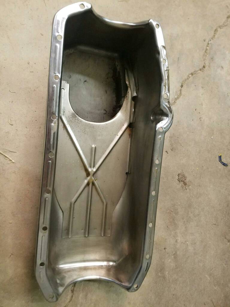

    The waffle pattern on that piston gives it away as a cast aluminum piston, not a forging as was used in all Z28 engines.
    Also the pan is not correct, at least in my experience. A Z28 pan has a short baffle that projects up from the sump at an angle to prevent oil slosh on hard braking. It will also have long sheet metal rails that interface with the baffle on the main cap bolts. I’m pretty certain your pan might not clear those main bolts with the integral studs for the baffle without some careful massaging.
    Somehow the DZ characters look like they were done using a “0” and an “I” for the D and a “7” with a tail added , maybe from a partial “0”. That’s what I see, but I am no expert at GM stampings.
