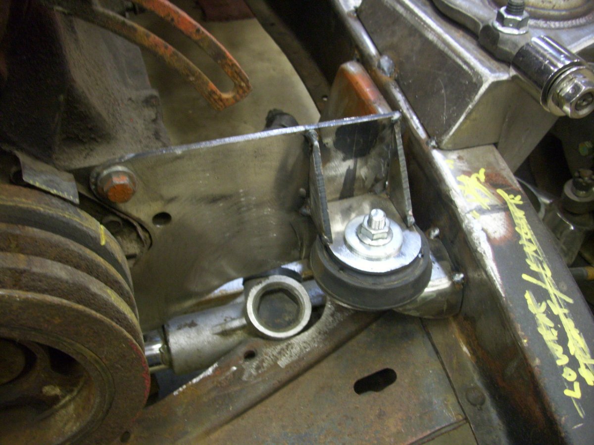

  19. GearheadsQCE
    Joined: Mar 23, 2011
    Posts: 3,670
    GearheadsQCE
    Alliance Vendor
    To avoid the side motor mount issue, I did this.
    This is on a '37 but the '56 has the original 6 cylinder mounting holes. I think this might be a good option for the OP.
    lothiandon1940 likes this.

  24. GearheadsQCE
    Posts: 3,670
    GearheadsQCE
    Alliance Vendor
    Yep, I used a motor plate like a race car. The OP could likely use the original bell housing mounts from the '56.
