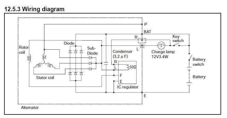

    I'm looking to convert my truck a 53 chevy 3100 from generator to alternator. I got a Hitachi alternator in my shed that i would like to see if i can use it. The alternator fits perfect with original strap bracket from the generator. I have a good idea how to hook it up from research just my situation is different since im not sure what the output S, L, E, BATT mean. How do i wire it? Thanks in advance.

    If I were to guess, I would say that S is sense, L is idiot lamp, E is excitation, and BATT is battree. But those are just guesses.
    Google the Hitachi alternator using the model no. and go from there.

    If the hitachi has an internal regulator, then you can probably make it work once you figure out the wiring (hint: use google images to search for hitachi alternator wiring diagrams). If it requires an external regulator, you'd probably bet better off just going to a GM alternator now.

    Need to know if it has a round 3 wire plug or 2 wire that looks like l l or T.

    Looks like an L shape and has S L on the sides of each output. It is internally regulated.

    google sez....
    Probably just adds more confusion...which is why I suggest the GM alternator. At least we understand it.
