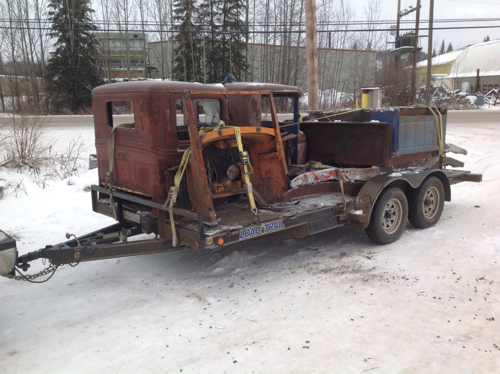

    So here it is. My super cheap build thread. Given that I have not much time, two kids and a wife in nursing school building a hot rod is probably not the best use of my time or money but who cares it is fun! I bought a friends stash of 32-33-34 truck stuff. Picked it up at Christmas time and dragged it home. After cherryicking what I got I sold off enough stuff to make what I had kept free!

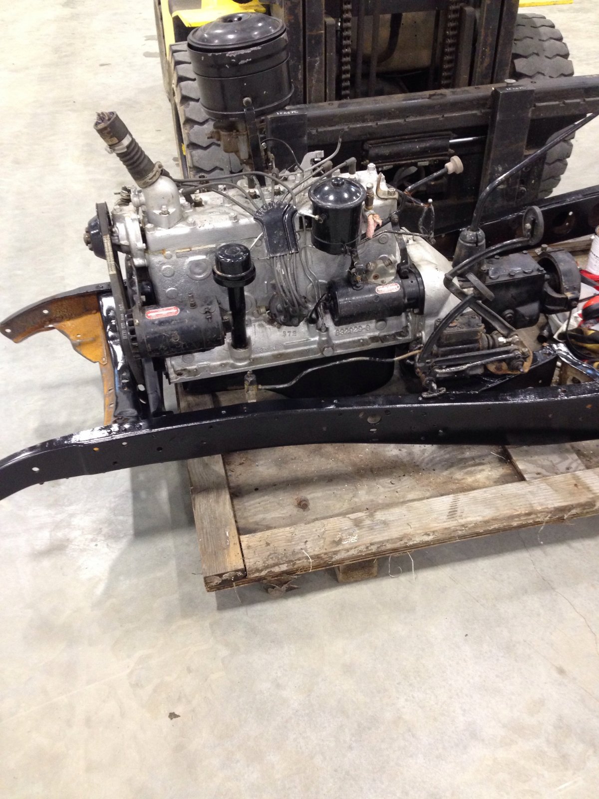

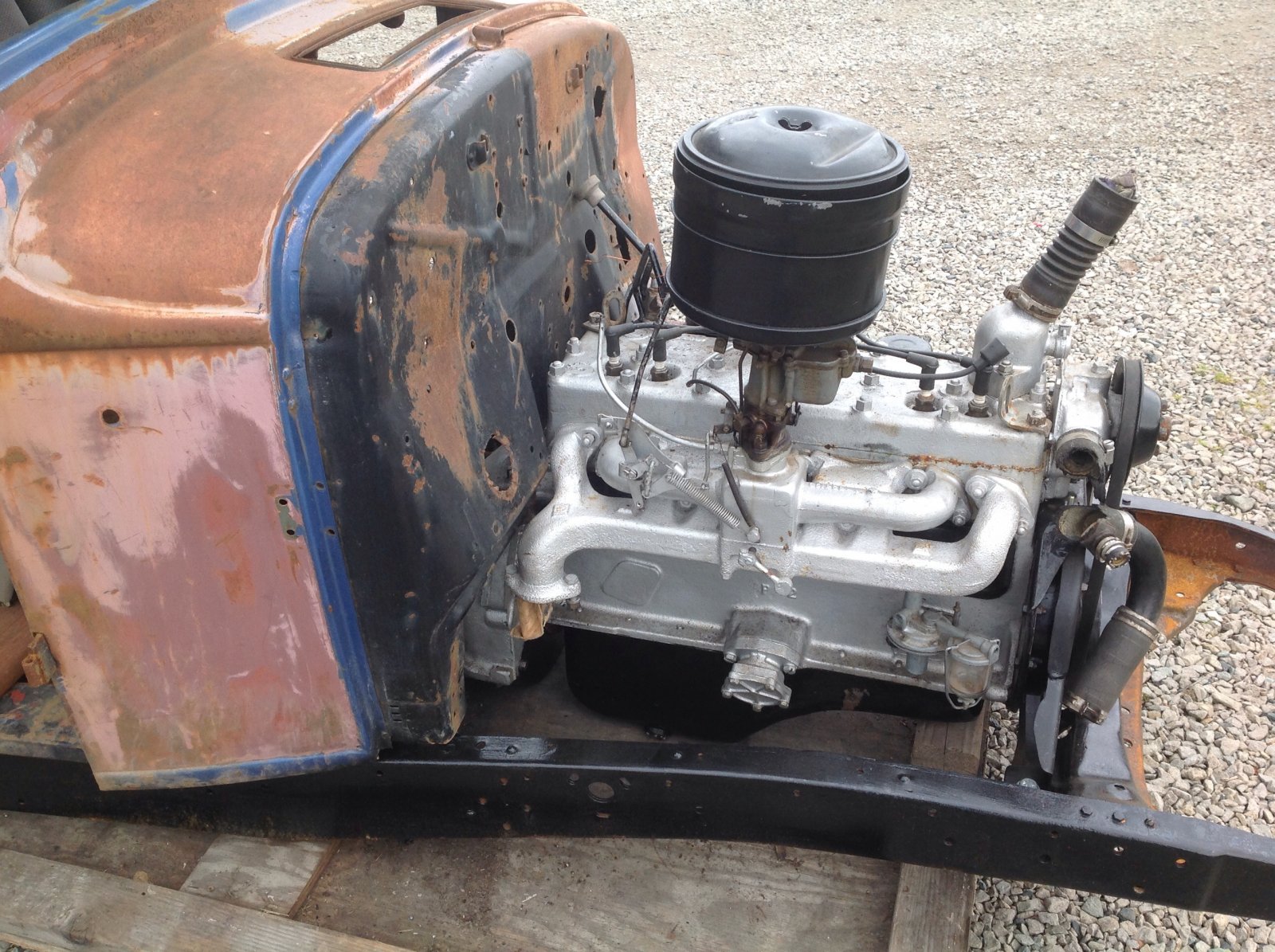

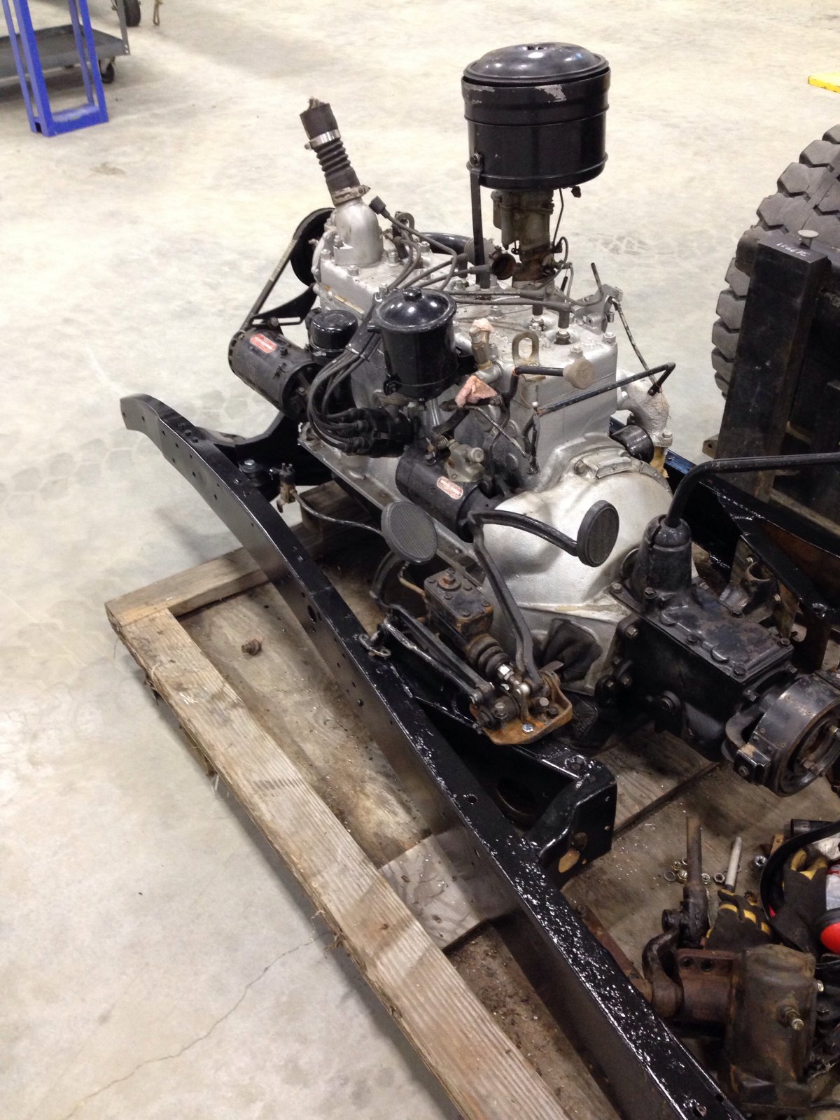

    Then I mounted up a Plymouth 201 flat six and assorted parts I have been holding for years. It actually bolts up to the Ford mounts in the front. But it needed to go up quite a bit so I cut two motor mounts in half and welded one on top of the other. image.jpg

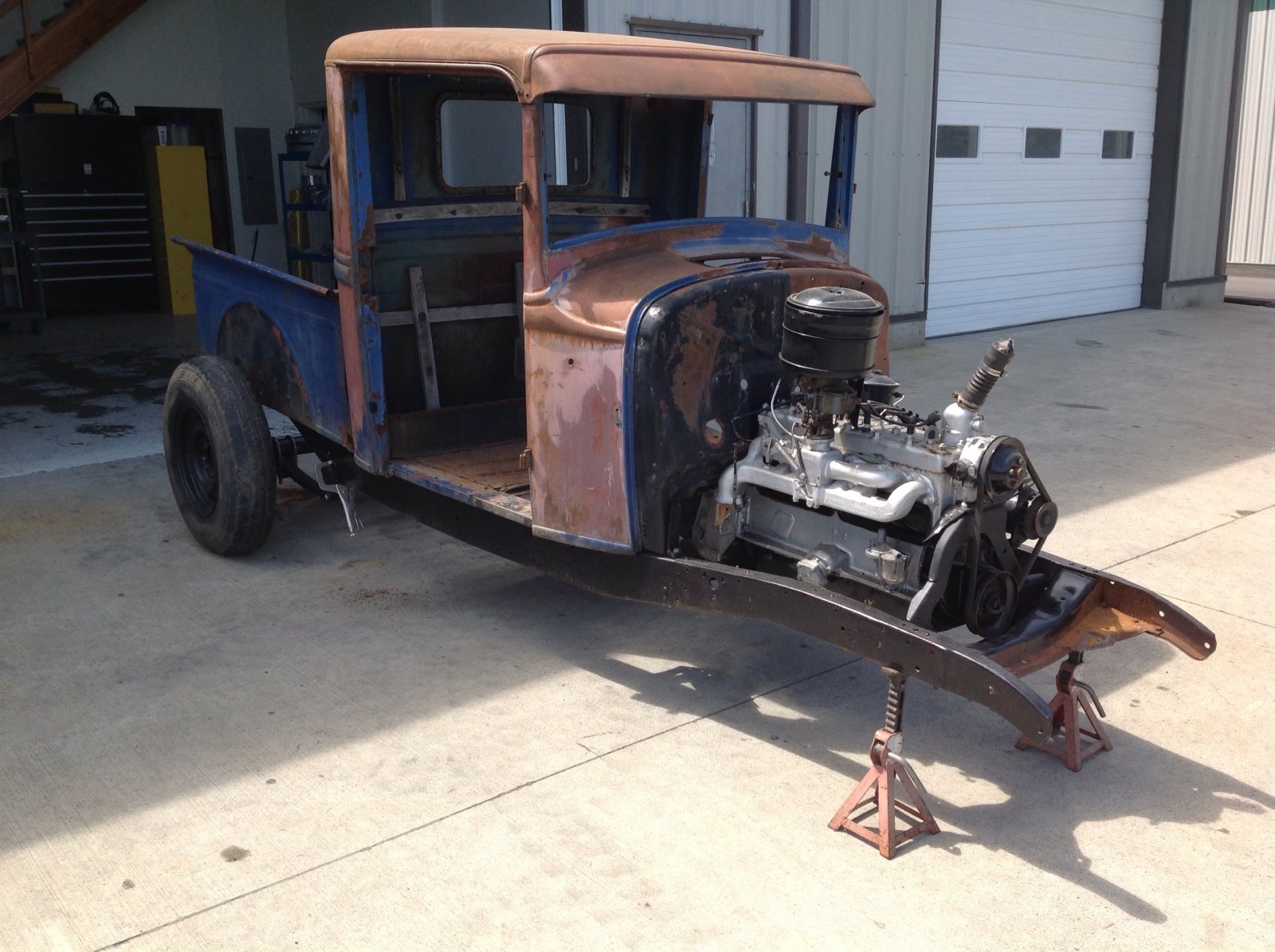

    At that point I stuck the cab on a built some new wood mounts for it. The cab just clears the back of the engine. The cab needs to go up just a touch to square up the door openings and that will give me just enough room to fit the stock throttle linkage and spoon pedal.

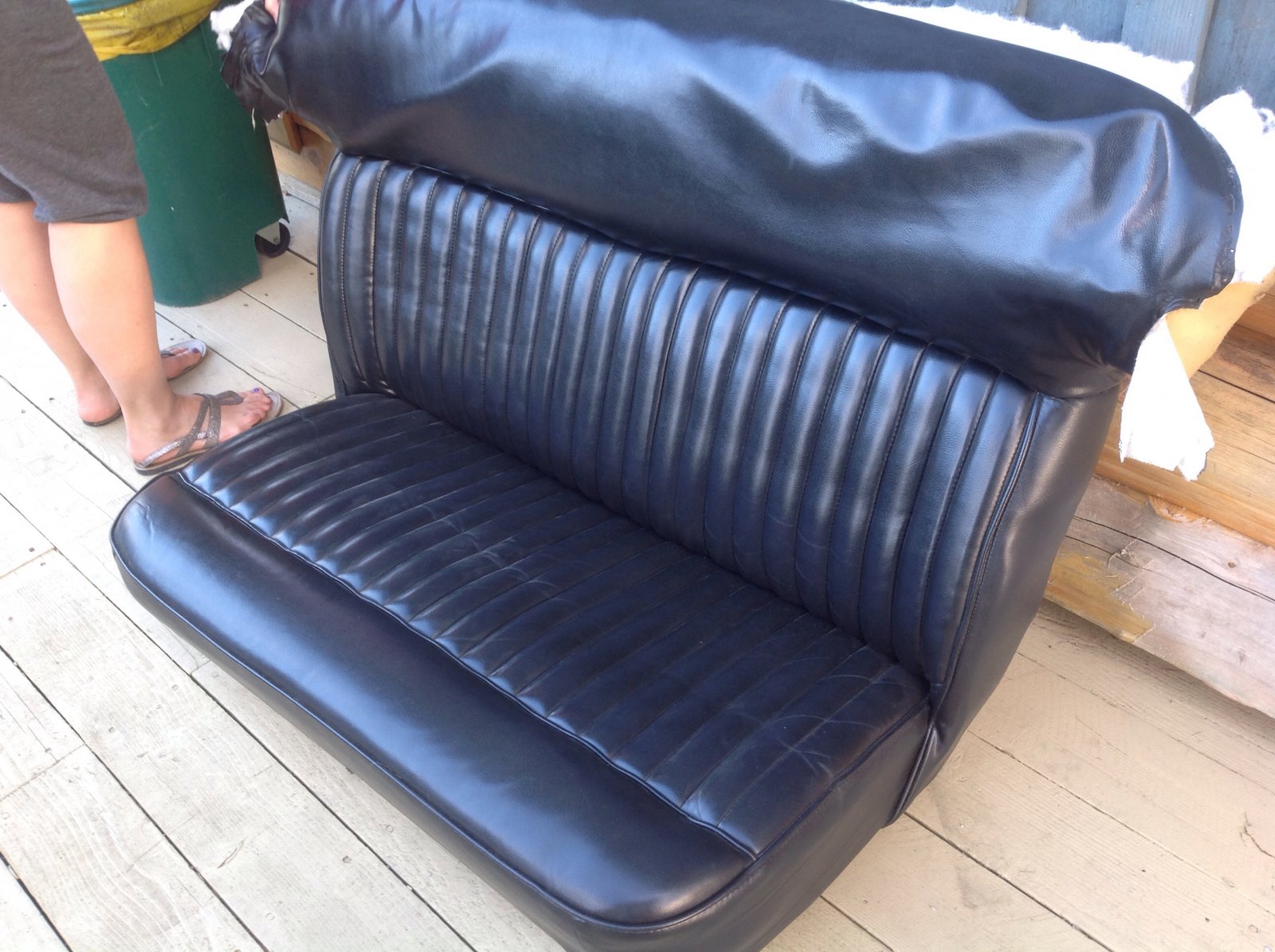

    A friend got it for me. For free! A local guy is redoing the interior of his A roadster and was giving it away to whoever wanted it. Needs a couple of hundred dollars worth of work on the top but I have to wait till the shops are done fixing boat tops.

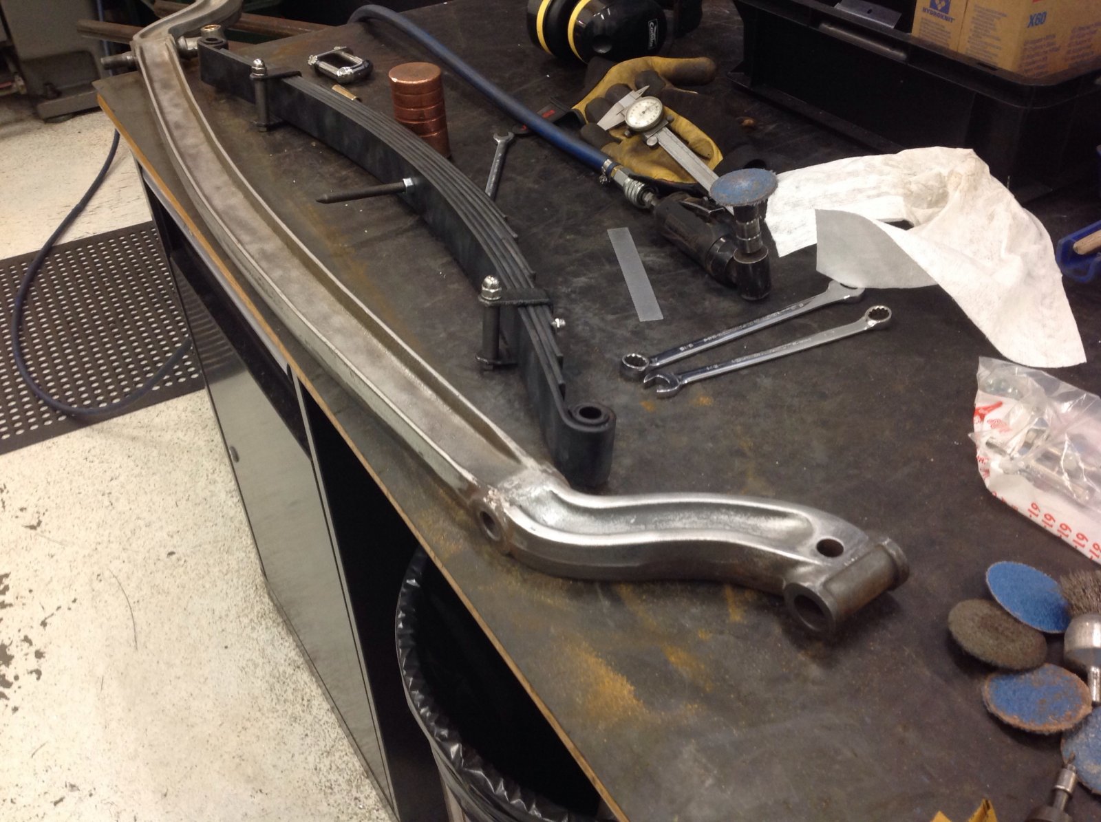

    A friend and I dropped the front axle. 2" and I got to work blasting and cleaning everything and building some ends for the wishbone mounts. I reverse eyed the spring and set it up with seven leaves. image.jpg

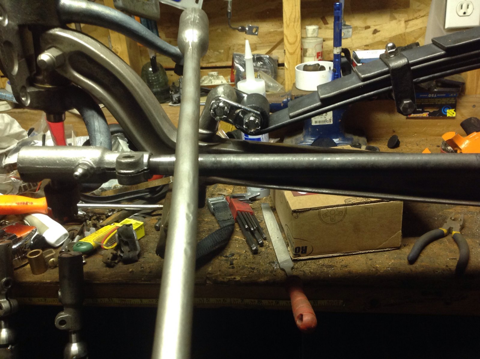

    I built a new tie rod out of some 4101 HTSR and bent the arms down to clear the axle.

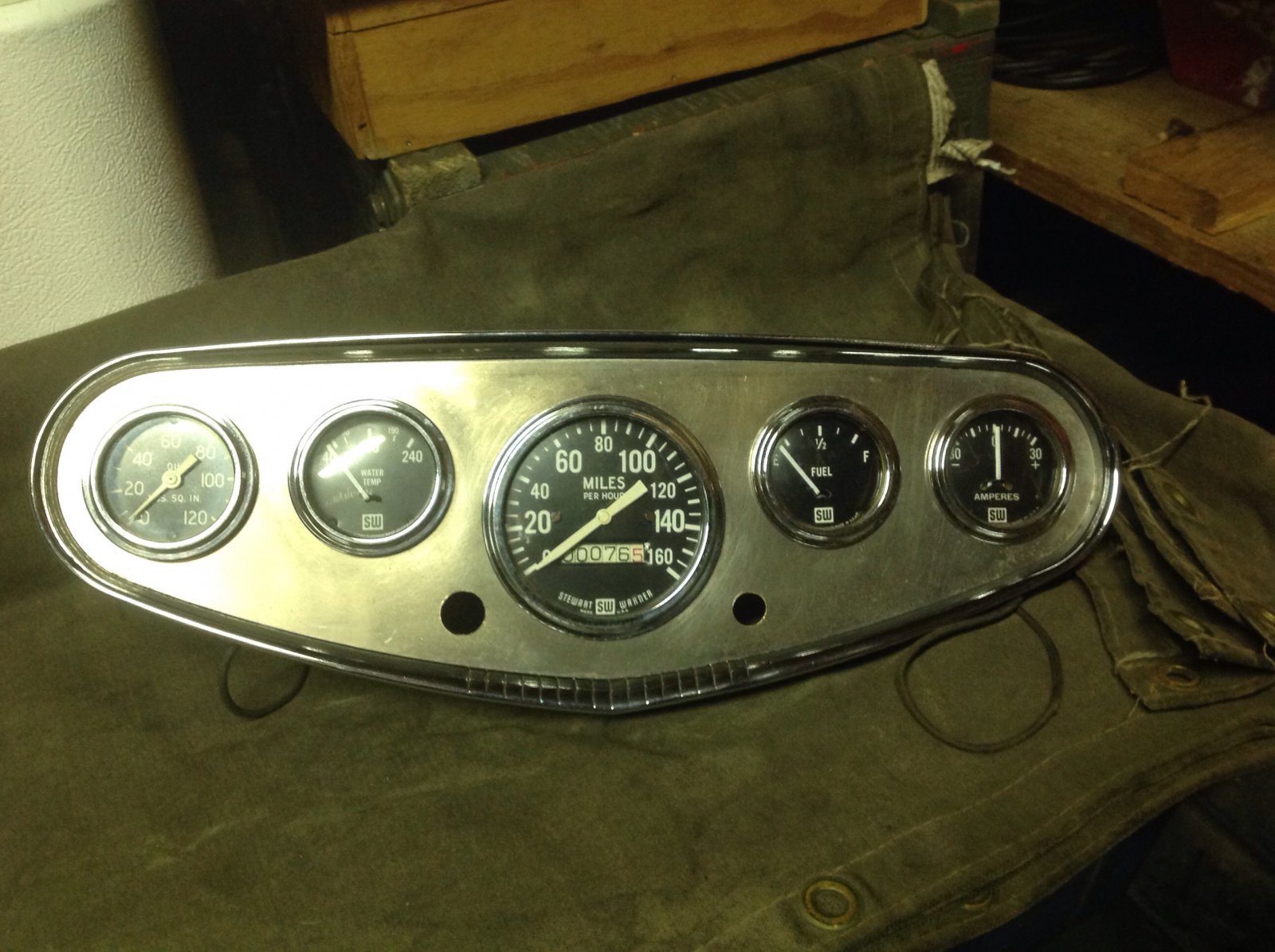

    Picked up some 1954 date code curved lense gauges for cheap of the buy and sell. They are out of an Essex coupe that was never finished. 76 miles total use age. And the panel I got at a boat swap years ago for $20 image.jpg

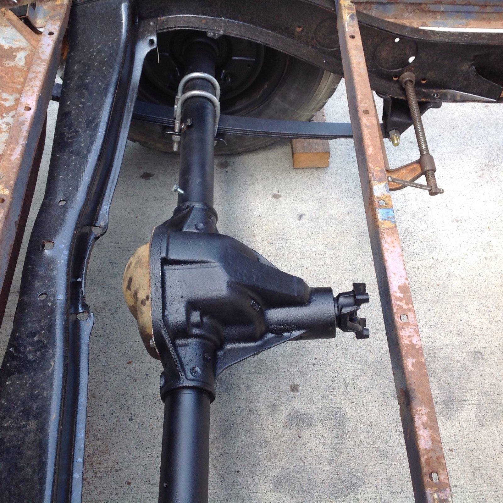

    image.jpg I have been working on the rear suspension. F100 front suspension parts. Split the packs down to three leaves and fixed the mounts and shackles. Then I rebuilt a 55 F100 Dana 44. I got it and all the front brakes from a friend for free. He is going independent and air ride. I rebuilt the diff this weekend and swapped in a set of gears out of a 77 jeep wagoner axle. Nice that 55,77,85, and stuff from my 2005 jeep all fit this axle. Chrome cover is cheap and will get some acorn nuts to hold it all on.

    I got the rear stuck in today and it needs different mounts. I may reverse eye the spring as well. It sits way too high. But it is coming along. image.jpg
