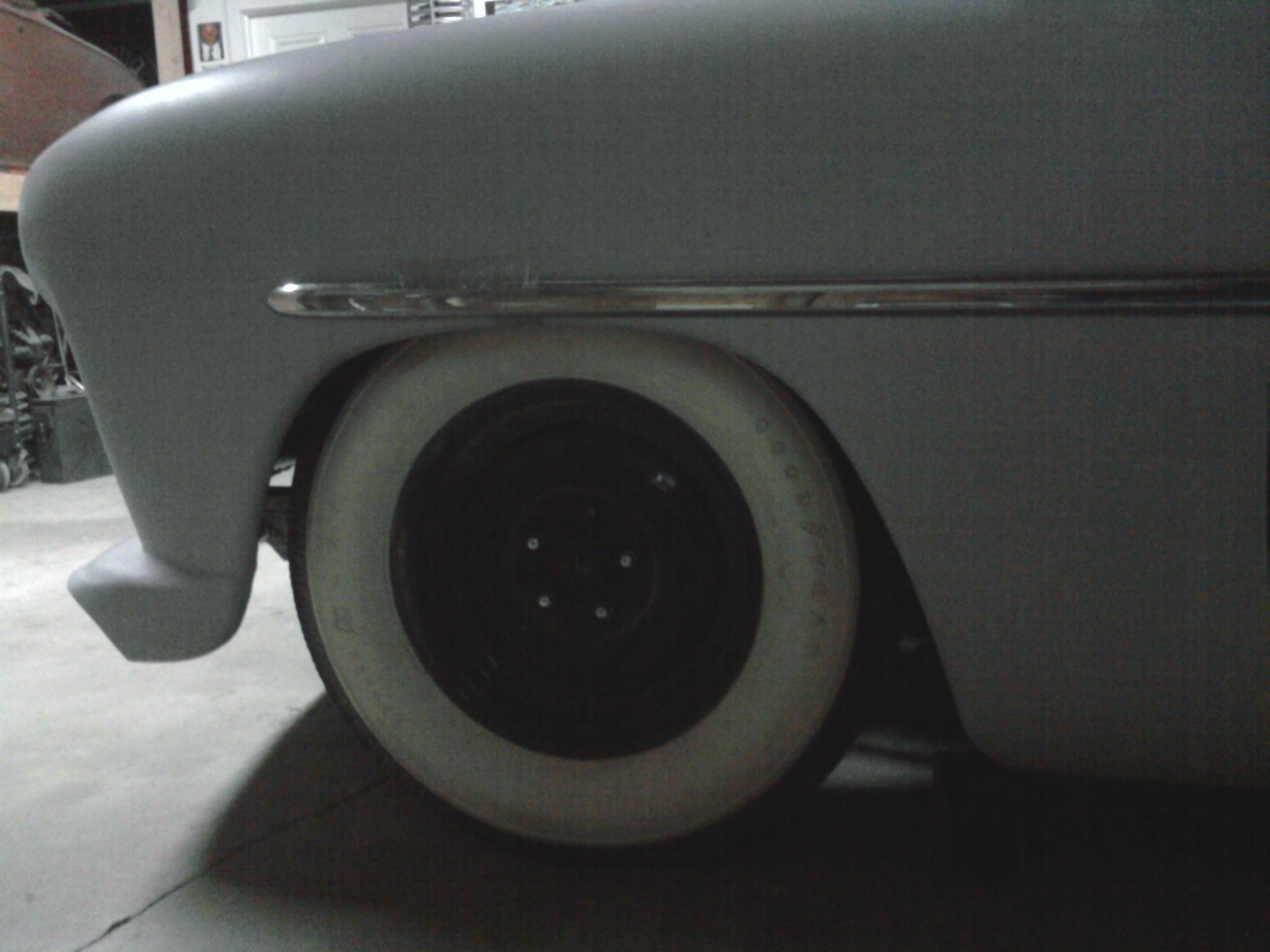

    HI Guys, I just installed the aerostar coils in my '50 Ford today- used the Duralast '92 Ford Aerostar 2w drive front coils (pair) and I have Jamco dropped spindles that have been on the car for about 10 years.
    Once I took if off the jackstands, I noticed it was lower on the driver side- and it is about 1.5" lower. I checked the coils and both are indexed around the ring inside the frame and in the right spot on the lower A arm plate with the end of the coil in the little trough...my frame is square...
    I thought maybe the shocks would make a difference, so I installed the Monte Carlo shocks as mentioned in this thread and that didn't change anything either...
    Had anyone else had any problems with their car coming out lopsided? Did I get a bum pair of coils, and if so, how can I check them?

    1.5 inches is a lot, either the top seal didnt set right, or the bottom spring is not in the groove. Both problems would be on the high side of the car. The way the coil springs are made makes it difficult for there to be any errors. Try driving it around a little bit and see if it doesnt seat better.
    Clarification - You can always just look at the spring and compare it to how the other side seats in both top/bottom. Also driving it around will only put movement on the spring, it is not likely to come out or break anything, BUT, this is done with the assumption that it is only not seated properly. Make sure all of the bolts and everything else are properly in place. Sometime swe say something assuming the obvious has been done, so do all the obvious before taking my advice. If still in doubt, buy another spring, take the high side off and return it.

    I think you're on to something, but I wouldn't drive it around to get it to settle. Take it apart and fix it first man. Do you have any pictures?

    I'll post some pics.
    Everything is seated and in the right place, however- I didn't use the rubber things on top of the coils. I will get some on Tuesday and try again. I will also try and swap each coil side to side and see if that changes things.
    Also, I think these Aerostar coils just might be a little too low when combined with dropped spindles...so I may just ditch this set-up altogether.

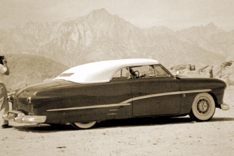

    Here are some pics of the way it sits after putting the springs in last night, and a picture of the Chuck DeWitt Ford, which is exactly how I want mine to sit- a nice, traditional and not-slammed stance. If anyone in SoCal has a pair of good condition, original (unsaggy/uncut) stock '50 Ford front coils springs, I am willing to trade them for the pair of brand-new aerostar coils...PM me if so :)

    Great tip. You should post this info on ProStockJohn's Merc parts thread.
    Great pix also. I have a California 50 Merc and they use that lowering block on the lower A arm. I was wondering what old school feature was used to lower the front suspension. Now I know!
