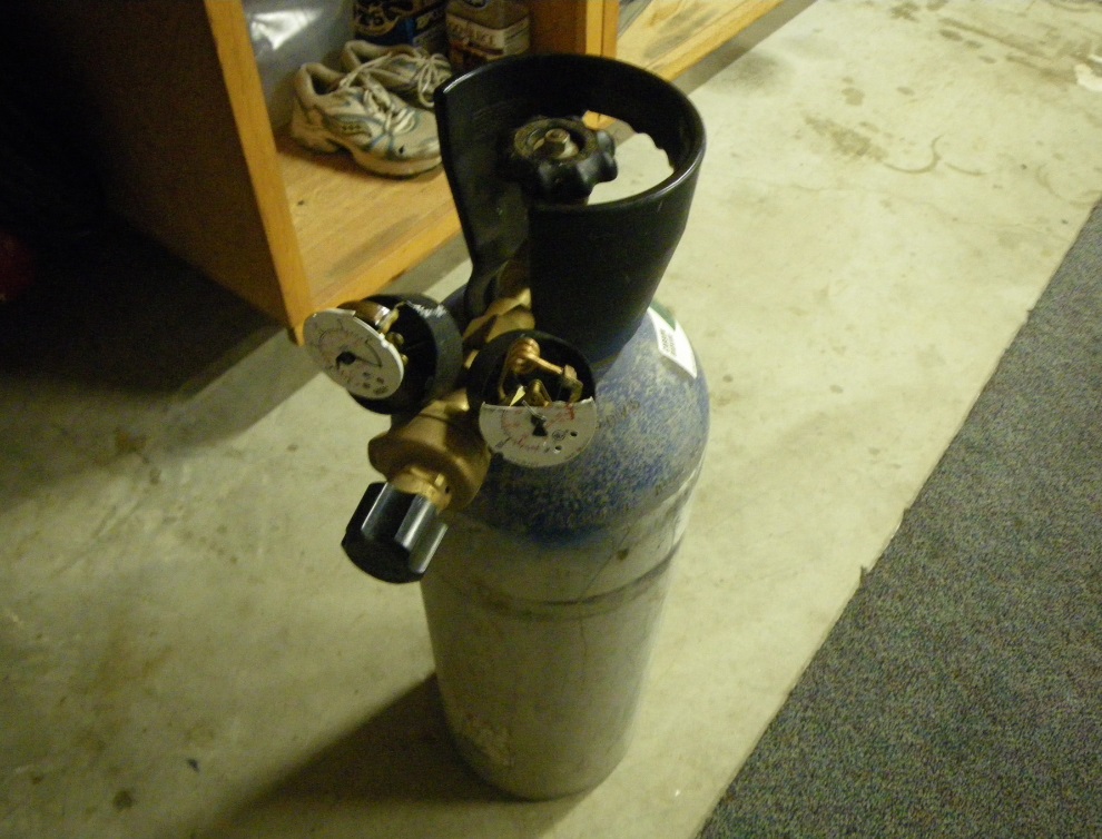

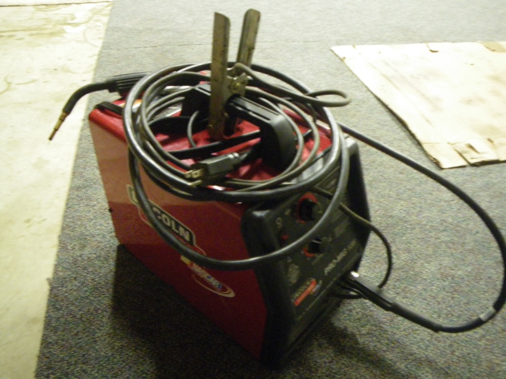

    Here are some photos of the welder and the bottle I bought for $240. Supposedly I need some new gauges but probably not a regulator (according to the person I bought the welder from.)

    Good buy on the Lincoln! Great start for a good tool collection. Don't sell it when you're done with the Chevy, it'll come in handy years down the road for other sheetmetal needs. Later on you can pick up a quality 220v MIG for heavier work. As mentioned, get the HF 4-1/2" grinder and I'll probably get reamed for this but the $40 (on sale) HF auto darkening helmet has been all I used for the last few years and it works fine. I can still see! Start saving your pennies now for a decent air compressor. A 4hp/20gal is good for filling tires and not much else. A home shop needs a minimum 5hp/60gal to run air tools and of course bigger is always better!

    With your same setup I had a Lincoln SP110 and it was weak on the 15a circuit ... big difference on a 20amp circuit, would burn through hot mill scale with no problem

    I know a lot of guys who did good work with a 110 Lincoln. the gas makes it much better.
