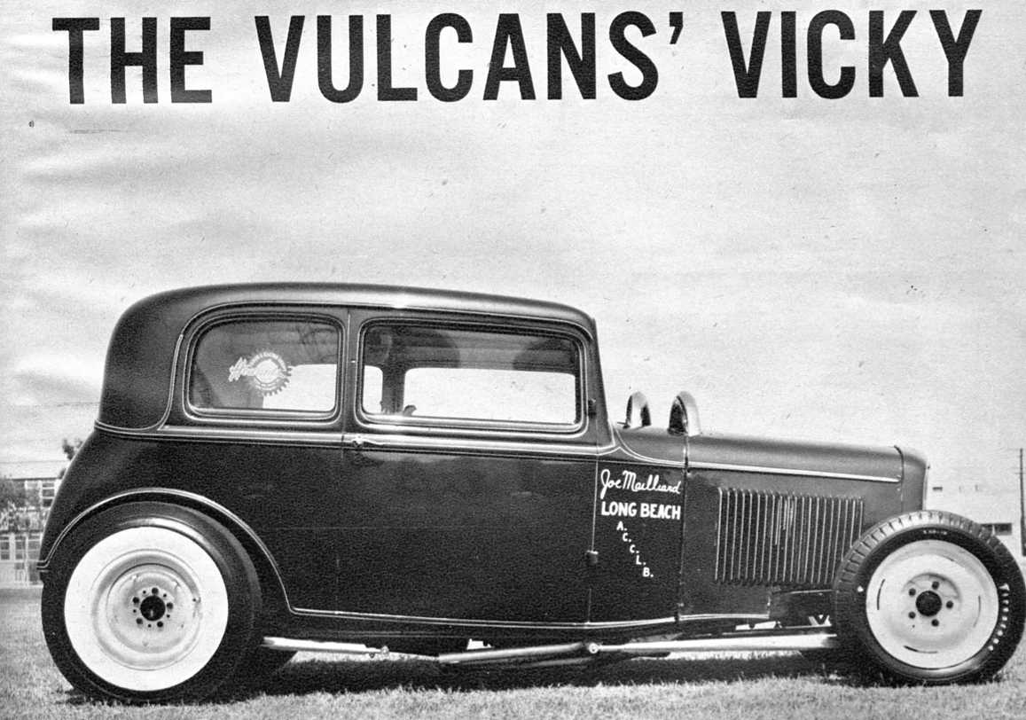

    I agree completely. As much as I love the Vulcans Vicky, I've always been surprised that they left the frame horns and didn't pinch. I just can't hack a big notch outa my sides.

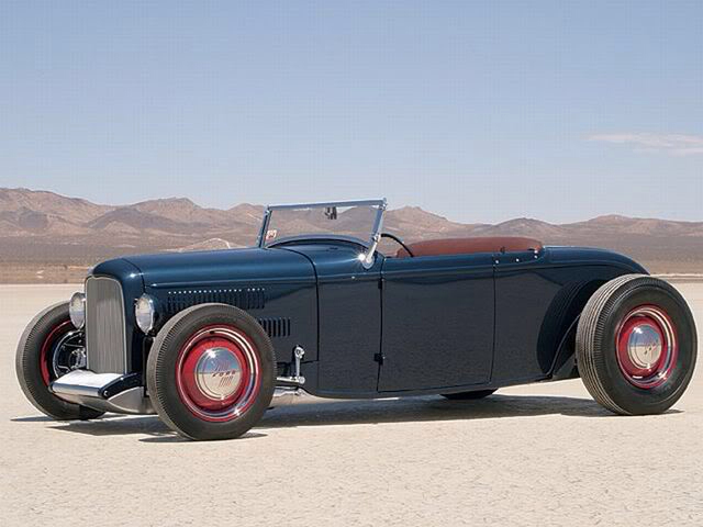

    The notched side panels on the green roadster look pretty good, I like the way the trailing edge drops down.

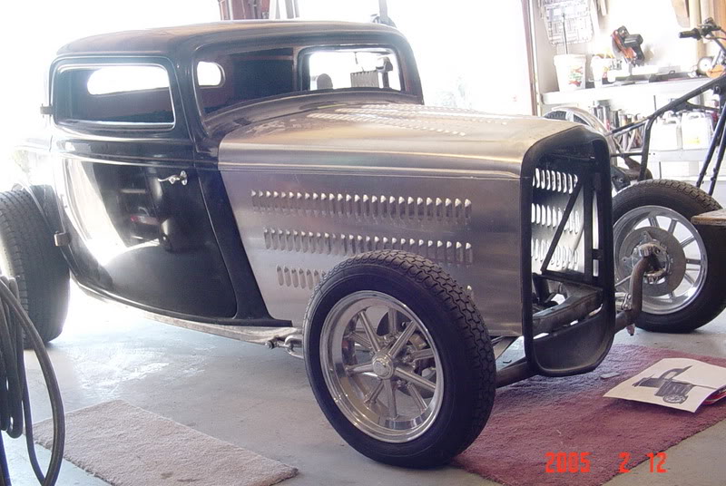

    10cb6bc3.jpg Channeled deuce.jpg IMG_3144_zpsb6161626.jpg Channeled deuce.jpg I am in the same boat as you are, but my coupe only has a mild 2 1/2 inch channel.
    I did the card board side panel mock up on my coupe and if you round the notch for the frame and let it swoop back it looks pretty good.
    My plan is to make a custom 3 piece aluminum hood for my car since it is channeled and the front crossmember it moved an inch forward ( stock hood won't fit lenght wise either).

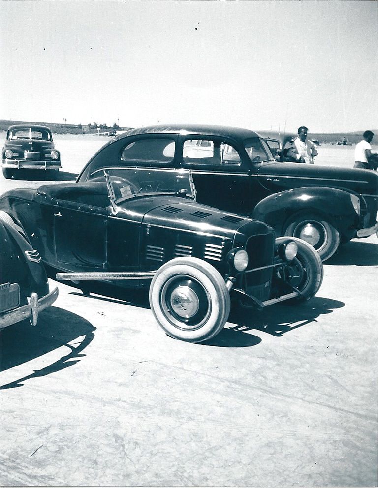

    Leeroy Hansen's Deuce, 1948;
    Sheehan's 33-4 circa 1957;
    Runnin shine and kidcampbell71 like this.

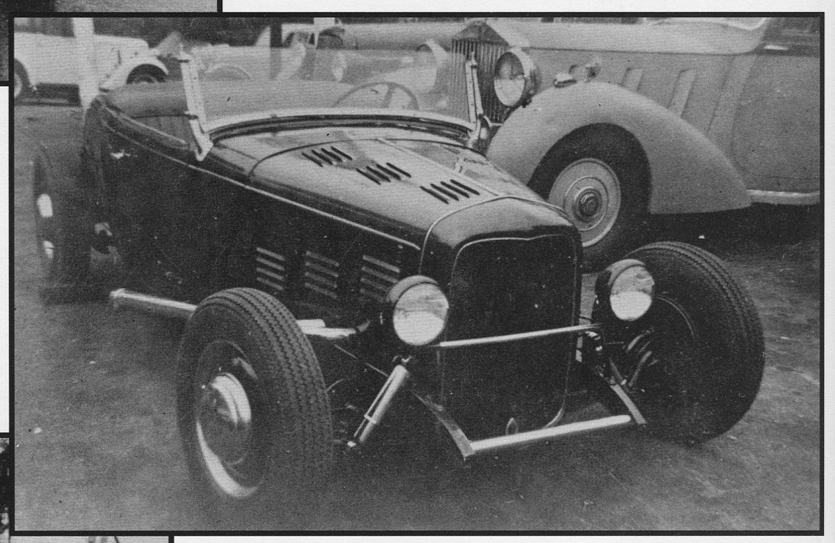

  17. Bart78
    Joined: May 11, 2011
    Posts: 717
    Bart78
    kidcampbell71 and sko_ford like this.
  18. birdog
    Joined: Nov 25, 2010
    Posts: 383
    birdog
    A couple more there were a ton in the forties! I personally love the look!
    kidcampbell71 likes this.

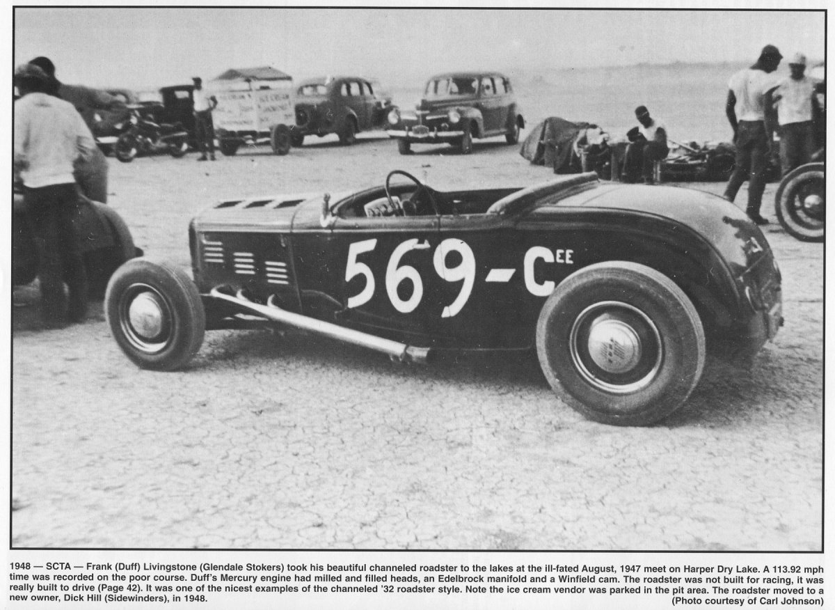

  25. Duffy Livingstone's roadster is one of my favorite cars ever. Looks like original tops with custom sides
    kidcampbell71 and Runnin shine like this.
