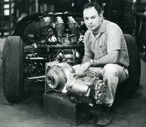

    55willys you can get an aluminum case for the 833 from the factory. They had problems with the hole for the countershaft opening up but I seem to remember something about boring out the hole and fitting maybe it was a steel bushing.

    That's pretty cool looking. It's mounted upside down and offset because the shaft center of the T10 is 3.03" center to center and doesn't line up with the quick change shafts that are 3.0" on the V8 quick change and 3.5" on the Championship quick change.
